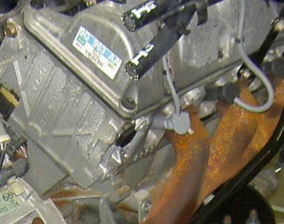

HI, sorry to bring this one up yet again, but I am a bit confused over one point. I am lucky enough to have a vehicle on which a previous owner had the timing chains, guides etc. replaced with the newer versions. This was done about three years ago (25,000 miles back). However, I now have a brief, but quite noisy rattle for fractions of a second on start up. There are no other symptoms while running, nor does the rattle last for more than a very brief period. At the time the work was done, a restrictor pencil type thingy was not put in the oilway, so I have just done this myself. Results are dissapointing - sometimes I can leave the vehicle for five or six hours and I get a perfectly quiet start - other times it will rattle if left for only half an hour or so. In all cases if I leave it overnight I get a morning rattle. After all that, I will get to my point of posting - I see that there is a later front timing chain tensioner (a cylindrical bit sticks up above the hexagonal head, whereas mine is flush). Would this make any difference if I fitted one of these? In theory, I can't see why I get a rattle now, as the restrictor 'pencil' should in fact hold oil in the passageway - is there any other way oil can drain back when the engine is switched off?
Out of interest, I replaced the upper and lower manifold gaskets when putting the restrictor in - highly recommended - it made a very great difference in performance and idling. Must admit, the original gaskets were in a bad state, though.
