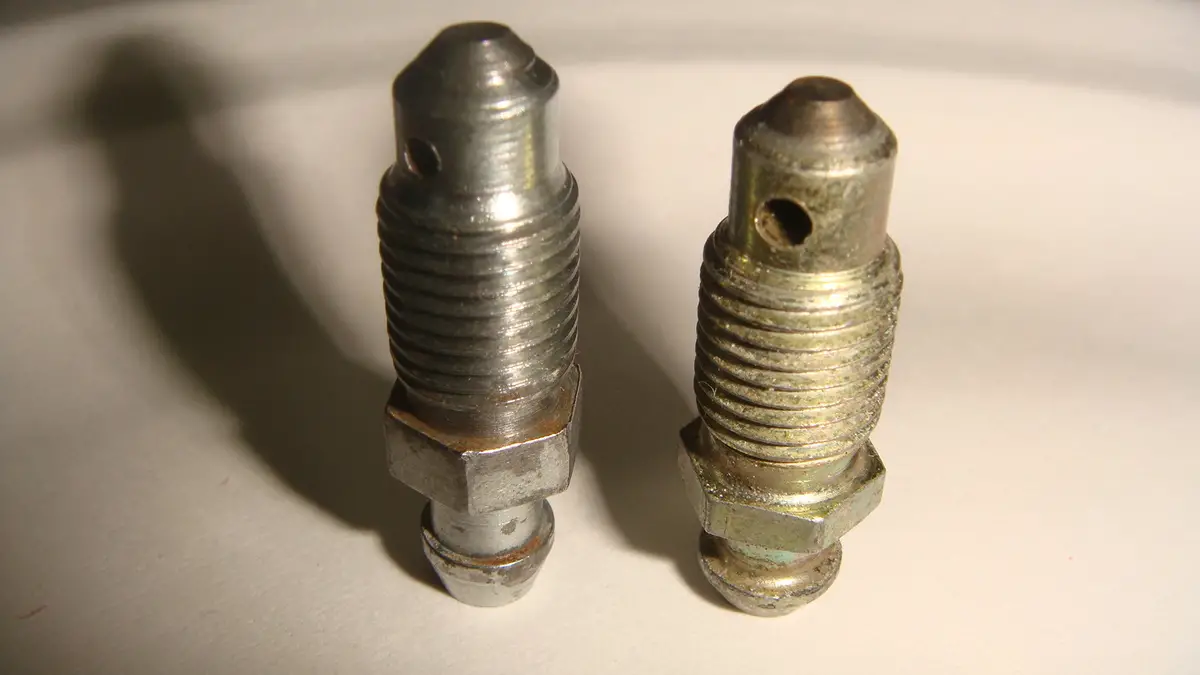

I thought maybe there was just some crud preventing the screws from going all the way in, so I pulled each screw and cleaned. The screws both showed signs of wear:
You can kind of see the ring worn into the tapered end.

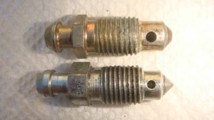

I'm wondering if new bleed screws will fix the slight leak and also stop the tiny bubbles I was seeing when bleeding earlier this week. The Dorman 12701 speed bleeders are in stock at my local AutoZone -- anyone try those before?

I'd replace the bleeder
I've never had success with anything made by Dorman but thought I'd give their Speed Bleeders a try since they were somewhat inexpensive and locally stocked. Issue I had were the OE tips were flat and the Dorman were pointed. I was concerned the Dorman would bottom out so I took a chance and flattened the tips with a file. Sealed OK but don't believe the Dorman are as strong as the OE bleeders. If I didn't modify them I would have returned and gone with Russell's or Earl's speed bleeders. Russell's are also pointed where Earl's are a completely different design. Speed Bleeders also tend to suck air around the threads when the sealant wears off.

As I understand it, the pointed tip shouldn't matter:
I bought the Dorman bleed screws anyhow. Installed them, bled both front calipers, and tightened them down. Dried everything I could and so far there's no brake fluid seepage in the past few hours.
