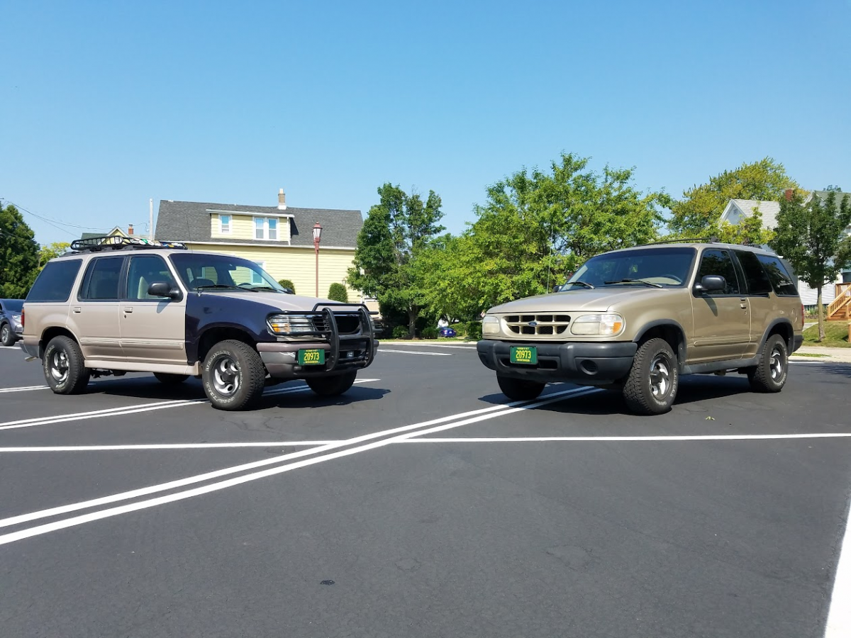

Introduction of the Sandboxes.
After a good teardown and cleaning, I began grafting all the good parts from my '97 onto the Sport. The whole rear end moved over, replacing the 3.27 open 8.8 and mono leaves with a 3.73 L/S and multi-leaf packs. I also installed poly bushings.

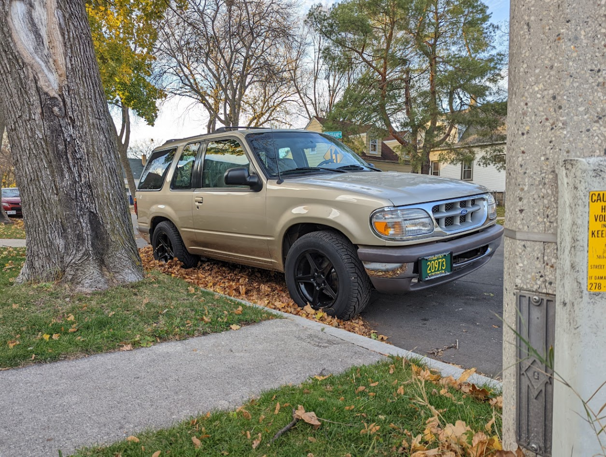

At this point I decided it would be fun to build the '00 as a sort of tribute to the '97, swapping over as many parts as feasible, but also building the Sport into everything the XLT never could be. I swapped in a lot of nice interior parts and decided to make the '00 look like a '97 by swapping grilles, bumpers, tail lights, and tailgates.

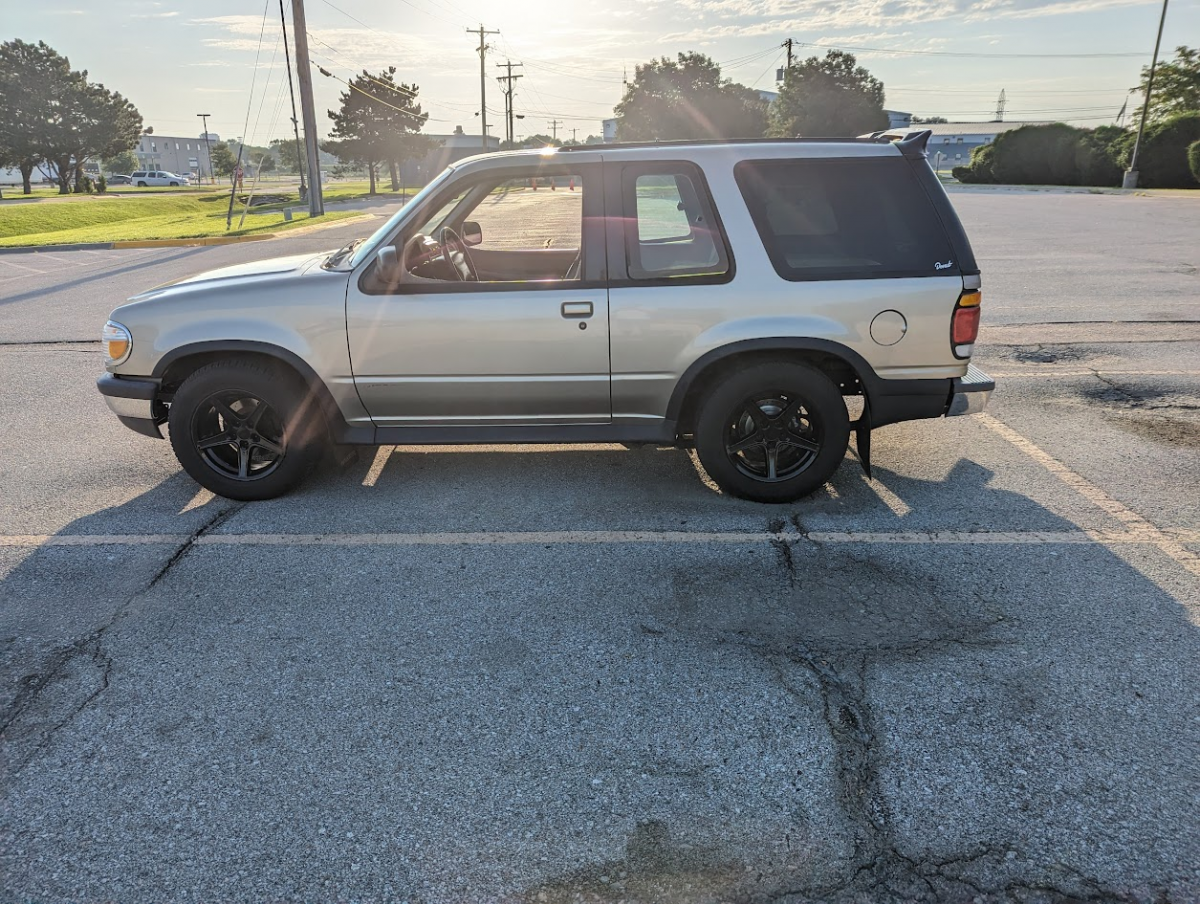

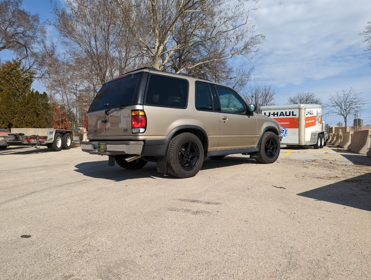

After continuing to drive the Sport for a few months with no catastrophic failure, I decided I would keep limping along the 4.0 and forge ahead with a suspension overhaul in fall of 2022. You can read the full build thread here, or just read highlights below:
  • Coilover conversion
  • Addco swaybars
  • Energy Suspension poly bushings everywhere and Daystar poly body mounts
  • '01 Sport spindle swap for 12" rotors
  • Belltech lowering blocks
  • 17x9 Saleen knockoffs with 275/55R17 tires
  • Lots of other little stuff along the way

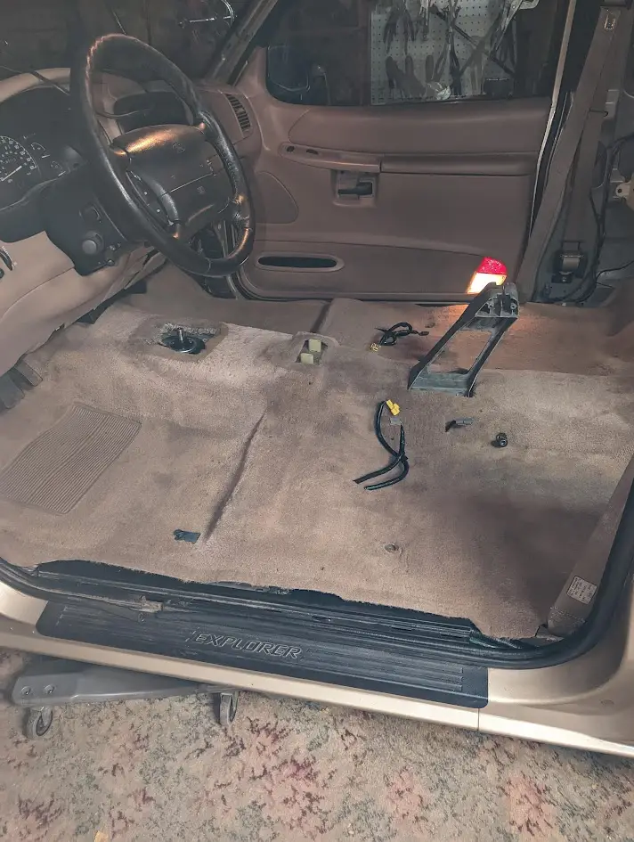

I finally reinstalled the full interior for the first time since the initial teardown:
And I even made my own version of a two-door leather passenger seat because I couldn't find one.

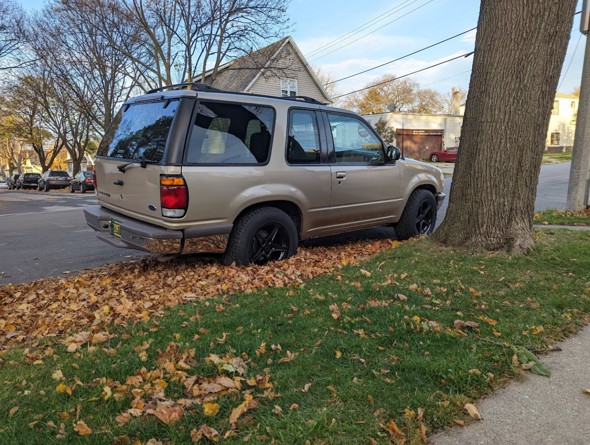

I reinstalled the black side trim and added some period-correct mud flaps:

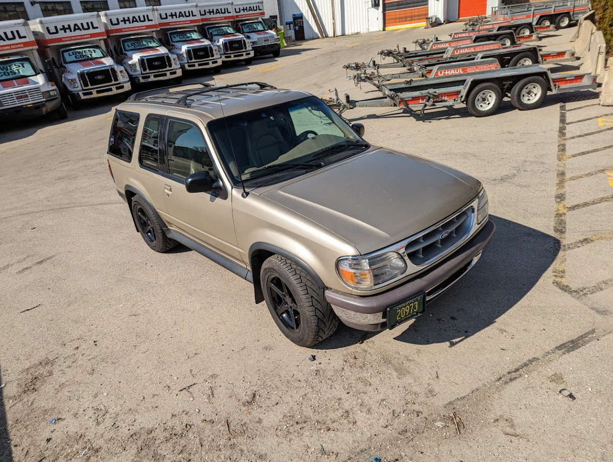

In spring of 2023, my wife and I decided to say goodbye to city life and left Milwaukee for rural Nebraska (to be near family -- I promise there's nothing interesting in rural Nebraska). I pulled the Sport the whole way on a dolly behind a 26' U-Haul.

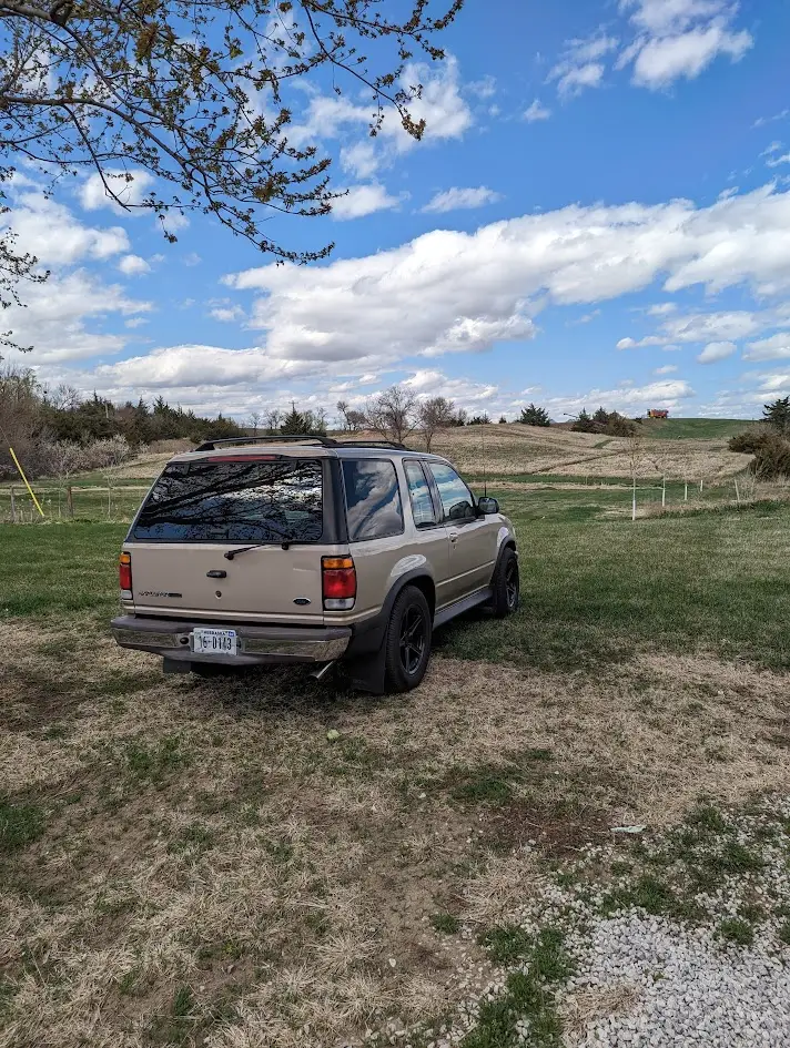

The Sandbox2.000 adjusted to farm life pretty well.

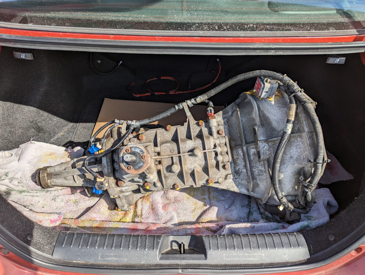

Oh and I picked up an M5R2 as well for eventual 5.0 swapping.

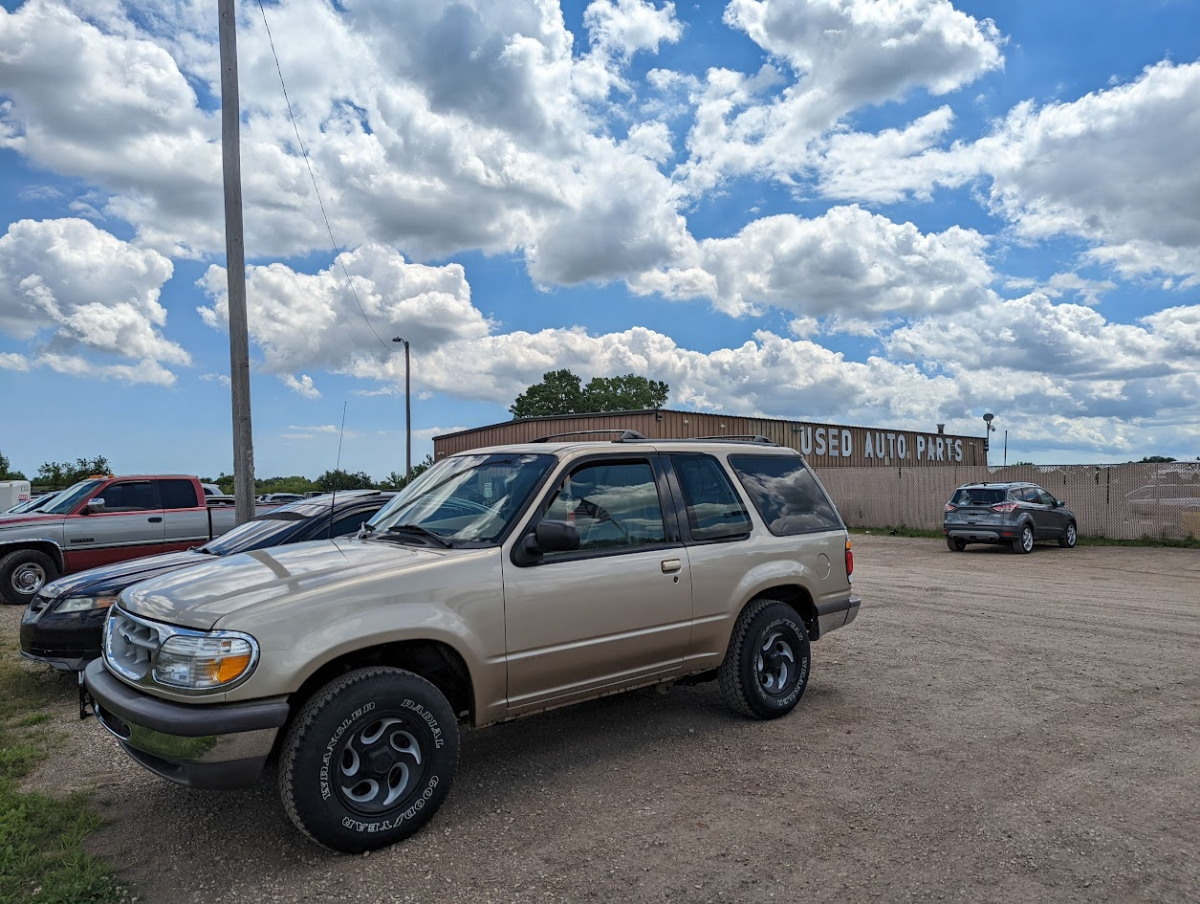

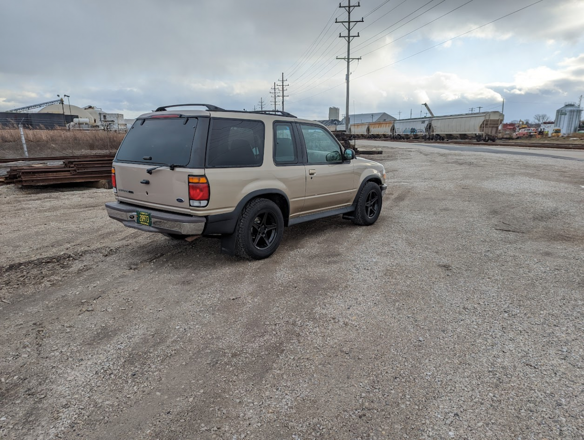

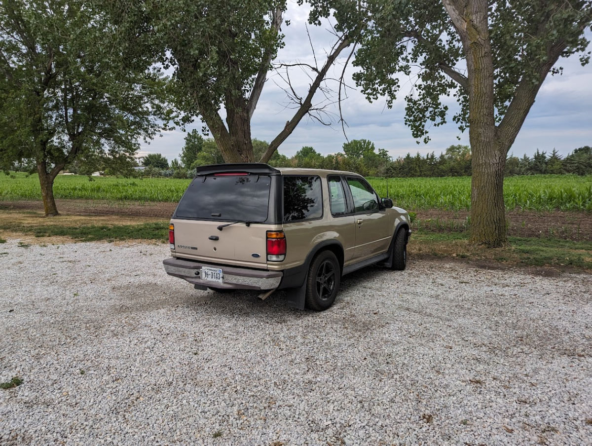

In the meantime, the Sport kept limping along and made it to a couple car meets
First car meet of 2024. Finally got black bumper trim everywhere except the valence.
