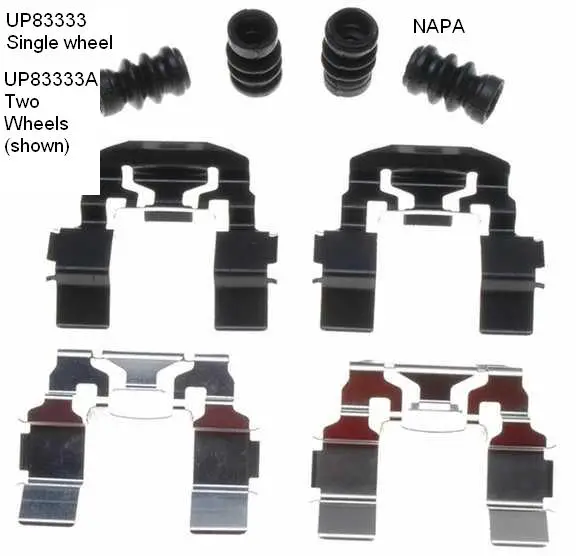

This is just funny. A similar post in the Sport Trac section last night, my friend calls me today with the same symptoms and now your post. All almost word for word......... Read here what the original poster found. Yours may be the same thing.

Incorrect link posted initially, check it again.

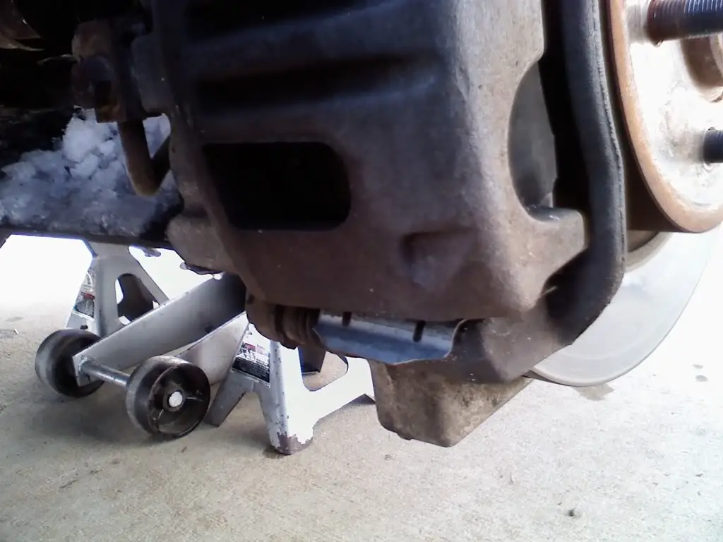

Problem Solved! It was the lower brake pad bracket on the caliper. (See Pics Below.)

That's exactly what mine looked like, except it was on the top side.

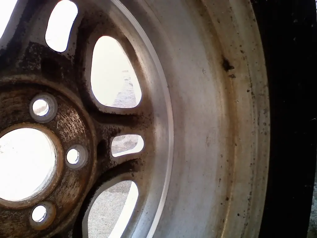

I had the same thing happen to me after I drove around in a foot of snow in my '02 xlt
I heard a weird noise that I couldn't even really describe to my dad over the phone except as maybe a brake lightly dragging. I looked into it more (which was tough since the parking lot had 3 foot snow drifts) and finally found that damn little clip rubbing on the inside of the wheel. I tried to bend it back and it fought me a bit but some brute force with a screwdriver got it fixed until I can take the whole wheel off and look things over.
First pic is when it was rubbing (and worn) and the second is after I did some minor bending.
