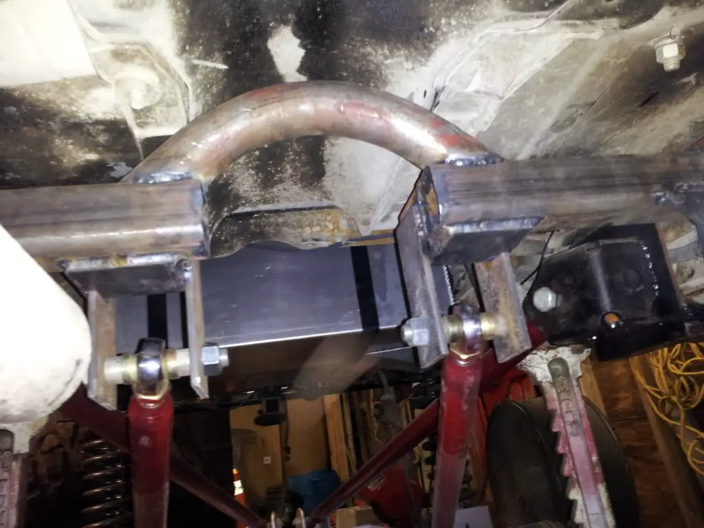

Then i trussed the rear axle and started building a double triangulated 4 link

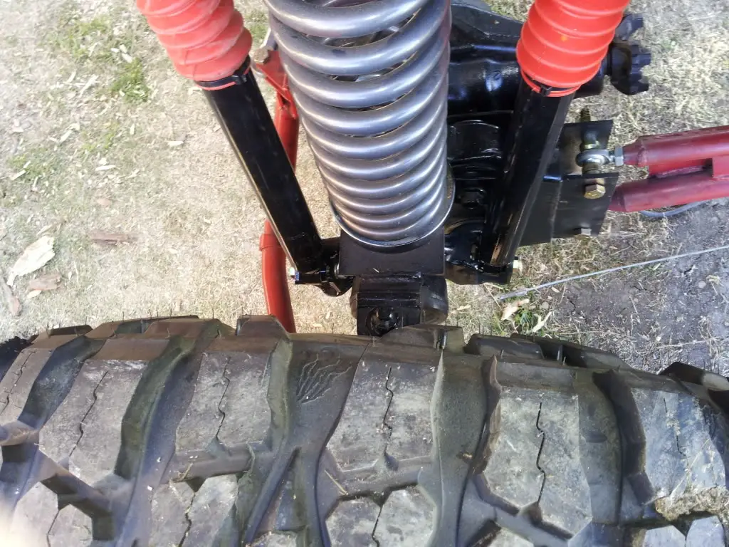

so i decided to experiment with some 79' f150 coil springs with an internal shock mount design

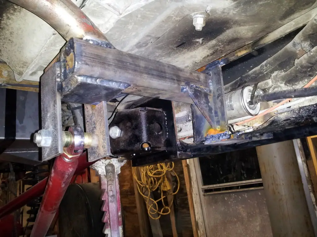

installed the new rear lower 4 link truss i made last night and welded it up..

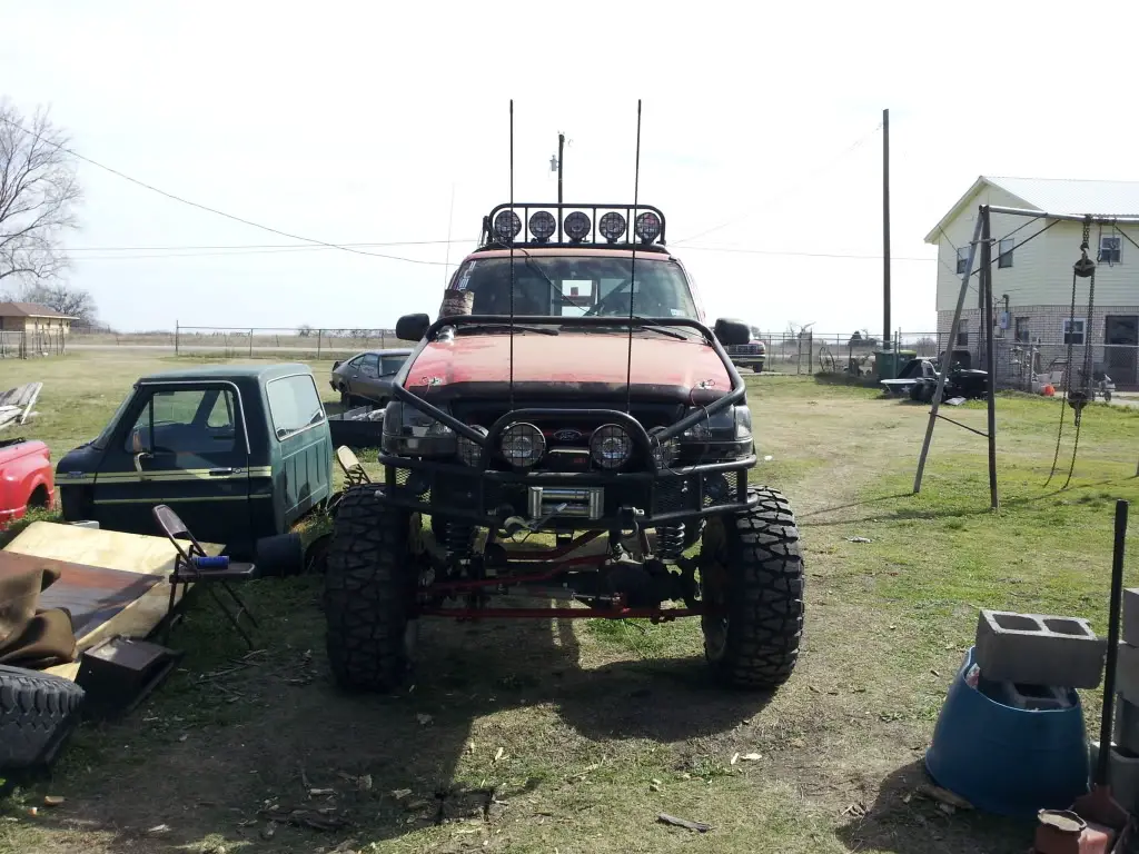

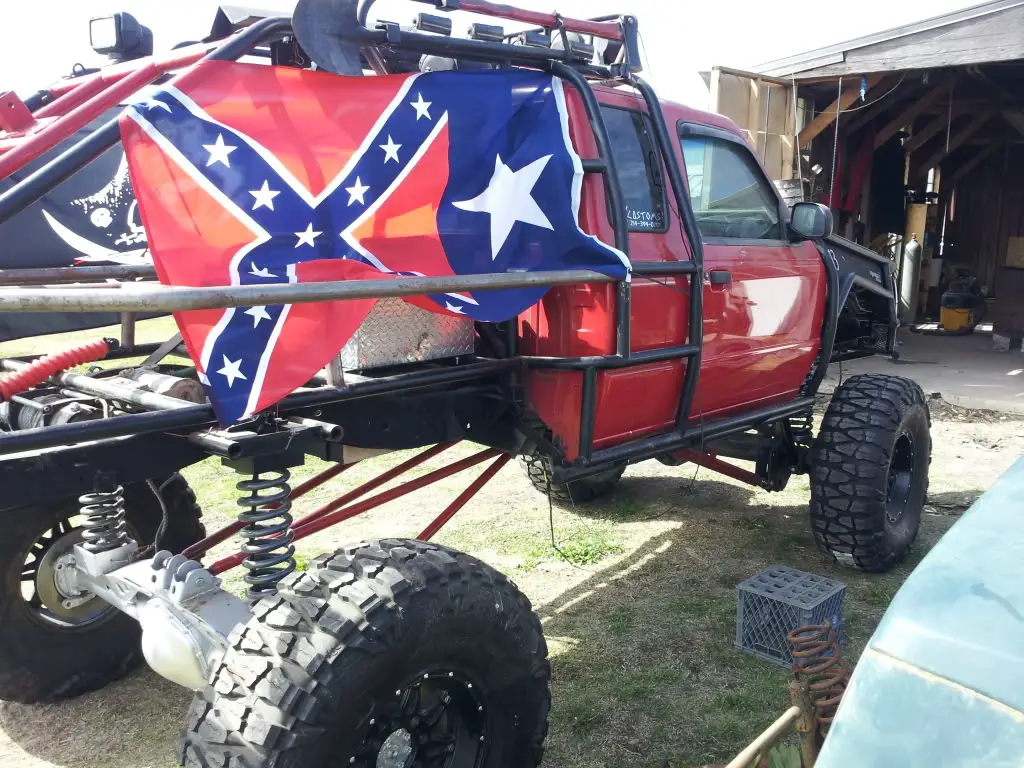

I decided to see what the ride hieght was gonna be with the tires so i put on the rear tires and raised the front to match...OMG!!!!! Its freaking huge!!!(she said comments here) im gonna run it for a bit but im thinking shorter springs before Moab..

quick update.. i put the truck on all 4 tires last night and pulled it out of the shop... first time in 2 years she has seen the night light!!!

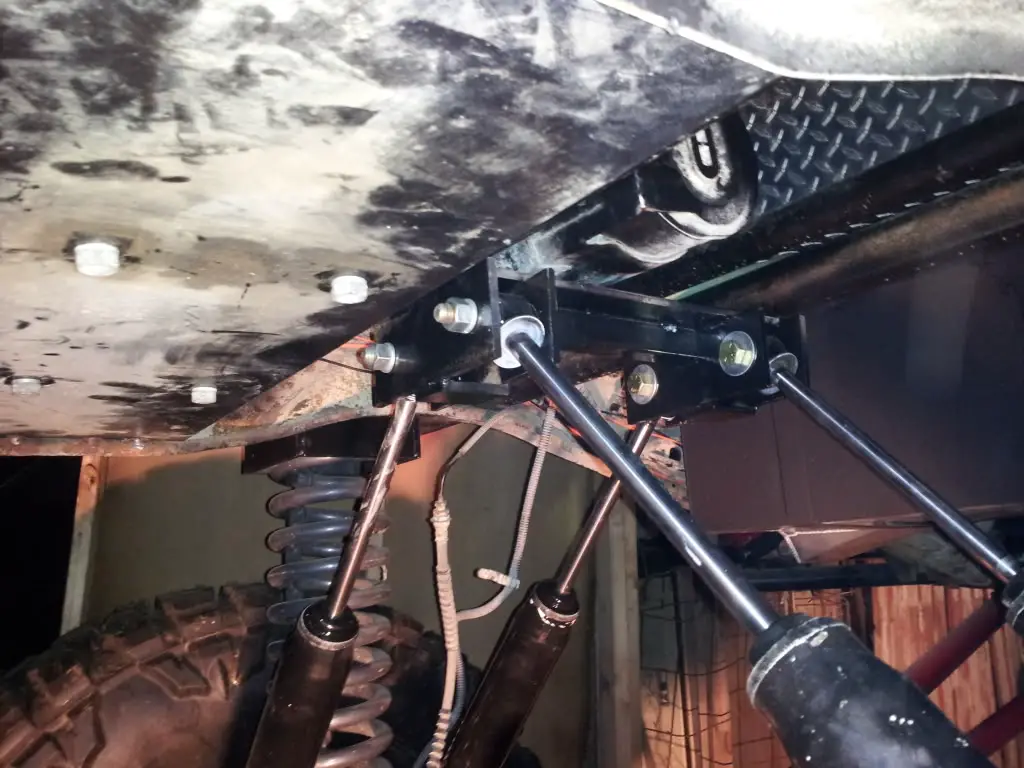

Thanks guys.. the lower link mounts have been finished.. that pic was just from getting it in.. the lower tabs have been boxed and gusseted, and the whole crossmember has been braced to the frame in a few spots.

And im definatly gonna have to drop it about 6 inches, its a lot taller than i thought...

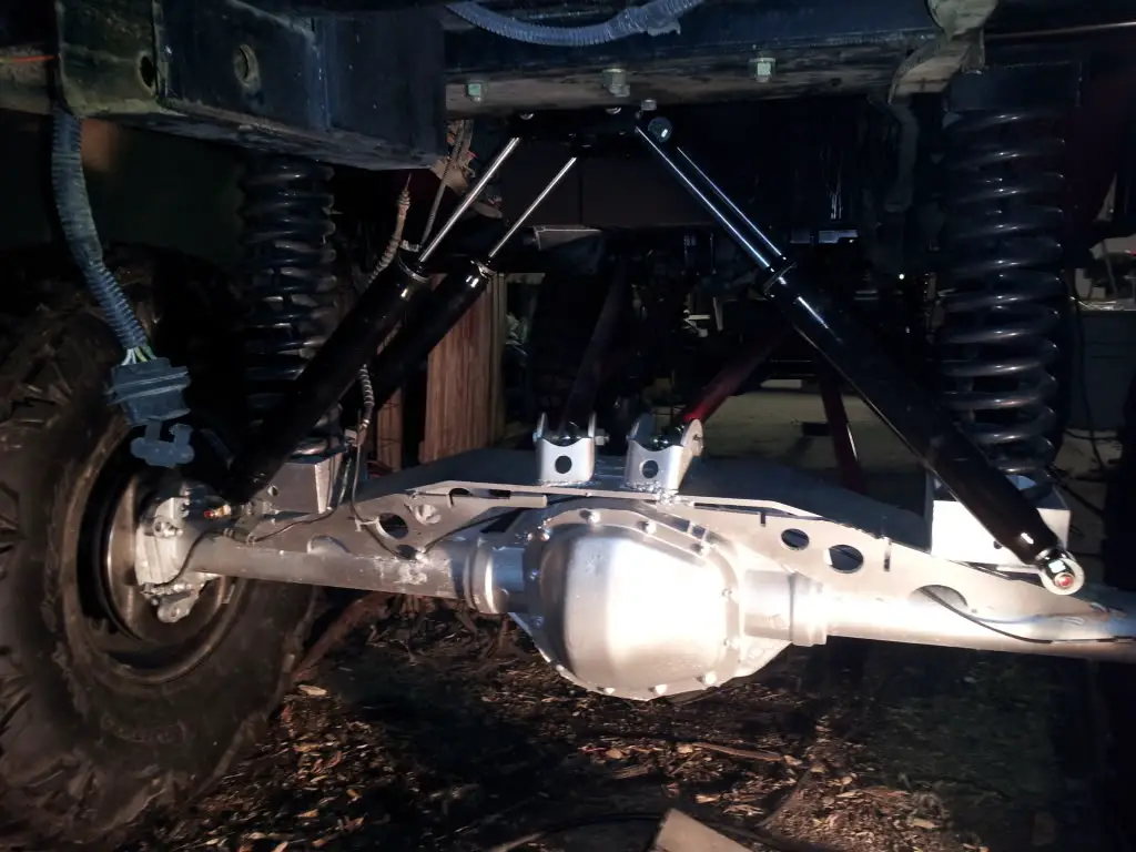

I have decided to go with dual shocks on all four corners, i picked up 8 Procomp ES9000 Dual bi-pass nitro shocks at 15" travel
ill get some pics of the shock setup later today..

Last night i finished the shocks and brake lines..
She is ready for the driveshaft shop!!!!
I have got to say, i don't think i have seen a rear shock setup similar to yours! It looks bad@$$! You have done an extremely nice build here, one of a kind for sure! Now it will feel like ages until those shafts are completed :)

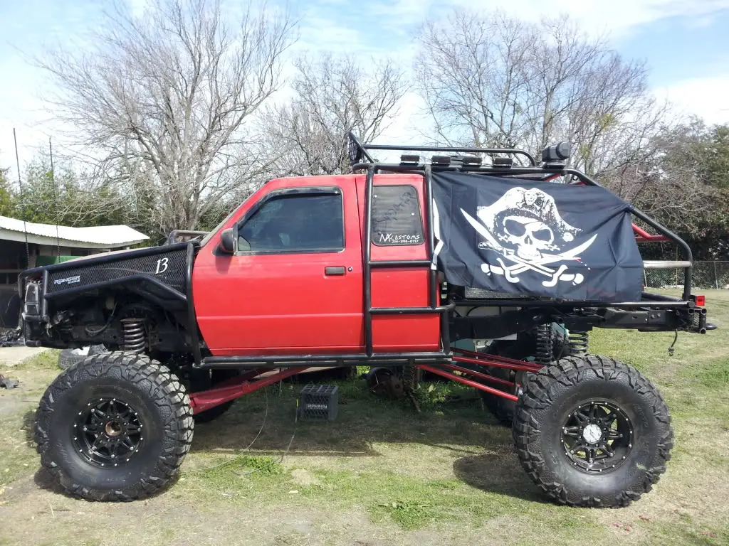

And all i have left is to start building the plates for the bed..
Well i am very excited for you. You can just about say you have completed the swap, something that is rare and spectacular. Congratulations sir! Glad you continued on :)
Thank you sir!
i wanted something diffrent and radical and thats just what i got...
