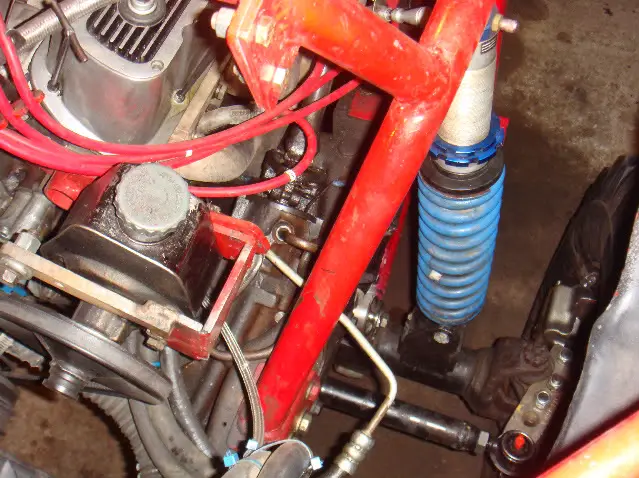

Just go with one of the Toy box - bigger community running this box so there's plenty of info and aftermarket support (like when you want to tap it for hydro). Try to stay away from an inboard mounted box - it just makes it more difficult to replace. I was able to completely remove the Toy box from the chassis in a few minutes.
Posted via Mobile Device
Chad, there is not even enough room to get your fist between the frame and motor in the 5.0s. No way a box of any kind would go in (without a ton of mod).
X2 on that. I could remove mine in a snap if I needed to. Plus I think your engine compartment is just as crowded as mine. The 302 and the 351w are the same size btw, the 351w is just a little taller. Everyone is always asking how I got it to fit, but its pretty much the same as the 5.0. Pretty much the same power and torque too, at least while stock. I have a little more potential though, there's no replacement for displacement! :D
-- I have several suggested feel free to PM me for more info
1st - As far as steering goes, I would recomend Gen1 Explorer Steering Box, but that said with V8 I'm not forsure yet if it will work, I know you would need to do Oil filter relocation kit, but other than that I think it will fit. If not outside frame rail box will be needed.

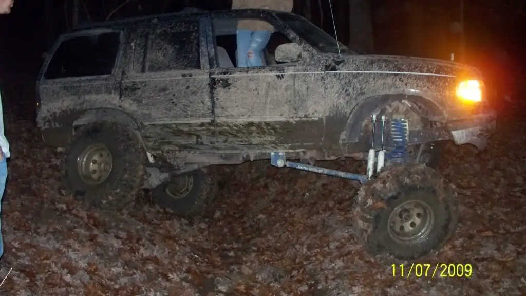

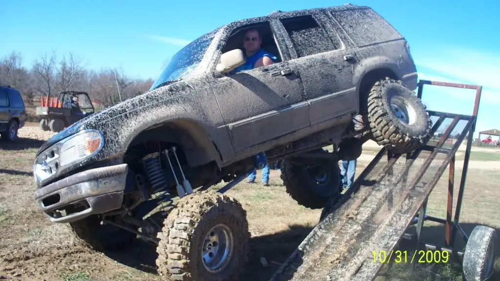

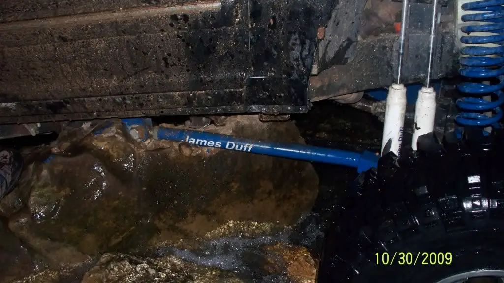

2nd- Extended radius arms are the way to go, more flex and you should be able to keep stock tranny cross member, I did on my 97 4dr SAS
-I recommend James Duff Longarms, mine were to ones they list as Bronco2/Ranger SAS swap parts, extreme flex and super Tuff -trust me :)

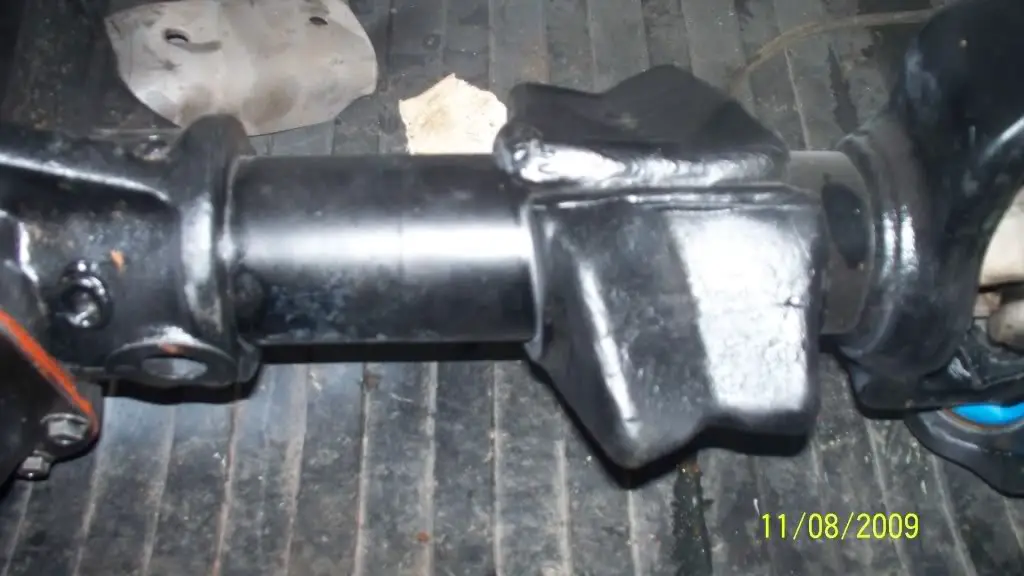

Not sure if I missed it, do you want Narrow or Full witdh? - If fullwitdh a 76-77 F150 dana 44 has disk brakes and is a better swap, reason being is you can move axle wedge mounts on the tube to get correct coil alignment at the bottom, instead of spacing your coil bucket towers out on the frame.
Thats all I have for now have to go to Lunch..
Just trying to show you some pics on why you should go Longarm :) I loved it.
This is a 76-77 Front axle see how the wedges are not a cast like 78/79
you guys rock. And those pictures are precisely why I want to go the long arm route. The trans xmember sticking around is just and added bonus :D. JD long arms are $$$, so time will tell if I do that or lengthen the radius arms. After looking at the truck and seeing some different set ups, the IFS toyota is the current choice for steering. I like the service-ability of externally mounted as well. And the steering input will be from a 95ish Aerostar.... I think lol. Hopefully it will be long enough, as the box will be waaay front. Now, I've yet to see the axle of choice, but it it's supposedly a split wedge, which would be money. And it has disks. Just the wrong ratio, but that's fine. Do you know off the top of your head how much spacing the buckets would need if its a cast wedge? Hum, chromemolley shafts dying.... the hell were you doing lol? Hopefully I won't be doing anything that rough. And what would you recommend outside of a dana 44 full width? And no, I'm not going with a 14 bolt :confused:
If you use 78/79 with cast wedges I think you will need to space the buckets out about 1 & 1/2 inch to 2inches.
