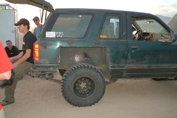

trckmagik did a 3 link in the rear of a 4 door with coils.
The rear glass gets mounted over the original quarter panel. Since you have a sport, you can cut a lot of the sheet metal away for more clearance. Or just cut most of it and retub the inside.
JoshS. and FAKRWEE both have or had glass on their 2dr rigs.
I'll find a pic of JoshS's real quick.

Looks like some nor-cal redneck action right there.
