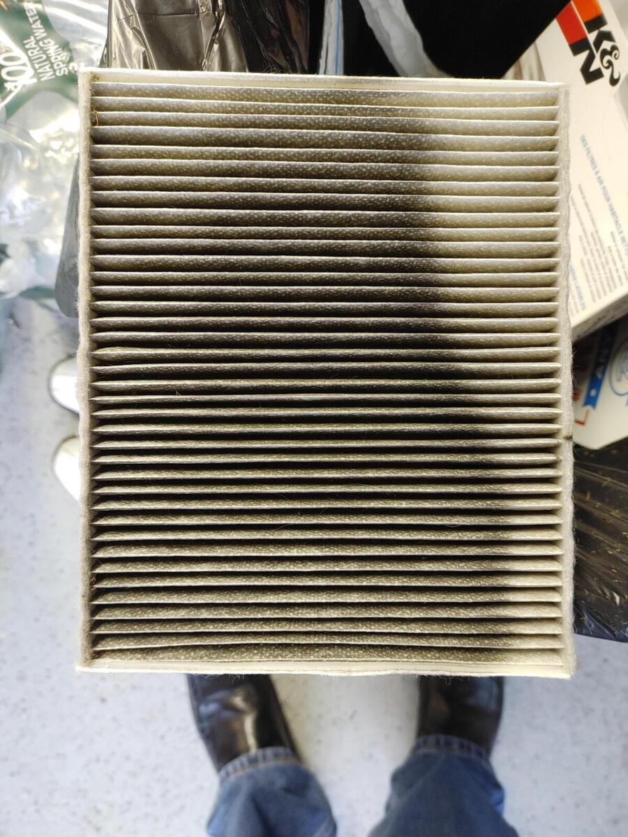

Took EcoHell to (another) performance shop, replaced both O2 sensors and oil change (of course) and just the other day, I replaced all of my wipers and replaced the in-cabin air filter. Very interesting and very easy job btw. I would highly suggest everyone change their filters annually OR purchase the K&N In-Cabin filter where you can wash it and reuse it. It is a very high quality filter.
Sorry for the large photo (at least from my monitor), but wanted every one to see this is from 2018..and this was AFTER I banged it against the trashcan..I was shocked..and I am not one to use the Climate control that often.

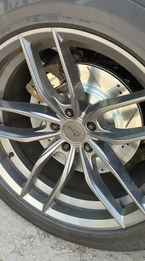

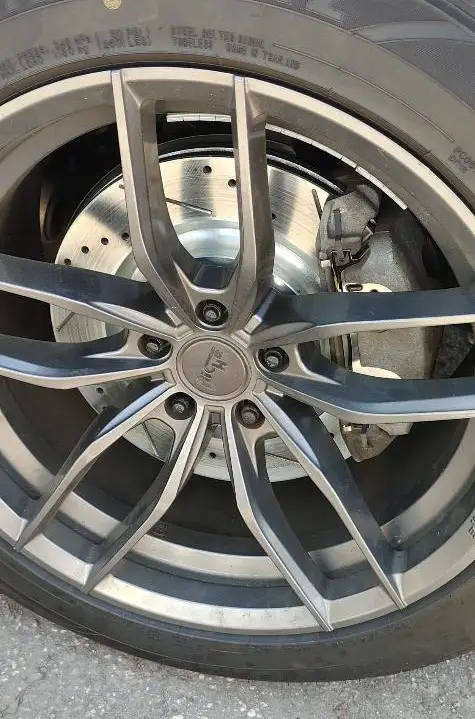

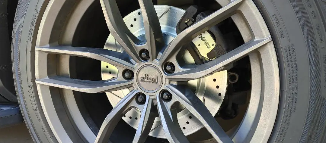

Posted this in a different forum..
For some reason, the rear pads fade quicker than the fronts..weird for a SUV, but that is Ford for you. Sooo, I pulled the trigger and purchased the PowerStop kit for the Sport. Bedded them in and no squealing..so all is good.
I will provide updates accordingly.. anyone else have any issues with these brakes??

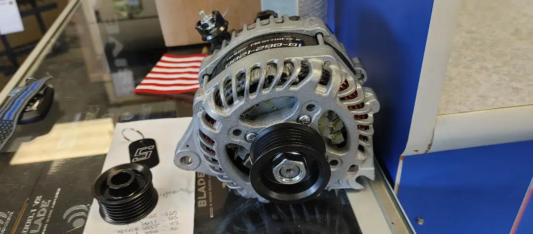

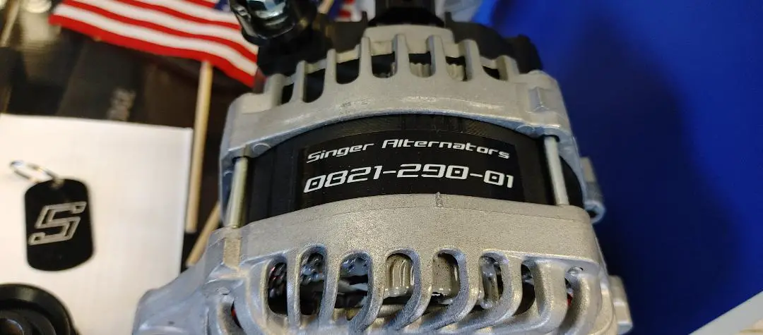

After the brake upgrade, I did not want another low voltage issue, so I also pulled the trigger and purchased and had installed a Singer High Output Alternator to handle all of my electronic needs. I will provide updates if something goes wrong.. so no news is good news.
Anyone else install a High Output alternator in their Sport?
You get both pulleys and a keychain to boot...HA!
