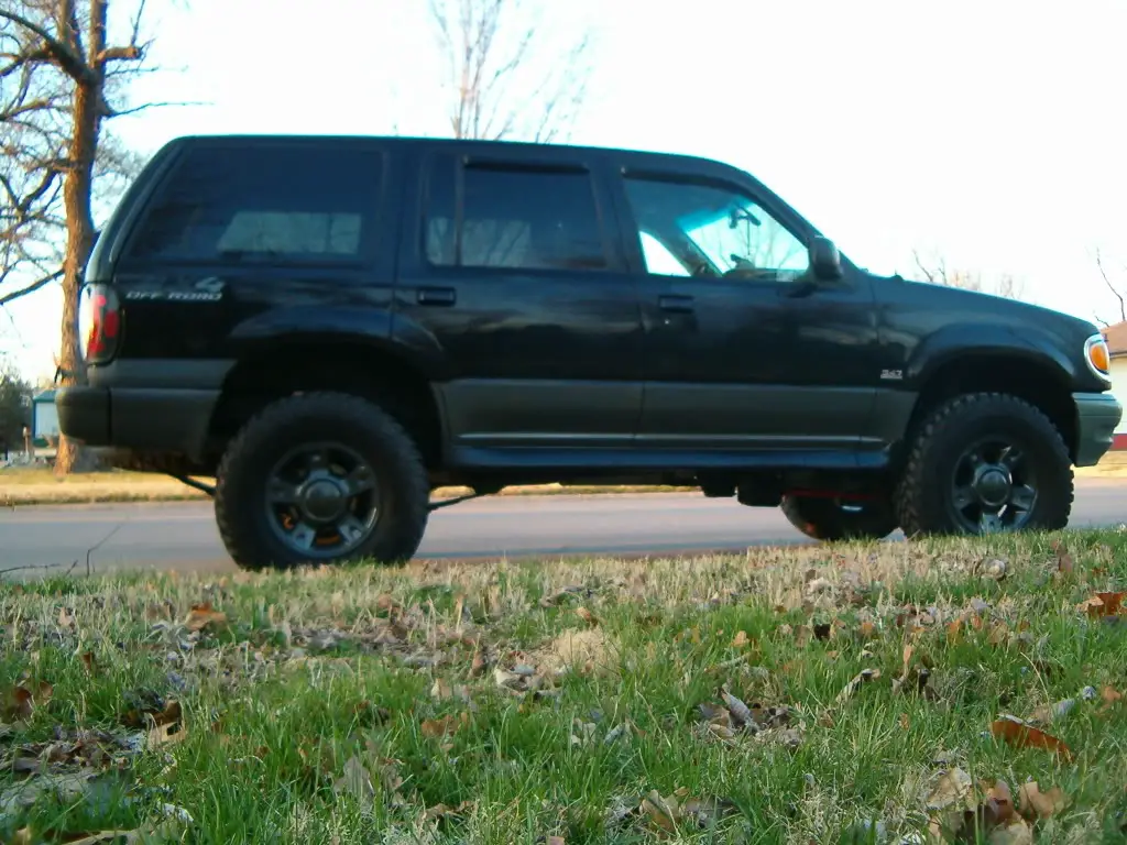

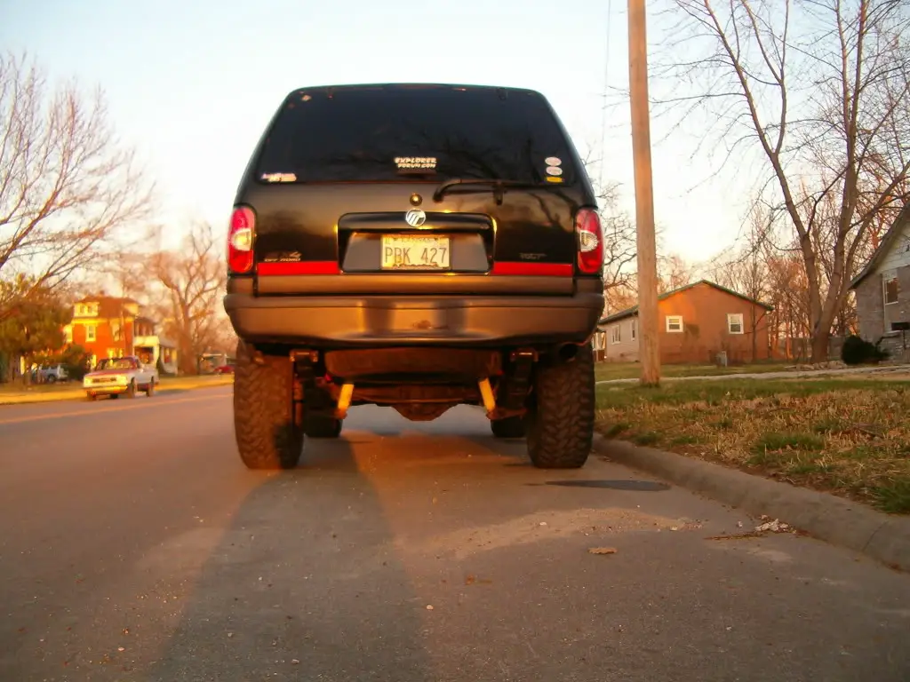

The 2 mx4's lined up
After a little cleaning, and some mothers polish on the tree scuff
I need to do a little more work on the center caps to get them to stay put, but for picture purposes, here they are

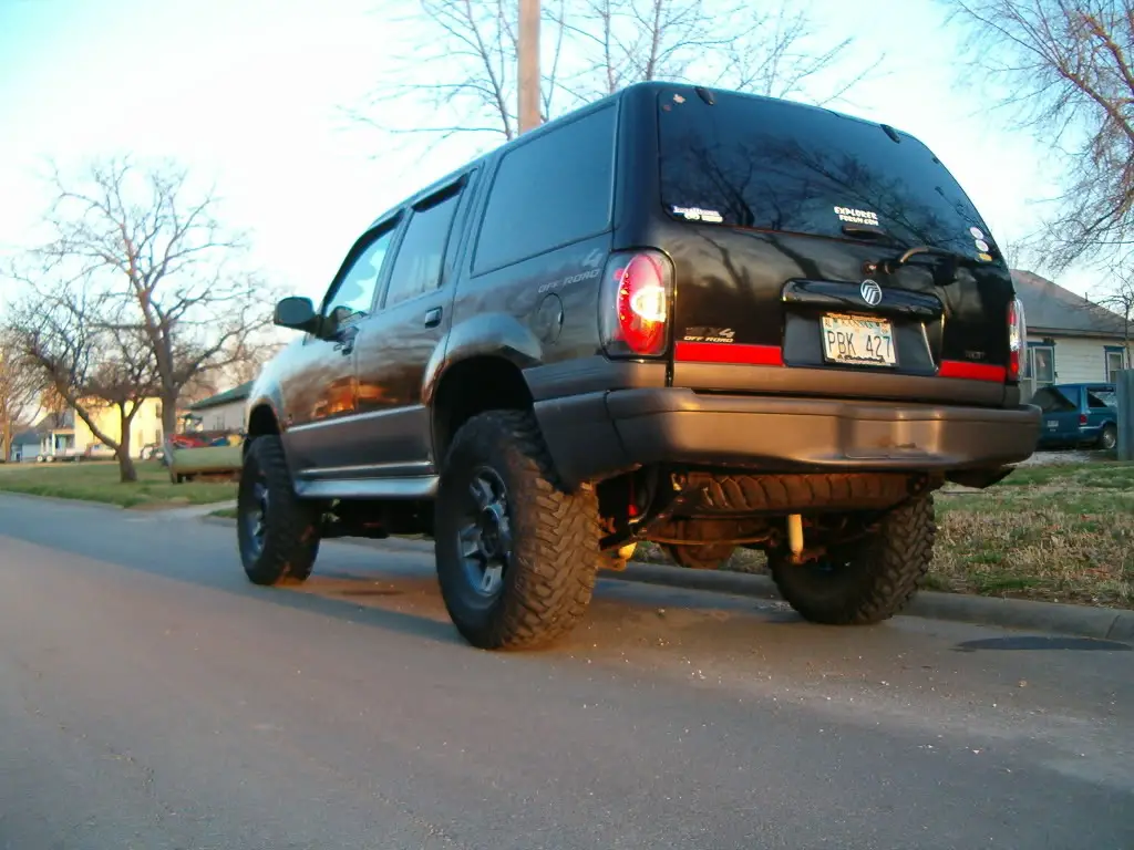

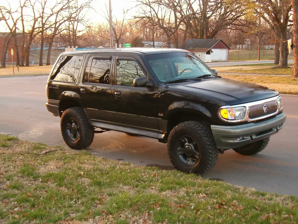

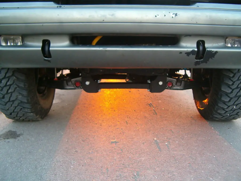

smoked chrome control arms and spindles, red t -bars, titanium metallic endlinks, and wrinkle black drop brackets.
I will have this pretty'd up in no time--the object was to get it to where you can see it
33" spare tucked away

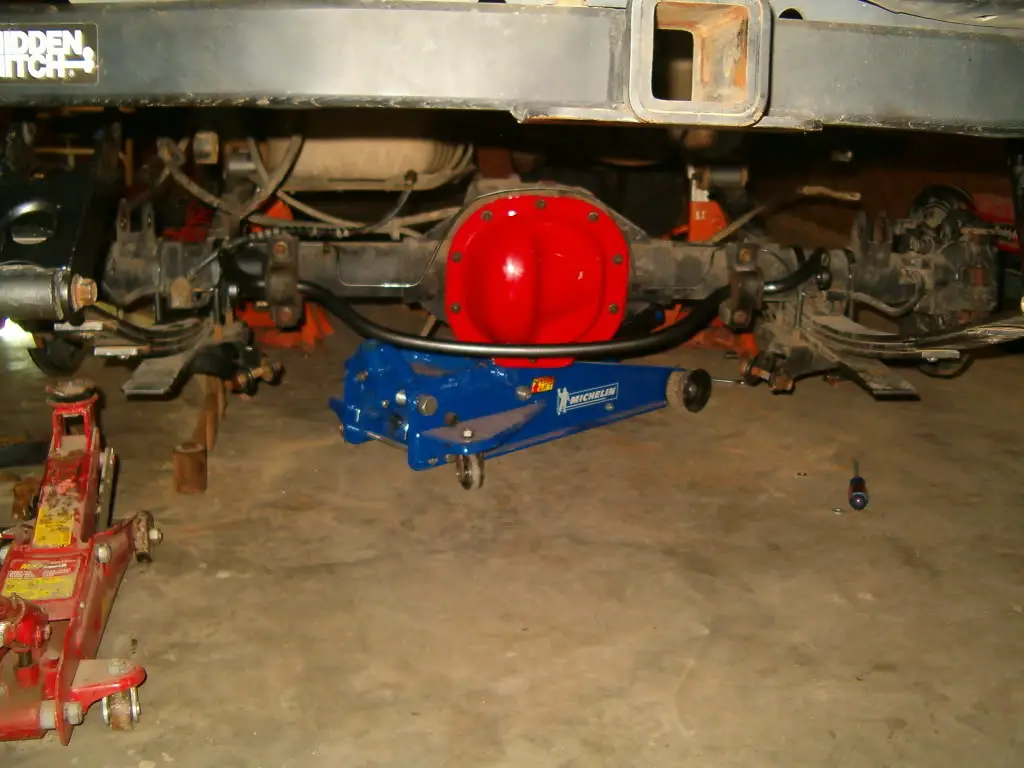

So what was the object of the rear end swap?
Gear ratio?
Gear ratio?
I had 4.10's, open carrier with an Aussie Locker- Amber (my wife) is now DDing the Mounty, hated the locker- it didn't suit her driving style so to speak. :D
She likes the LS much better, and the 3.73's are a better fit with 31's for highway driving.
I also had a CAD front diff- won't fit without the drop brackets- that is one thing I will miss- CAD is awesome for driveability and mileage.

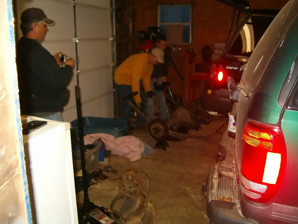

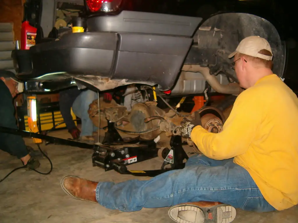

What hasn't been told was what we all worked to do- Jon arrived about 4 PM Friday. We finished up around 4 AM. At 8 AM Saturday morning his mounty was getting an alignment and tires mounted. Sure the driveshaft wasn't in, and the transfer case skid plate needed to be bolted back up, but in about 12 hours, we swapped rear axles and installed a front lift on an all nighter. It would have been sooner, but all of Jon's brake fluid leaked out while we were eating dinner and bleeding the whole system took forever. Saturday afternoon, we put the diff under the front of mine and installed the CV axles. Two trucks torn apart and reassembled in around 36 hours. :thumbsup:
I'm still tired.........
What he said. I didn't even 10 percent of the work, and I don't know if I will ever be the same.

Please show me what you did to get the 33" tucked up under there and also PUT A CHAIN OR CABLE ON YOURS
no way will the stock winch hold that 33" up there for long and the last thing you or other drivers need is a 33" tire inthe middle of the highway LOL
truck looks *****in! what front bumper cover is that? 98 Mounty?
Wow it looks great JT!!
Thanks Jamie
The bumper needs repainted again, I would like to find an Eddie B metal bumper and coat it.
This one is supposedly just a xlt style explorer bumper cover I think.
Evan was hauling this spare around with a hidden hitch, however, a "Draw tite" hitch will only allow a 31" spare
I'm going to coat my rear bumper and hidden hitch smoked chrome when I have a chance, then install the hitch.
Where should I anchor this safety cable??
I have been in a semi-coma since midnight last Friday! The only thing that woke me up a few hours later on Saturday morning was the smell of Breakfast cooking in the kitchen.
I think once I am healed up from this adventure, I am going to finish up some of my own work to the Black Hole. I definitely have been motivated even more than I am already to just jump into it and get it done.
Doing what we did in the time frame we did it makes doing something like changing shocks seem like blowing your nose. I already did the f150 coil spacers on the 1st gen by myself in about 45 minutes. These guys just built my confidence level up another notch.
