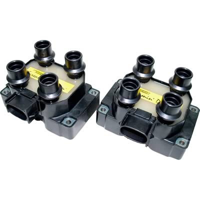

I've been trouble shooting an issue I've had for a while and swapped out my MSD 8241 coil packs today for the stock ones to see if the issue would go away (jury is still out). Anyhow, one of the towers on one MSD coil pack was damaged (no, not the one I swapped with you Eric). One driver's side terminal was very corroded and part of the terminal was sort of "broken". I suspect it may have happened when I paid to have Magnecor wires put on a while back. The terminal is almost "crumbling".
Anyhow, regardless of what happened, I'm looking at possibly replacing my MSD 8241 coil pack and started looking at the other options out there. Sure there is OEM (which is fine). There is also the Accel 140018 pack (which many of used on this site). I stumbled across the Performance Distributors "Screamin Demon" 31725 coil pack as well. It looks identical in application to the other coil packs. While they don't specifically list 2nd gen Explorers in their application guide, I found an eBay seller who does. What is also interesting is that the MSD coil packs go for around $65-70 each, Accel for around $60-$65, but Screamin Demon lists them for $99, but are for the pair. So, these packs are cheaper than MSD and Accel at around $50/each (not sure what OEM go for these days).
Lots of people seem to love these things for the V6 applications. Anyone use these coil packs on a 5.0? I'm tempted to give them a try in due course. Yes, I know all about getting marginal benefit from upgraded coil packs, but sometimes upgrading just for the sake of upgrading can be fun too. :D

Any advice, opinions or experiences are welcome. Thanks in advance. I've seen NO mention on EF of the coil packs on 5.0 Explorers/Mountaineers, just lots of V6 use. They do seem to be a direct replacement for the MSD and Accel packs on other forums/sellers so I can't see why they wouldn't work on our rides.

As mentioned in my original post, I do have the 8241 packs now (have used for years). Several other EF members use them too. I've found posts where users have the Accel offering too. I also found in my travels today that Jegs has a house brand offering for about $60/each.
Any way you slice it, the Screamin' Demon offering seems to be to be the best deal.
Just want to hear if any EF members have given them a go for the 5.0. This isn't a V6 thread. Plenty of comments on those in other threads. :p:

I've done some reading tonight and I'm 99.99% certain this coil pack would work on our Explorers. Turns out there are lots of aftermarket options out there. Rock Auto has several listed, although none are MSD or Accel. OEM run around $80/each from what I'm seeing so it really is a viable option. Screamin Demon seems to be the aftermarket coil of choice on a lot of Mustang boards (those with older 4.6L applications anyhow).
I think I'll be the guinea pig. Found a place in Texas called "Latemodelrestorations.com" (they even list the MSD and Accel coil packs as "alternatives"). Just waiting for a USPS shipping quote to Canada before I make a final decision.

The Screamin' Demon Coils are designed to produce an exceptional spark throughout the entire RPM range with virtually no drop in power. Stock coils are notorious for falling off as RPM goes up. Our Screamin' Demon Coil has been dyno tested providing 3 more horsepower at 5000 rpm over stock coils. The Screamin' Demon has a brass terminal for which your coil wire attaches to. The brass terminal is more conductive than the stock aluminum terminal and will resist corrosion longer. Plug gaps can be widened to .060" due to the energy of this coil. The wider spark plug gap will allow more spark energy into the combustion chambers providing more power and improved mileage. The Screamin' Demon is too "hot" for stock plug wires. 8 mm spiral core wires are highly recommended. The Screamin' Demon is an externally mounted coil.
Done deal. I should have them in a week or two (depending on which USPS service they used, but based on the price I paid....it better be a faster method!).
Worked out to around $135 CAD so just under $70 each. The best I can get a MSD 8241 coil pack locally is $79 CAD and that's a killer price (seen them for $100+ at other Canadian sourced suppliers).
I doubt they'll make much of a difference, but you never know. :D

The stockers seem more than adequate. One thing I did notice when I looked at my MSD packs yesterday was that the terminals are brass as opposed to aluminum in the Ford offering. The Screamin Demon offerings are the same. I don't know if it's just marketing or if it makes a difference. Probably marketing. :D
At $100/pair, these things are a viable option to stock most likely. I didn't find any negative info on them so you can't beat them for the money most likely.

I did find they have single coil pack applications for the Focus, same coil pack. They run about $65/each so in line with MSD and Accel (and other offerings). Having a V8 has it's benefits. :D
the focus pack is the same part, you just only need one instead of 2.
Exactly. But they charge $65/each for one pack or if you buy the V8 application, they charge $100 for both. Too bad MSD or Accel didn't consider a similar pricing scheme. ;)
That's why I think if these things are a good deal vis a vis MSD, Accel or OEM (or Jegs for that matter). They're competitively priced for single packs, but a great deal when you buy both. As I said, another reason why having a V8 has its benefits. :D
