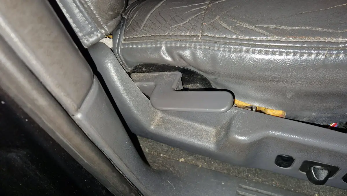

So, my "The North Face" /Limited seats have started leaning back whenever I accelerate and I'm assuming the lever is to blame (pictured)
Can we get new ones? Is there a replacement or upgrade?

If they are not factory seats, do you know what brand they are? Were they part of a custom package from the dealership?
It wouldn't hurt to verify if the recliner bolts are tight as well.
Those plastic recliner levers are a pain!
Some sport tracs had them
When they break they are hard to fix
I have replaced them with a fabric strap in the past
If your seat is reclining and not locking into positions you will have to take the seat apart to see what’s going on and fix it … remove the plastics and have a look
I have some pictures of how I fixed these in the past I will post, but my issues are always a broken lever, not a broken seat
