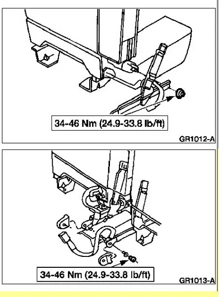

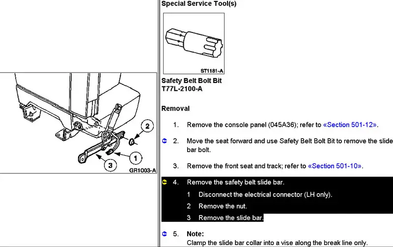

Here's the procedure to replace it(96 and 97 should be similar):
belt 2
belt 3
belt 4
belt 5
I bought a new buckle assembly (part #3 in pic #3) for $50 at Ford. They even still had it in blue to match my interior. Easy to replace too.
Safe once again
Went to the dealer and spent the $50.00 for buckle assembly. Relatively easy to install - after you remove the seat :D
