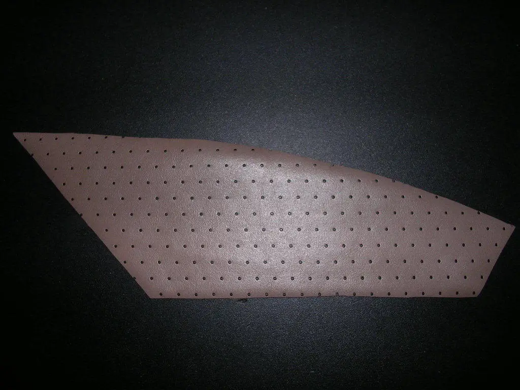

ic, i'm kinda doing the same with my passenger seat right now ( already did it to the drivers seat) i'm fixing the side bolster....pic
just remember that when looking for replacement leather that the one that i just showed you is the regular leather type of leather ( the pin holes are wide) ...i came across many seats that were from eddie's and the leather is better quality but the pin holes are more closer together and also the tan eddie leather is a little darker than what i just showed you that is if you want every thing to match up color wise .
just something to pay attention to when your at the yard .
