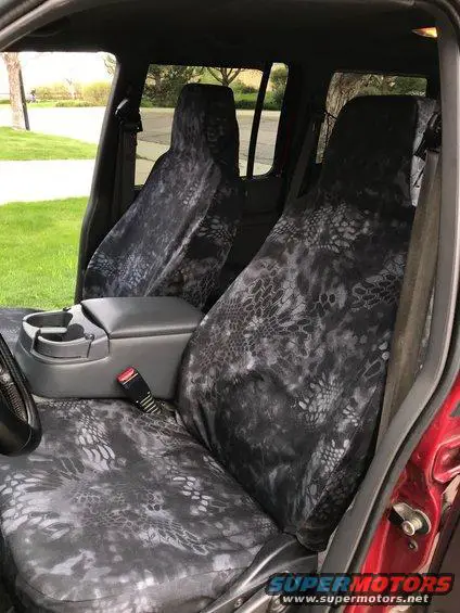

This is a 60/40 bucket/bench from a 2003 Ranger. I say bucket bench as it had a flip-up consul/seat back so a little person could sit in the middle. I never intended to use it that way and didn't set-up the seat belt to do so (I always were a belt). I didn't wire seat belts and solved the issue of the seat belt and charm going off by turning off the seat belt indicator. I am not sure you can do that with a 95 but wiring them is easy as well.
I am 6'2", my lady 5'6" and these tall buckets fit both of us nicely:
I like your seats sir.
I like that bucket/bench! It'd be a solid way to increase the seating capacity of a Sport to 5 passengers. As someone who's ridden in the middle seat of a manual Ranger, I will say that shifter gets a little awkward haha.
