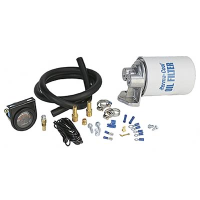

I think i found it, complete kit
Perma-Cool 10677 - Perma-Cool Deluxe Automatic Transmission Filter Kits

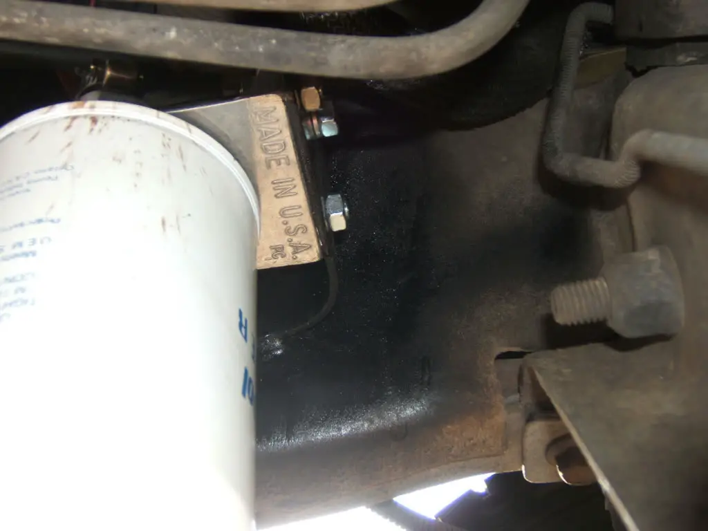

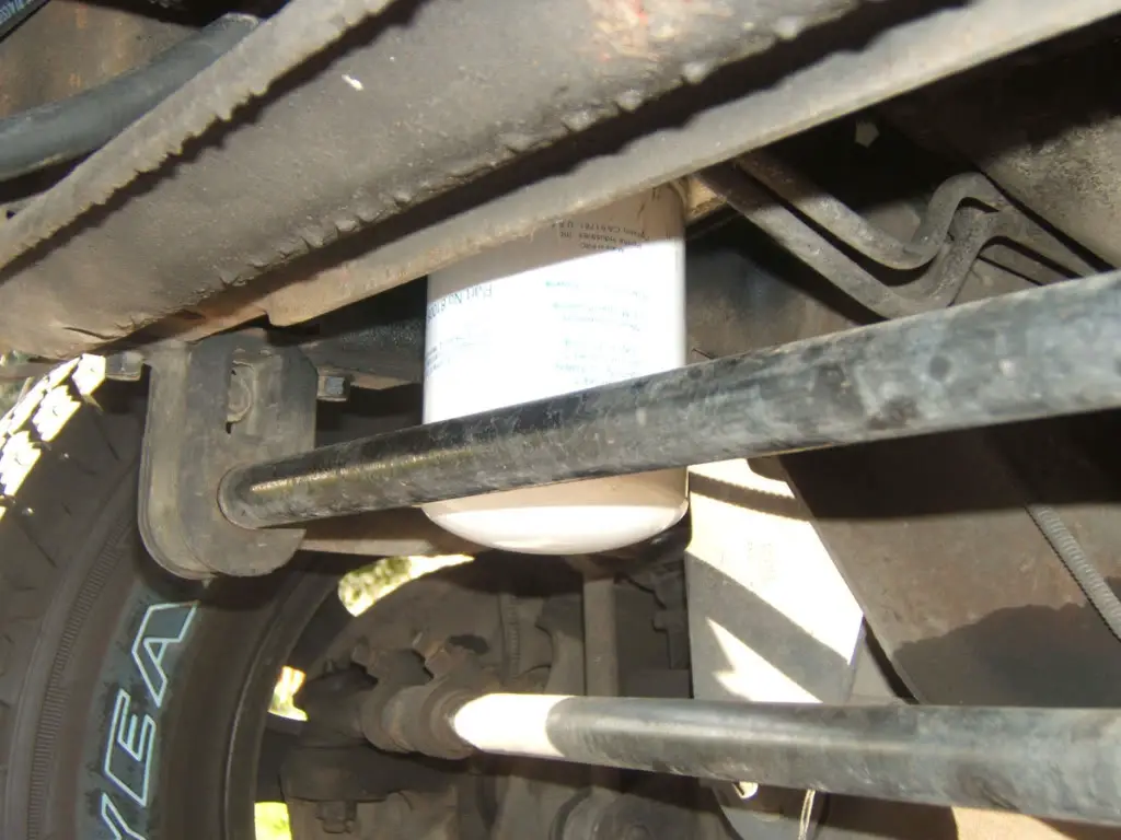

got it installed last night. very straight forward process. i installed it b4 the factory cooler (rubber hoses) just need to find "the spot" for mounting permanently. until then its on the inside wheel well mounted to the bottom of the frame not on the side like i been seeing. i want to find a better spot tho.
i think i am going to mount it next to the hard lines near the bottom of the radiator (pass side) then trim my black plastic cover that bolts up under there so it is hidden and has a good air flow.

You could mount the filter in any direction. Most people mount them right-side up, or horizontal. Mounting it upside-down will make for a messy filter change, but it'll function otherwise.
