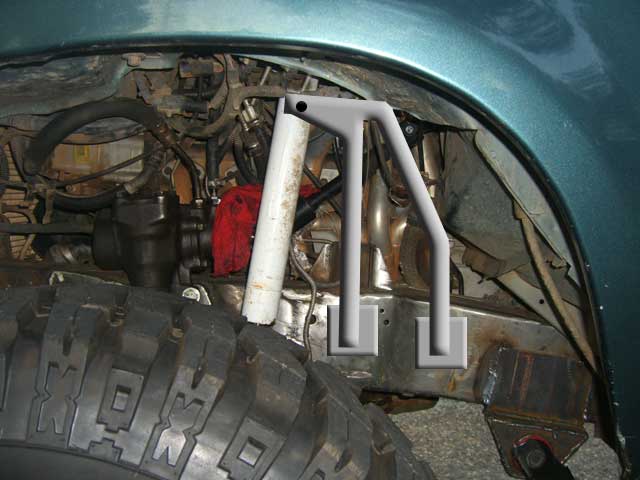

What do you guys think about something like this??

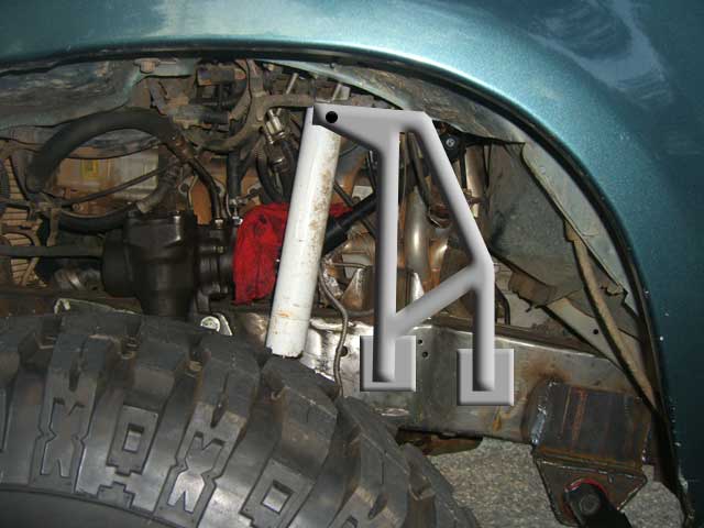

Maybe some triangulation?
I think that looks good Section. As JTSmith suggested, maybe something on the other side (engine side) of the piece to "triangulate" it against the top of the chassis - just something small
jtsmith said:
And maybe a crossmember-tower brace going up and over engine to other shock tower?
edit
It may be too low to incorporate a engine crossmember. But maybe. I probably wouldn't need one since it's only supporting shocks.
So, would it be wise to make this fit a 2" wide shock mount?
It would be wise to make it fit whatever shock you have ;) But going a little wider doesnt hurt, you cal always put a spacer/washer if needed.
Thank you captain obvious. :p But I don't have the shocks I am going to run. Either Fox, BBCS, or Bilsteins.. something. I think the Fox's are 2". But I couldn't find specs on the BBCS's. But I can't imagine them being bigger than 2".
LOL hax
Call up BBCS or whatever company u plan to run with!!!
But yeah 2" is a good bet. Right now, 1.5" comes to mind (after repositioning the rear shock)
I say just slap some F-150 shock towers on there and get it driving and flexing. You can always come back and build the proposed towers later. While this is all nice and blingin' it doesn't seem neccessary and unless it ties in an engine crossmember it doesn't seem like it's really an improvement. Unless of course I'm missing something which has happened before.
He's got a lot of metal - plus the kid needs something to do :o
And he wants the bling :p
Your avatar is weird .. weirdo :p
first you get the bling, then you get the ladies...allthough all I'd think you'd have to do is show them that beefy crossmember with the custom label and they'd hope in the backseat
I would just make a hoop??? go over the steering box on this side..
