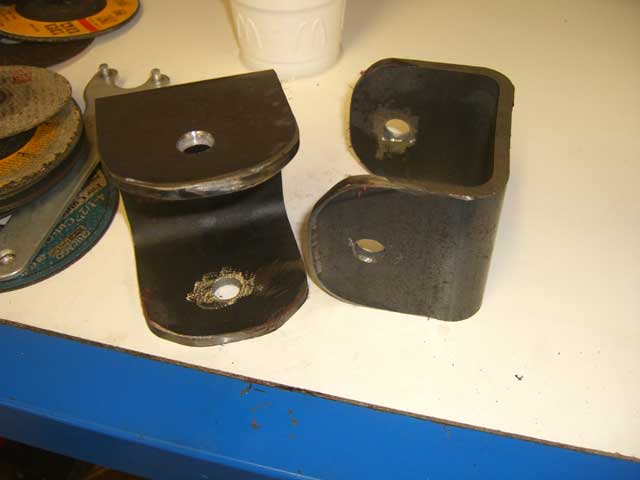

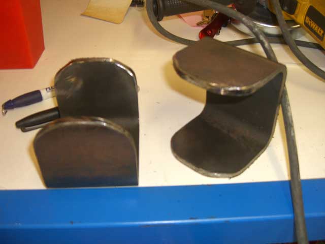

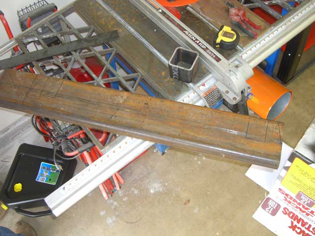

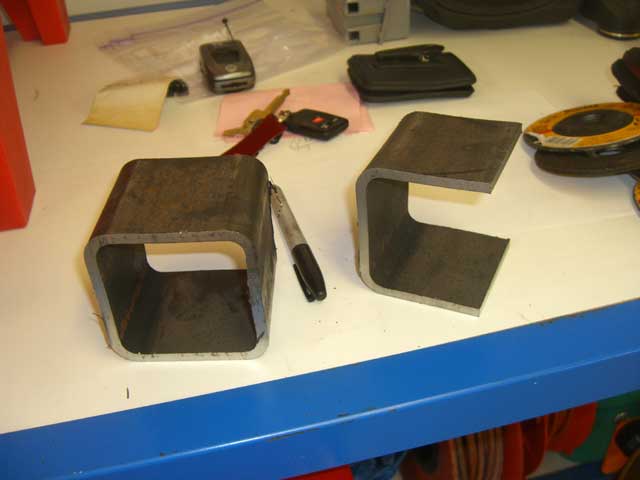

I picked up some metal for my swap today. I nice 2x6 piece for the crossmember as well as some 3.5" square tubing for the spring hangers. The local 4WD shop wanted $20 a piece for them. So I made my own for $4 each. :cool:
I'll probably start the actual crossmember work tomorrow or Sunday.
