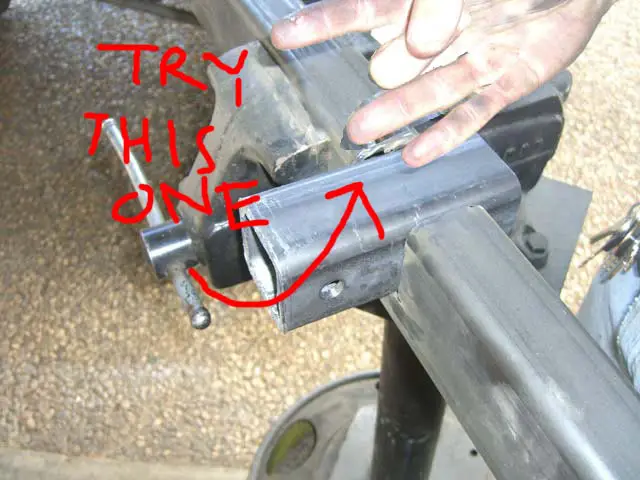

it consists of a 2x4x.188 rectangle tube grafted to the front of the frame, i cut the 6"long frame horns off, and the tube is welded right to the frame and the front body mounts. the Stinger was a mess up tube from my buddie tacoma we did last spring, it had two longer legs on it that came out at a funky angle on the bottom, i simply cut them off and welded it right to the rectangle tube.
it also has a 2" receiver hitch in it, i can put my tow hook hitch dealie in there, or my winch, on the custom receiver mount i made for it.
Got approach angle?
this the the receiver winch mount i made, i think i am gonna add some handle or something off the sides to make it easier to carry, but it will work for now.

the socker finger should be IN the receiver not just in the area, should it not?
