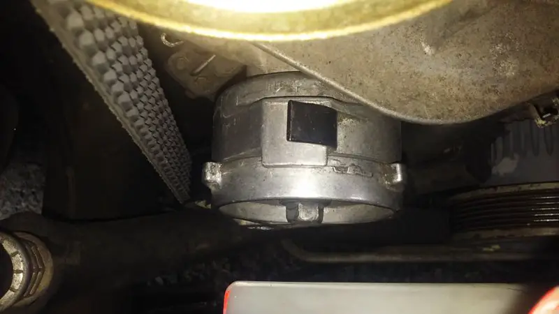

I'm looking to order a new belt from RockAuto and a bit confused. I see options for with and w/o an Air Pump. Would that pump be for an air suspension system or is it smog-related? I checked the number on my current belt (865K6) bought from a local parts store11yrs ago and it appears to be for a "with Air Pump" vehicle (just a bit shorter), but I'm pretty sure mine doesn't have an air pump.
The reason I'm replacing is that it's now chattering when under a load due to the stop lug on the belt tensioner hitting. The belt does have check marks, but otherwise in good condition. I did compare my 865K6 belt to an 868K6 that a local parts store looked up for it and the 868 is a little shorter. I'm wondering if my problem is the belt or the belt tensioner. The tensioner is not the original, and was also replaced 11yrs ago.
It's approaching 180k and on it's last leg, so I'm trying to keep the replacement part list short...
