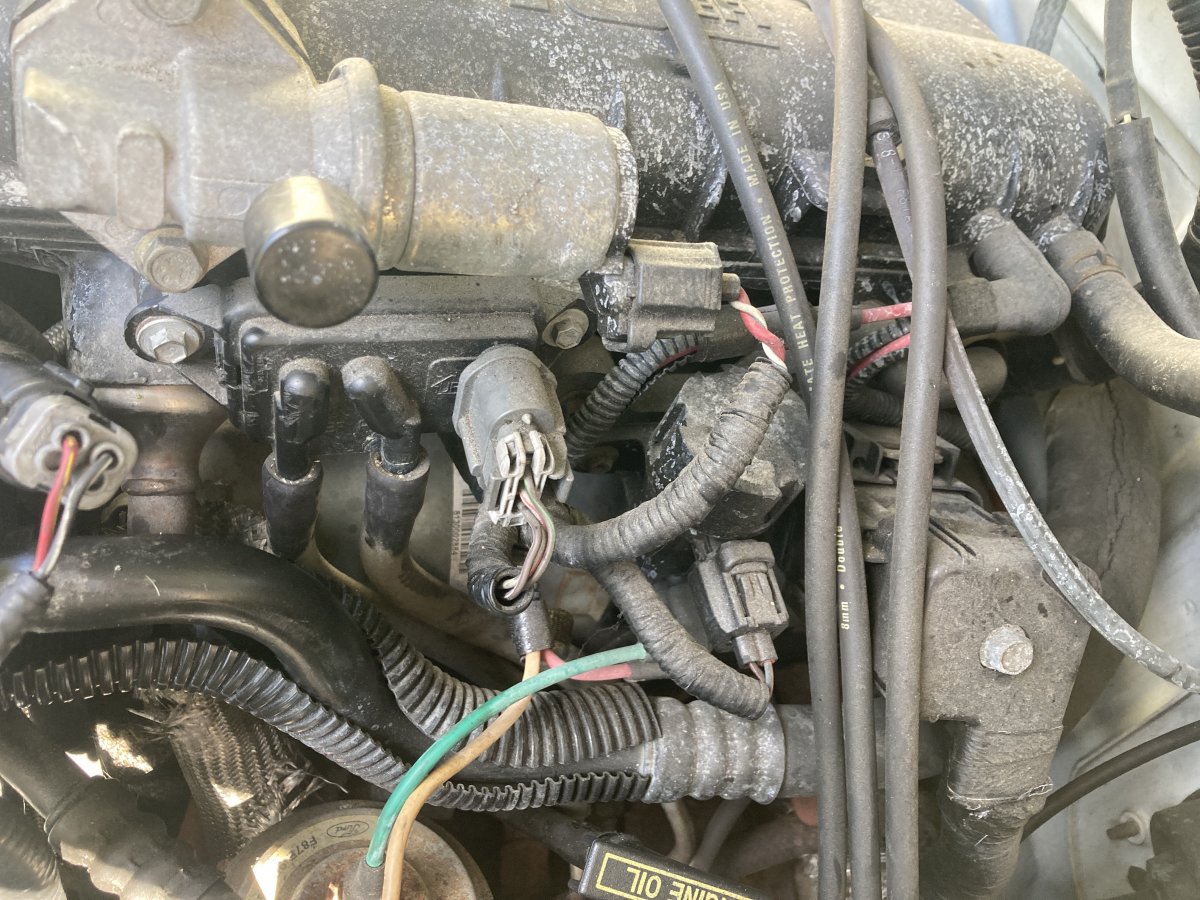

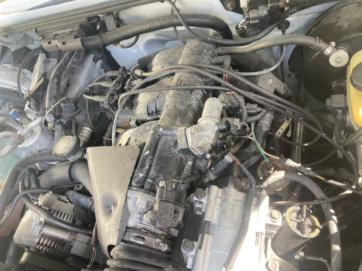

Please post a picture of your engine showing front of valve covers.
Yeah, it's sohc you are correct . Did you compare rockauto part numbers to what you have?

Yes, unless it's missing, the SOHC has a moderate sized plastic cover over it that reads SOHC, is pictured below. You need the longer 88.(n)" belt.
Here is a picture of my OHV Engine
