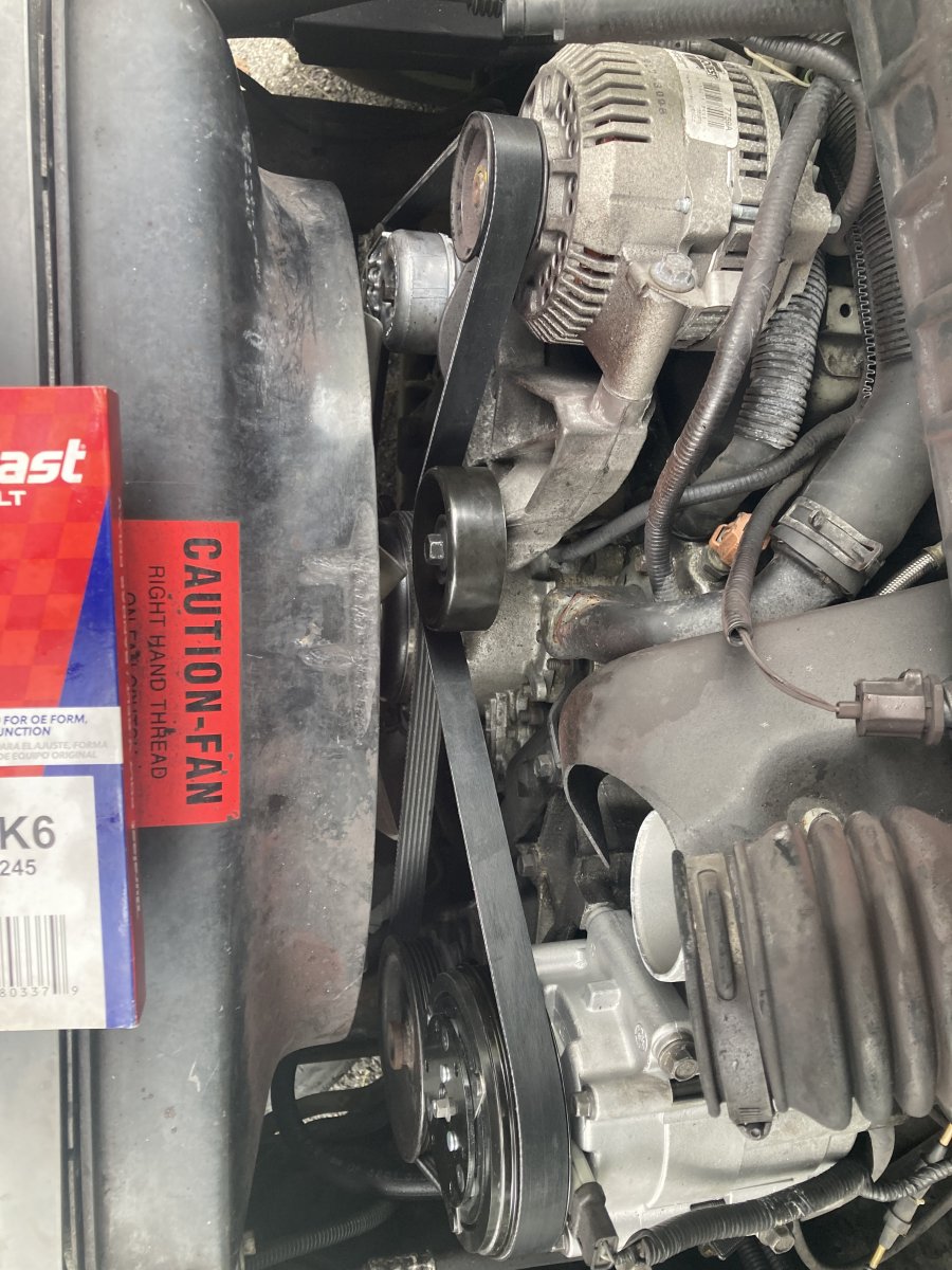

So, I changed things up again this morning while doing some more research into the the differences in the length.
One strange thing I came across, that I did not think about, was that there is a belt for Explorers withOUT A/C. I've never heard of not having an A/C in one of these...but I guess it could be a thing...or someone removed the A/C from their vehicle.
Anyway, back at my research, I came across Advance Auto selling a Dayco Serpentine Belt Kit (Serpentine Belt, Pulley and Tensioner) for $35.60 + shipping. Factor in a Labor Day discount code for 20% off and some Gift cards I had lying around and this was a no-brainer. Everything else is going back to Amazon and I'll just go with this Dayco setup for now.. I verified the length of the belt (88.25") and should fit. Heck, just the Belt itself at Advance Auto costs $43. Thanks to @J_C for letting me know the size was in the part #.
In the end...I guess this initial screwup in the sizes was a learning experience that I hope others may find useful in the future and I was able to save a few bucks in process over buying all of these parts separately.

I appreciate you helping solve my belt length mystery. One thing I’ve found makes it easier is this time I used one of those belt grabber tools, it was about $15 on Amazon. And everyone with the 4.0 probably knows this but I didn’t the first time, Is that when routing the belt, put it over the top smooth idler pulley last, because it’ll just slip right over the edge. When I changed one the first time I tried putting it over one of the other ones last and it wouldn’t go over the sharp edge. Also I’ve noticed the belt never seems to wrap around the water pump quite flush, it always seems to gravitate toward the fan. As long it’s on there don’t worry about whether it’s centered, it should correct itself when you drive it. I do have a serpentine belt tool but didn’t need it for the explorer, I just used a cheap 3/8 ratchet. In my old expedition I went through a lot with the serpentine belt, it broke while I was driving due to seized ac compressor, another time the top idler pulley fell off while I was driving. It turned out it was because the bolt that the pulley goes on was partially broken. With the expedition also, I used a serpentine belt tool but actually needed someone to hold the tensioner down all the way for me while I put the belt on and off. With the explorer it’s been pretty easy to do it myself.
88.3 inch Belt went on no problem.
FWIW, the Motorcraft belt I used (went on fine only after using the belt tensioner tool with its extension) is the one for air conditioned Explorers (98 XLT) The Motorcraft part number is XL2Z8620DA
