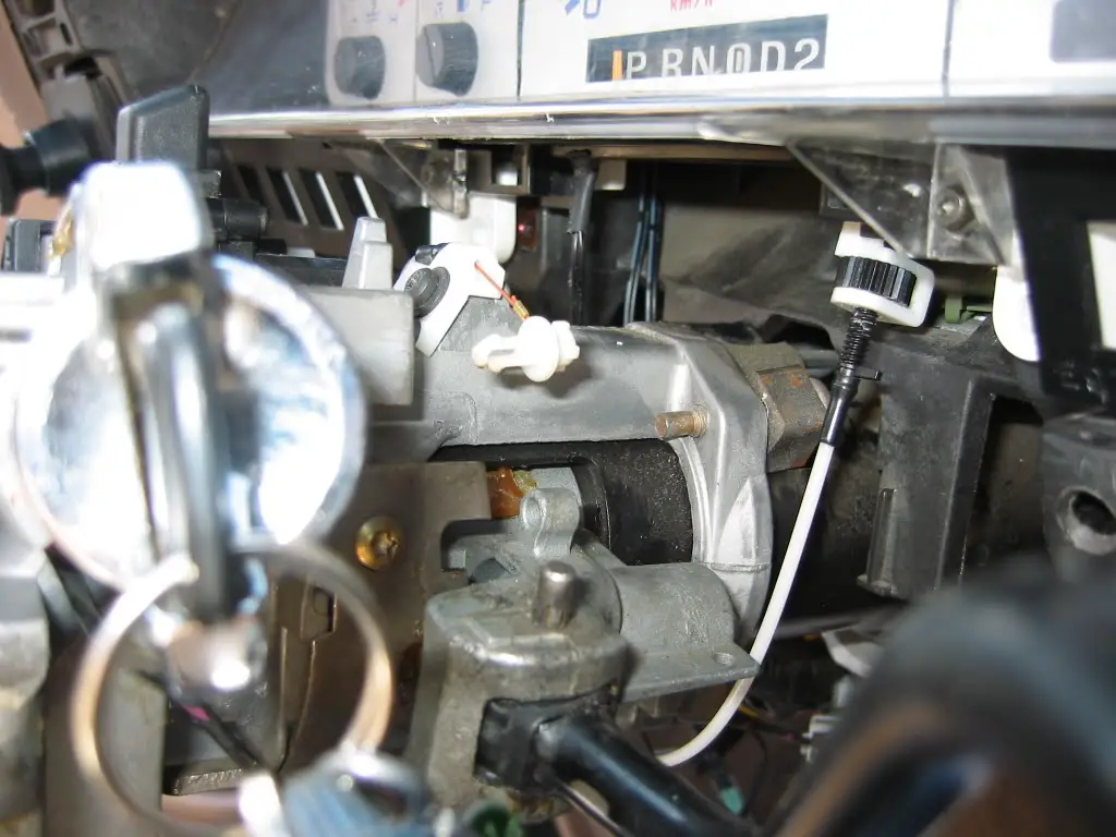

the indicator at the dash has an adjuster wheel in the steering column, this will get the needle pointing at the correct selection

The dash incdicator is a seperate issue, basically I am getting at:
UNhook shift cable at transmission
Shift trans into N BY HAND
shift column shifter into N
Re-attach shifter cable at transmission
Have somebody shift the column shifter through all gear positions, ensure the trans is shifting into all gear locations
Now youcan get into the steering column and adjust your dash needle

Hi and welcome, you have to dig a little to get to the shift indicator cable adjuster.
