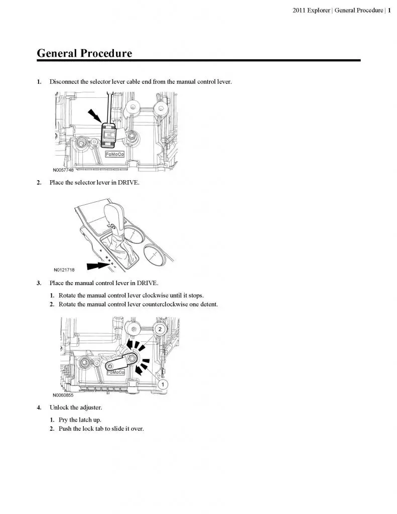

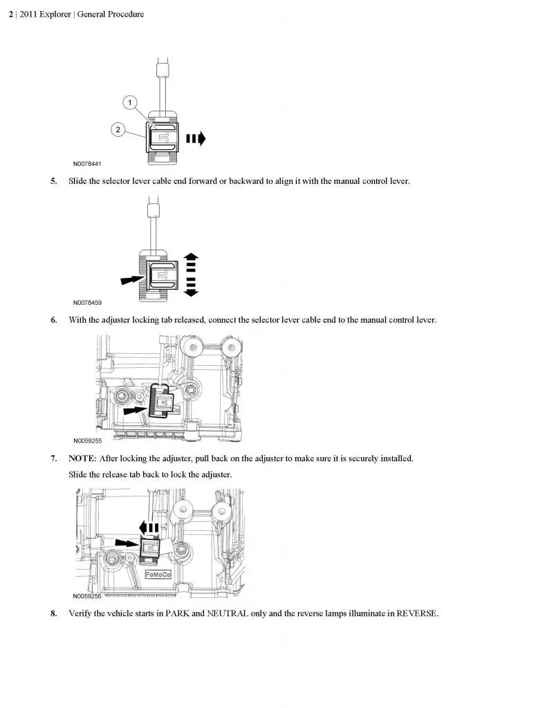

This actually helped, and after reading this, and digging up the repair procedure... SUCH an easy fix. Literally, a 10 minute job to fix this, and you don't have to replace ANYTHING!
First the BCM Message:
BCM 6535 - 2011 - 2013 Edge / MKX/ Explorer "Shift to Park" Message While In Park
2011 - 2013 Edge/ MKX/ Explorer "Shift to Park" message may be displayed with the shifter in Park if the shift cable is not correctly adjusted. Follow the shift cable adjustment procedure in the work shop manual section 307 - 05 to correct this condition. Remember that the shift cable adjustment is always done with both the shifter and transmission in Drive.
Now that all being said. Here's what you need to do.
Note: The Selector Adjustment is located JUST beneath the intake pipe from inside your hood, which Is why you need to remove it first. Once removed... easy peasy.
1. Remove the Intake Pipe which is the pipe that connects from the throttle body to the MAF / Air Filter box. If you don't know what this is, you shouldn't be doing this yourself in the first place This is connected via 2 flat head screwdriver adjustable hose clamps, and also has 2 ventilation tubes attached to it. One on the left side of the tube which comes from the crank case. And towards the throttle body connected via a small little resonator box also attached to the tube.
Now that that's out of the way. We can actually perform the procedure. Here it is Work Procedure 307-05:
After this put the intake pipe back in place. Test everything out to make sure you're golden. Congratulations.... you fixed your car in about 10 minutes.
