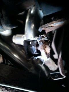

Ok its the shifting cable at the bracket at the firewall.. Really dont have the 75 dollars right now for the **** cable.. What it was is the plastic piece that goes over the ball has just wore out.. was to big.. SOOOO... metal zip tied it with pressure.. shifted through the gears. KNEW it would hold for a LONG period of time.. just for pressure... SOOOO fabricated a bracket up to put around it, so it couldnt pop off!! Cleaned up the rust so there would be fresh metal to weld to and bam.. nope no tension. feels like stock. so here it is!
Top view looking in
Out side view...
Close up of finished job
