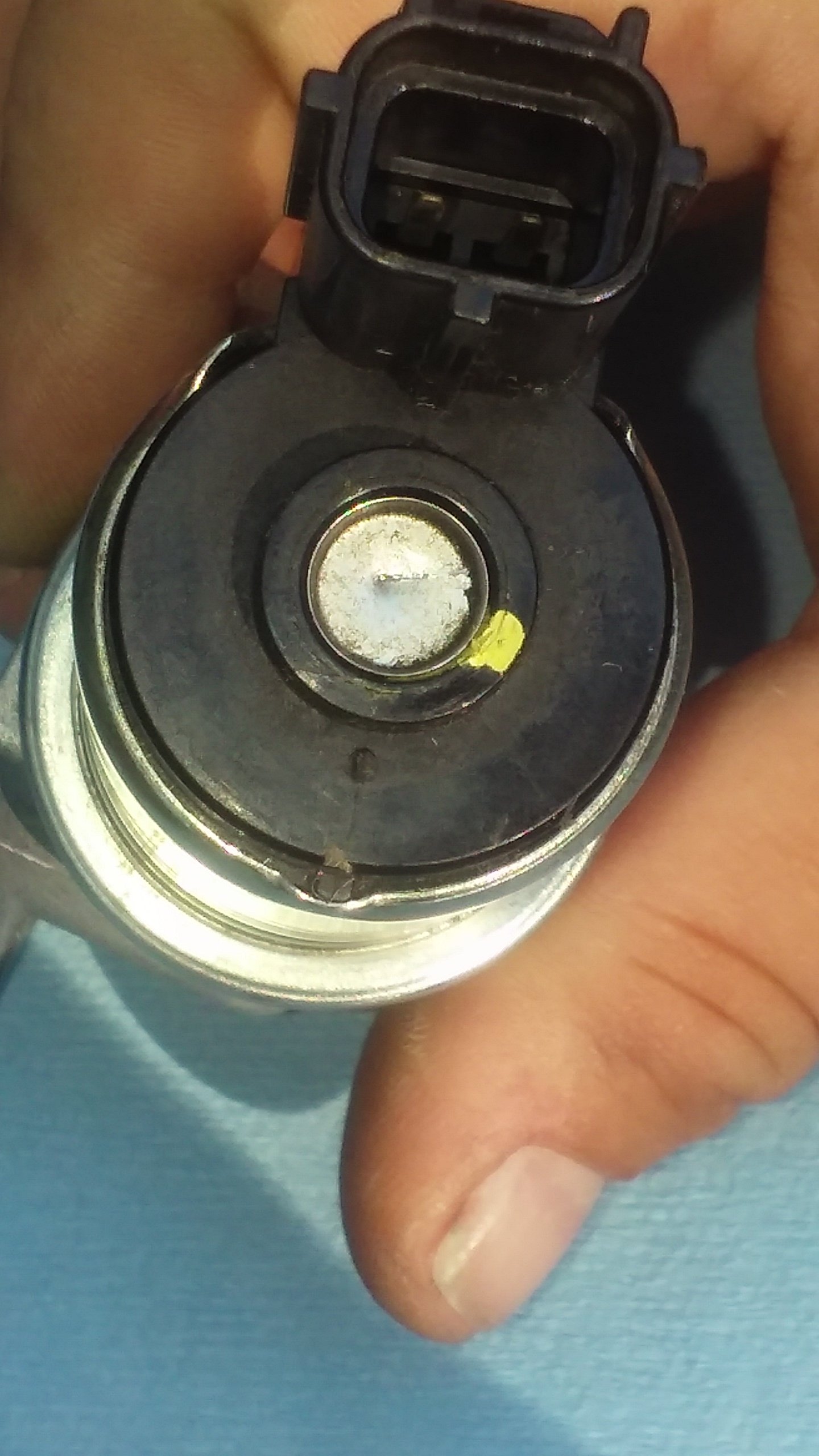

Ok so I got it
Here is how
I popped out the plug with a pick
I dented it a little bit very thin
Then I marked the factory setting witch was 3.5 turns out
Very interesting.
My final setting was 2.75 turns out
I had to play with it
In order to get it correctly set
I turned it in all the way started it barely ran
1turn out idled fine
Restarted flare to 900 barely started
2 turns out perfectly started
Now to deal with a.c. and it in drive stopping at lights I adjusted it a little bit at a time
To 2.75 turns out
Now it starts flare to 1200 rpm idles down to 650 rpm as always
the iac compensates for idle and a.c.
And if I snap or hold at say 2000 rpm it recovers faster no stall no hesitation
I couldn't be happier

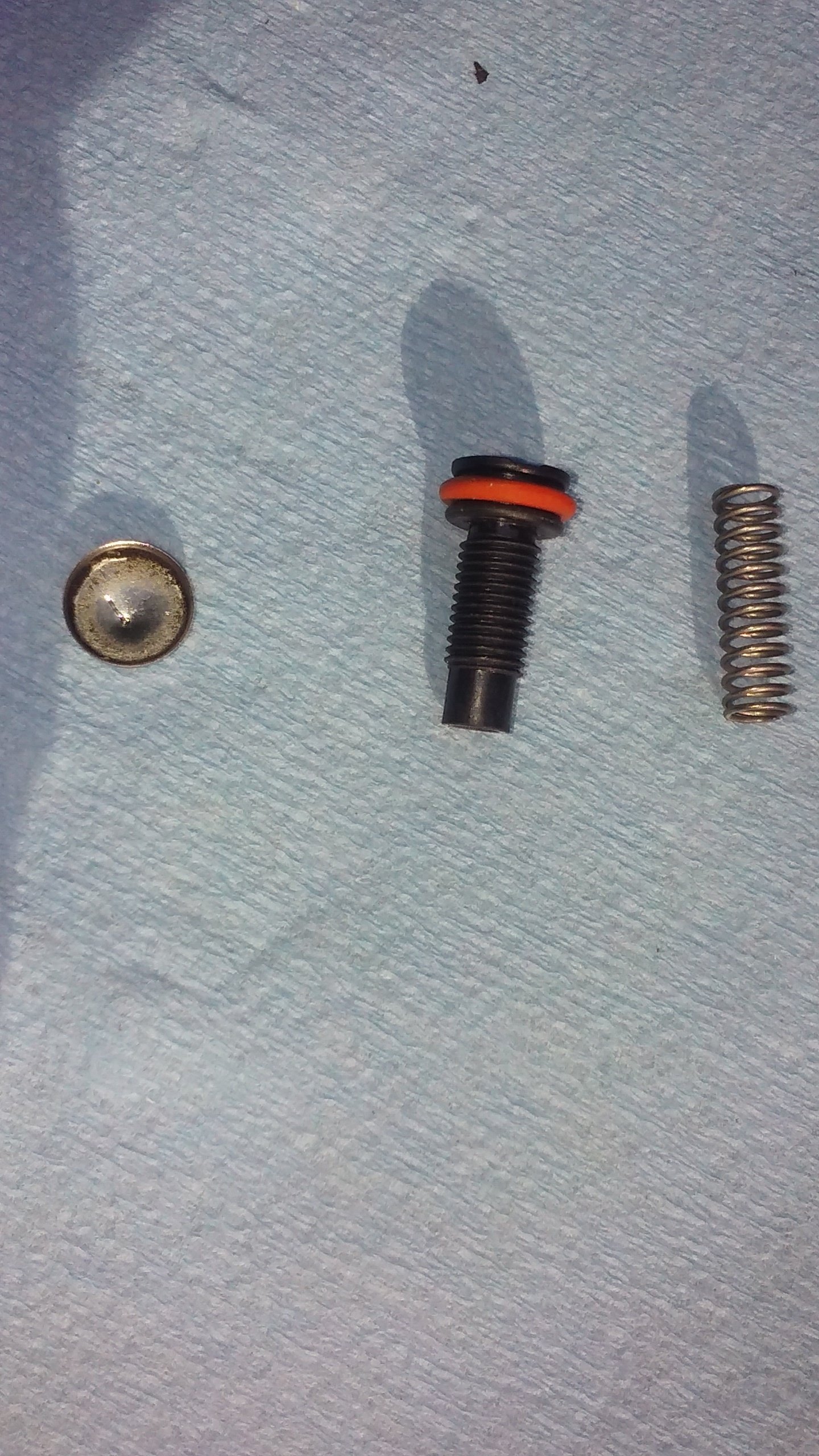

turn the screw in all the way
It seems the screw only adds spring force to close the valve
But
If you say turn it in all the way the valve solenoid
Can still have full range of movement just with more force closing it ...not all the way ...
Very nice!
Very nice!
I knew there had to be a way to adjust it
But the cheep o looks a bit different but still is adjustable
Manufacturers ahh
Yours looks more robust than mine (2001 4wd sport trac) I screwed the screw in and it did affect the flare (reduced it from 1200 rpm to around 900 rpm) on cold start up, that's after pre oiling first. My pre oiler uses a gear pump, oil from sump through filter and into engine. It works really well.

Otherwise I have nothing else to add here..... very happy to see the IAC adjustment is possible.. I could have used this a time or two! One truck we fitted with a IAC adjuster plate dealio with a allen set screw you could adjust the amount of air bypassing the iac, an old mustang trick. I like this new method way better. Good job @donalds
