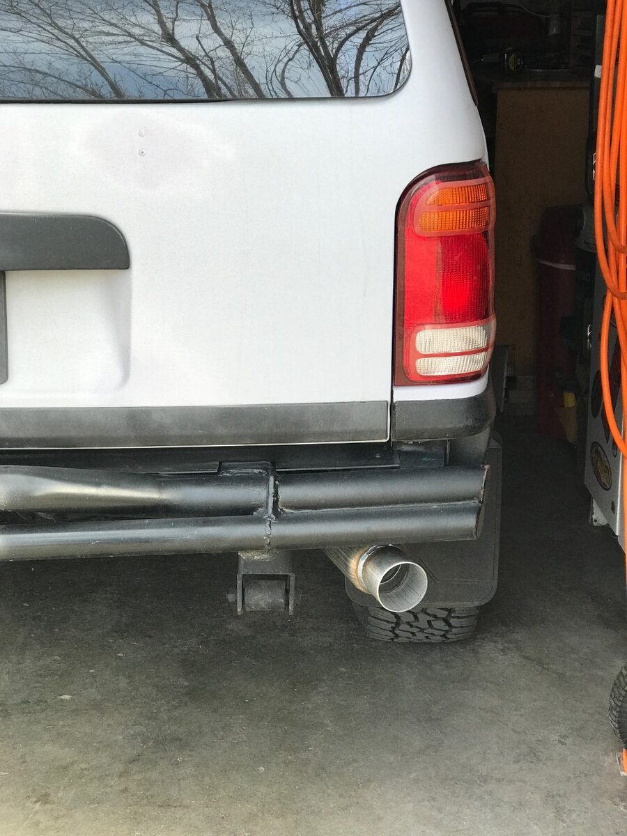

I slapped the 15" glasspack on. I wasn't sure of fitment, but It did fit at the end of the tailpipe so I put it there vs behind the muffler. It is just enough to take down the sound a few decibels to my level.
