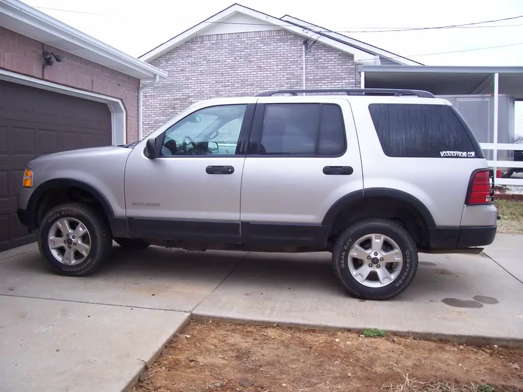

here is what it looks like with a lift and 245 70 17's
What size spacers are those? I think that looks really nice. I'll just wait another 40,000 miles for the body lift lmao hahah. And yes I can do all the work myself. But thanks for the input guys.
