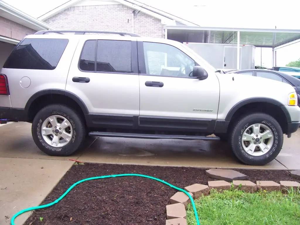

Using jutgin's x, I did a quick photoshop usings my truck. Note that the orientation is slightly off because of the angles of the pictures but its pretty close. How's it look? I personally think it looks nasty.
THAT LOOKS GREAT!!! nice job photoshoping, dang i wish i was that good
Thanks dude. I agree, I think it'll look sick once it's done. Now i just gotta figure out the tire situation.....:mad:

By nasty do you mean they look good or bad? This annoys me to no end.....how hard is it to just say what you mean? Being a big fan of grammar, I'm taking this to mean that you don't like the way it looks. In that case, don't do it...:rolleyes::rolleyes::rolleyes:

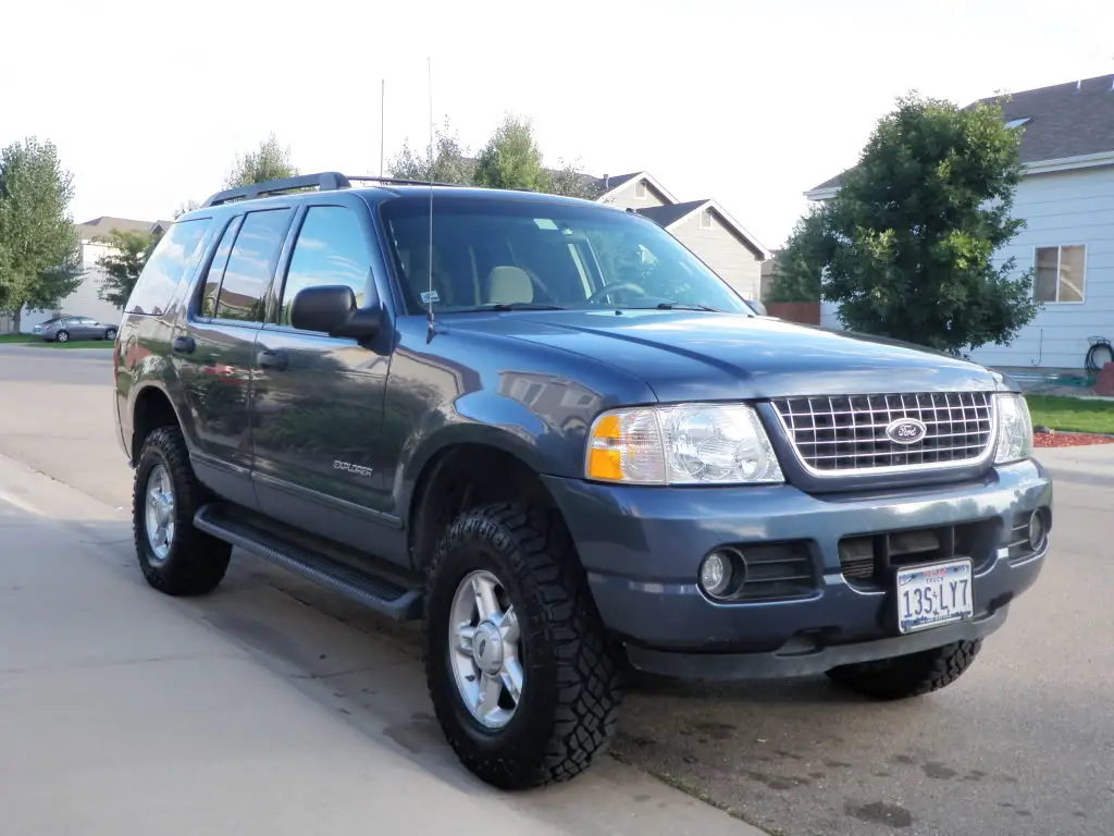

Here is mine with 265's.

This is my Ex with a 2.25" front spacer and a 2" rear spacer. Tires are 265/75R16 (32"). You prob don't want to lift it at all if you want to keep the tires you have. As for the start of this thread about levelling, you DO NOT want a bigger rear spacer than front if you go ahead with it. Please note my back end is still higher than the front and my front spacer is 1/4" bigger.
My opinion, if you want to keep your tires , leave it alone. If you are willing to fork over $$$ for new rubber, lift away. With my lift being what it is, I'm moving up to a bigger tire because I think my 32's look too small. Hope this gives you some assisstance with your decision.
