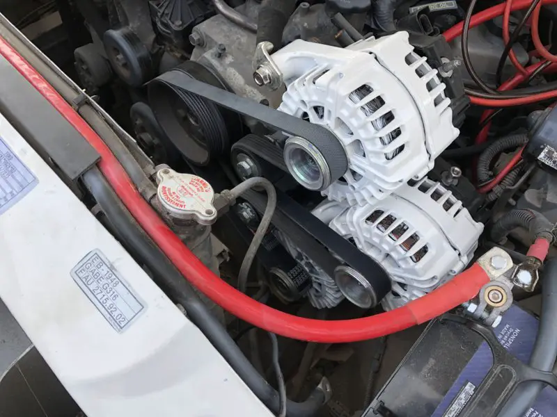

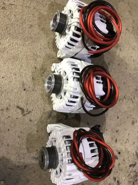

Added alternators? Do you have a write up on how you did that?

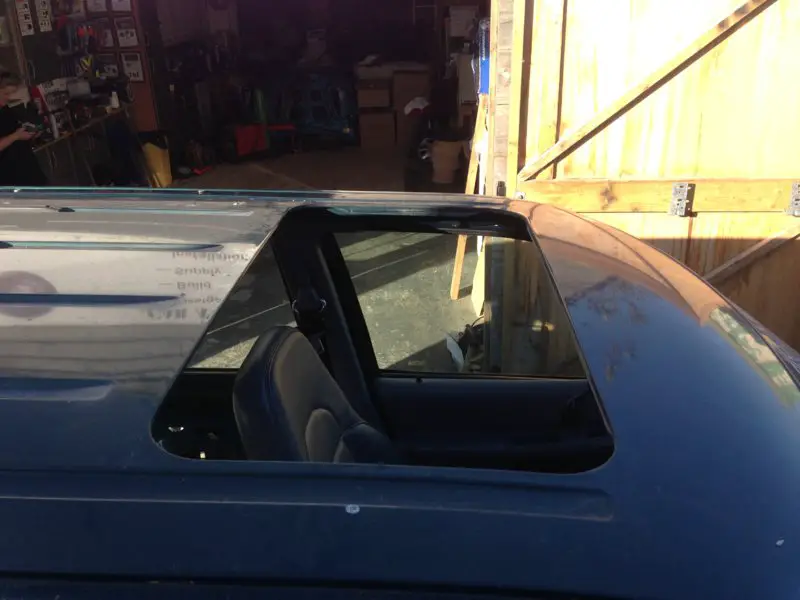

Very cool. I like the filled sunroof hole too, I've wanted to do that for my 93 for years.
The alternators are situated where the AC pump normally is we started by the fabrication of a 4mm steel plate that bolts to the engine using the AC pump mounting holes then it’s a case of measuring and lining the alternators in place and fabricating the loops to bolt through to hold the alternator on to the plate, as for the pulley system we used the old clutch pulley from the AC pump and cut the centre out and welding steel to fill the centre then drill the holes required to bolt onto the power steering pump pulley to make a double pulley so the added alternators run off a separate belt with two belt tensioners to keep everything where it should be

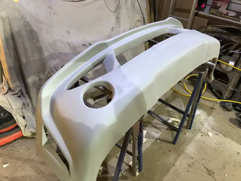

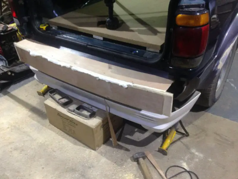

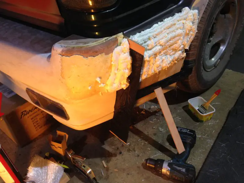

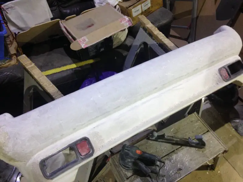

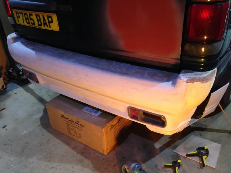

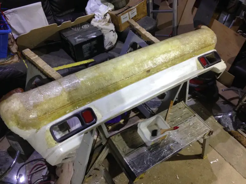

Due to the lack of after market body kits available in the UK for the explorer we had to take things in our own hands and make one ourselves
We used the fog lights and reflectors fro the factory bumper and fixed them into the new

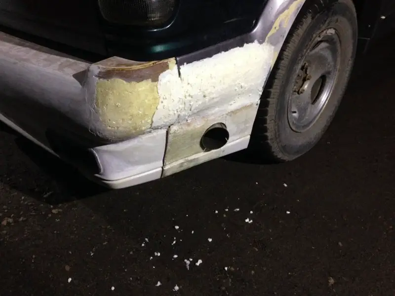

lots of fibreglass work and filler to get the shape we were after t
then it was time to blend the new bumper into the factory body kit aches we were

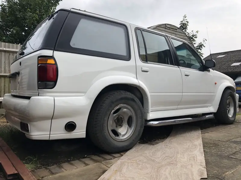

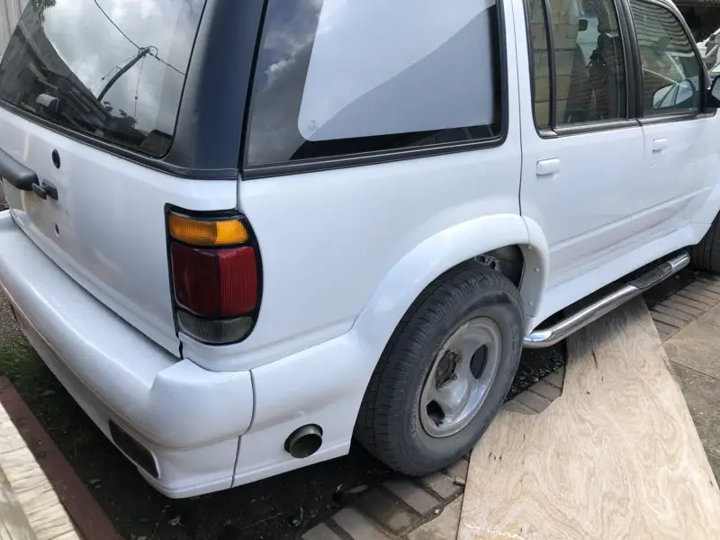

we then fabricated the exhaust to exit behind the rear wheel through the bumper

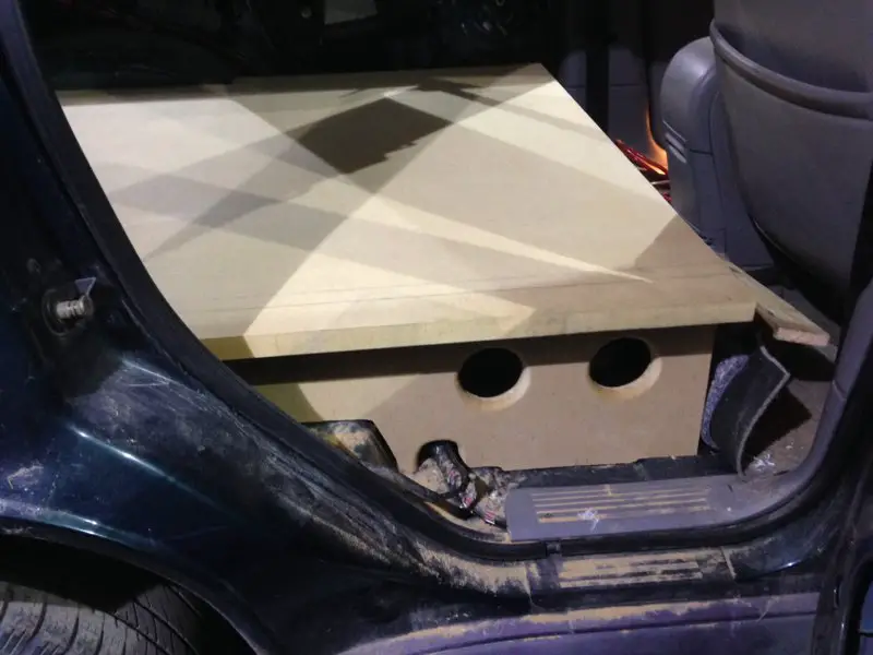

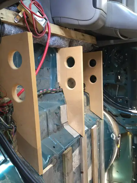

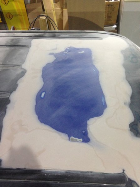

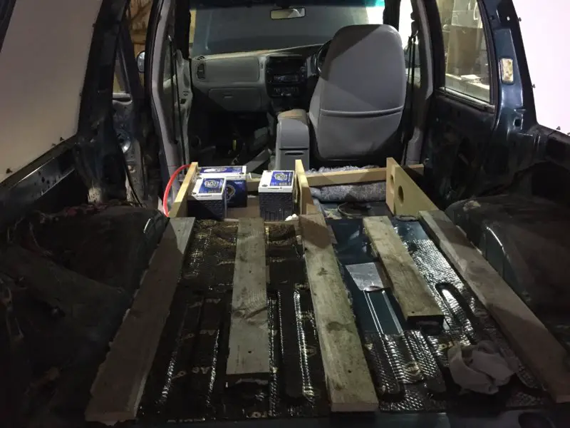

As the audio in the vehicle is on the large side we had to strengthen the structure after welding the sunroof up we then started adding 30mm(1”) MDF bonding it to the roof a total of three layers where installed type type
the floor is also covered in the same, this gave us the top and bottom of the enclosure we are to build to house the speakers.

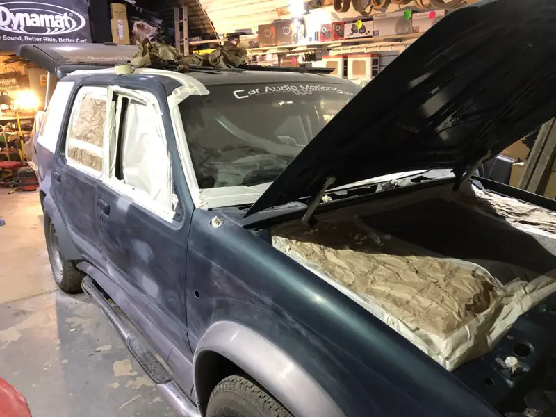

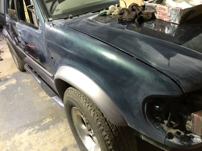

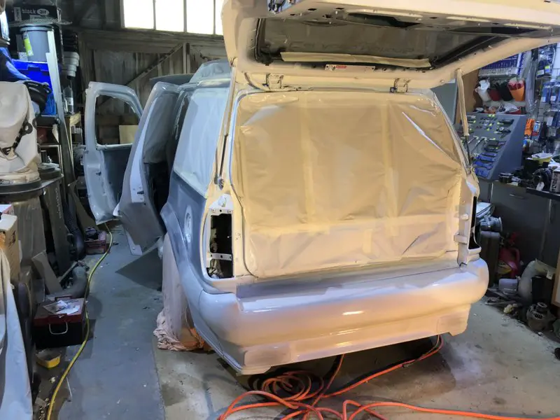

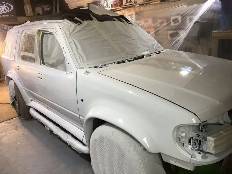

As for the final look of the exterior we wanted something that would stand out but not outrageous after looking a vehicle on the road that stood out from the rest we decided on ibis white this is VAG colour used on the Audi R8 and RS models and seems to be a very bright white so we began the preparations for painting
Final presentation on the bumpers and kit then mask everything up and spray the door shuts
Then the main part spraying the bodywork

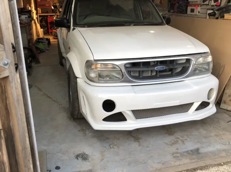

And what a difference that made the colour makes it look bigger and when the sun shines on it well we are more than happy with choice

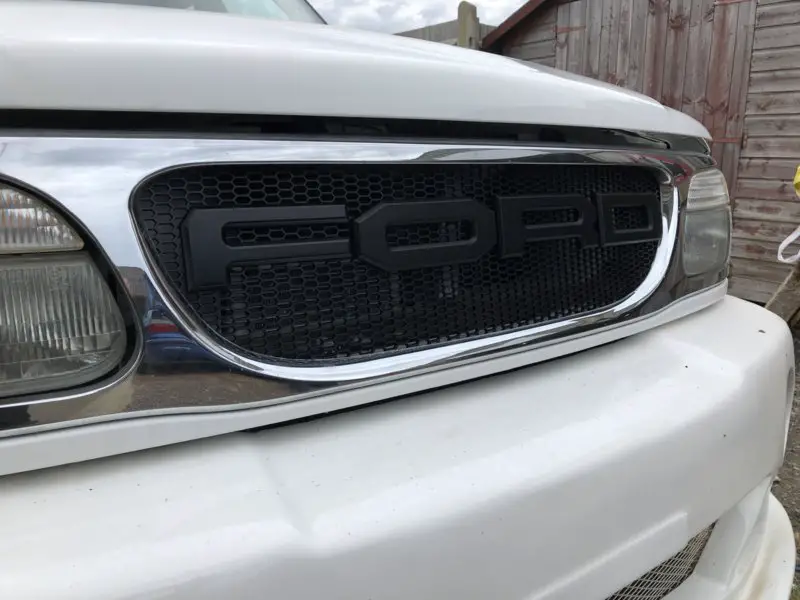

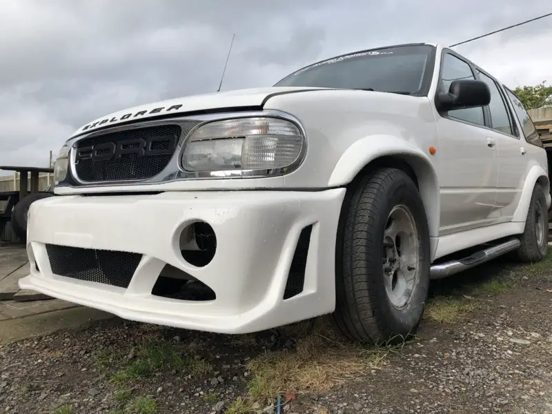

Then it was time to bring the old truck up to date with a custom grill cutting around the moulding line of the factory grill and fixing some plastic mesh and the modified ranger ford lettering
Then adding the 2018 bonnet lettering just a good polish up and some extra lighting here and there and the outside is done
