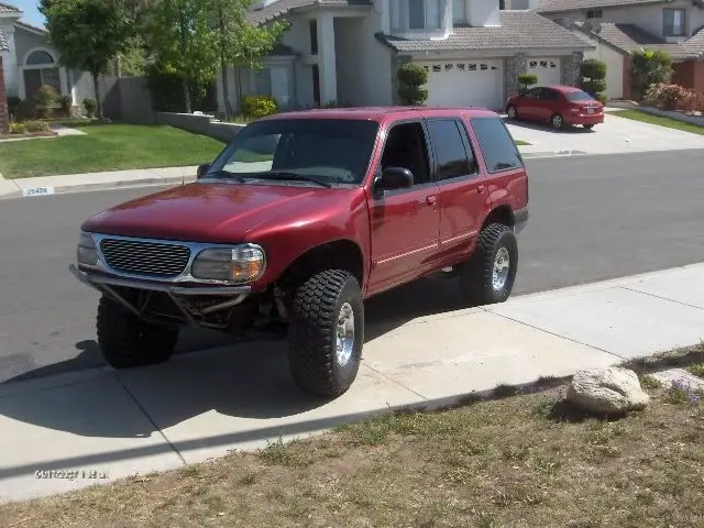

Tucked skinies
Here`s what it was, now all in pieces in my garage to be reassembled bigger.
attachment.php
Image with likely 10 . 5 wide perfect.;)
spindles
lift involves, a 3 inch body lift all around, 2" torsion twist for front, 1" key fro front, 3" deotsch spindle lift for front, and rear is spring over axle and shackel extensions.
Wear did you get the spindles did you need anything while installing them and wich ones did you get and what year is your st i need to know everything you did with your spindles and which ones :rangertan:

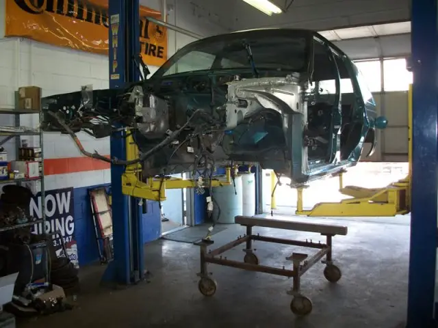

Went and bought a 97 donor, rust free body, blown head gasket on the 4.0L sohc and 2wd. Gave $550 for it and cost about $60 in fuel to go get and trailer back. Was brought up from down south 2 yrs ago to Michigan.
9am
Around 10am
About Noon
1pm
3ish
5:30ish
Ended up transferring all of the under hood harness from the 98 to the donor 97. Swapped dash from 98 to 97. And ended up having to swap the entire body harness from the 98 into the 97. Spent almost two hours chasing a ####ing ground to get it to start. All I have left to do is reassemble the interior (carpet and seat, dash already in) and mount the front bumper. But I will do all that at work, it is driveable as is.
Previous owners on the 97 are nothing short completely DISGUSTING, interior was so trashed and gross. Taking 90% of the interior from the 98 and installing into the 97 to replace the gross ****.
I think in the end the wife is getting to dd the green ex (mine) and I am gonna dd the new black ex. The body is in excellent shape and I think I am gonna black everything out and make this one really nice. Leave the green one as is and it will still get wheeled but the black one won't other then silver lake.
So ended up with a 97 "shell" with 98 frame, engine and all related components, all wiring from a 98, and all interior from a 98. So other then the vin it is pretty much a 98 still.

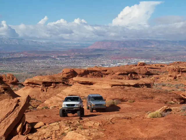

Mine!
Heres some of my filthy junk...
