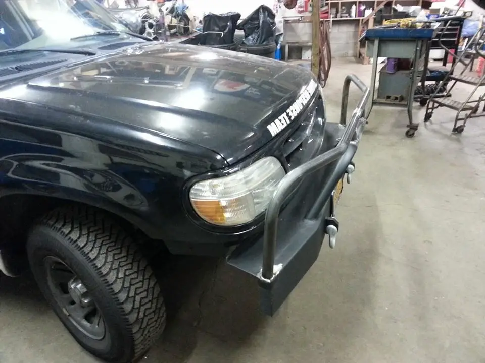

in the pic is that your third gen explorer the bumper is what i would be looking for so if you dont mind telling me:
Who made your bumper and were can i get one also how much?
Fled bought it from a guy who had it custom made for $1070
So i assume most of you third gen guys have seen my bumper :p:
Now it is not for sale! but... i wanna hear how much you would pay for the bumper (with winch) ?
My Fab guy was debating making more. [ POSSIBLY ]
I paid 1070 for the bumper and 330 for the winch
What would you guys pay????

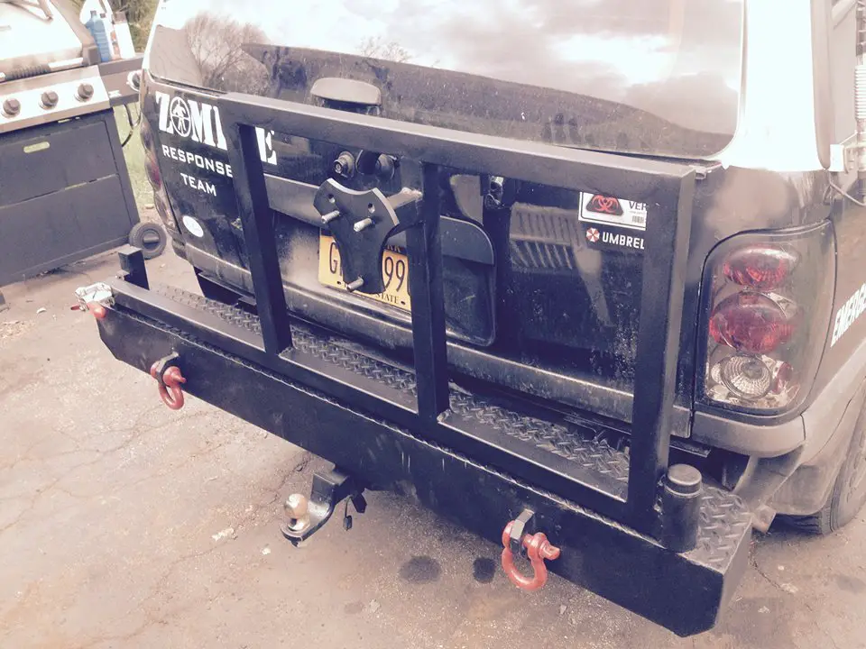

I also like your bumper where can i get one an how much did it cost?
I built that one. Aside from a custom fab shop I haven't seen any off the shelf bumpers for newer explorers.

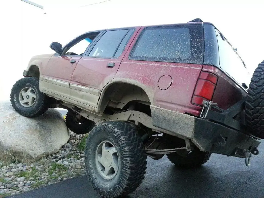

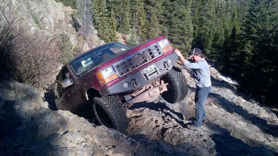

I figure I'll post an updated shot of the front bumper (old pic got lost) and some shots of the phase 1 of the rear bumper (before tire carrier).
Custom Tube bumper with d-ring and lights 1 by maniak_az, on Flickr
Custom Tube bumper with d-ring and lights 2 by maniak_az, on Flickr
Custom Tube bumper with d-ring mounts 1 by maniak_az, on Flickr
Custom Tube bumper with d-ring mounts 2 by maniak_az, on Flickr
The front bumper is the weaker of the 2. The front is made from 1/8 wall steel and the mount is a piece of 1/8 plate on each side of the frame. I've lifted it using a high lift and hit it a bunch of times wheeling. Still holding strong.
I did pull the tow hooks that were bolted onto the bumper (with the mount bolts) and made 1" thick d-ring shackle mounts.
The rear bumper is 3/16 wall tubing and the mount is 3/16" thick plate but it is only on 1 side of the frame (its not boxed). The shackle mounts are 7/8" thick and are welded to the 3/16" bumper/frame mount.
All of the tubing is 2x3" square tubing...
I made this style since "my thinking" is if I can get a tire on it, I can climb it. I don't want the bumper to stop my tire from getting to an obstacle.
~Mark
