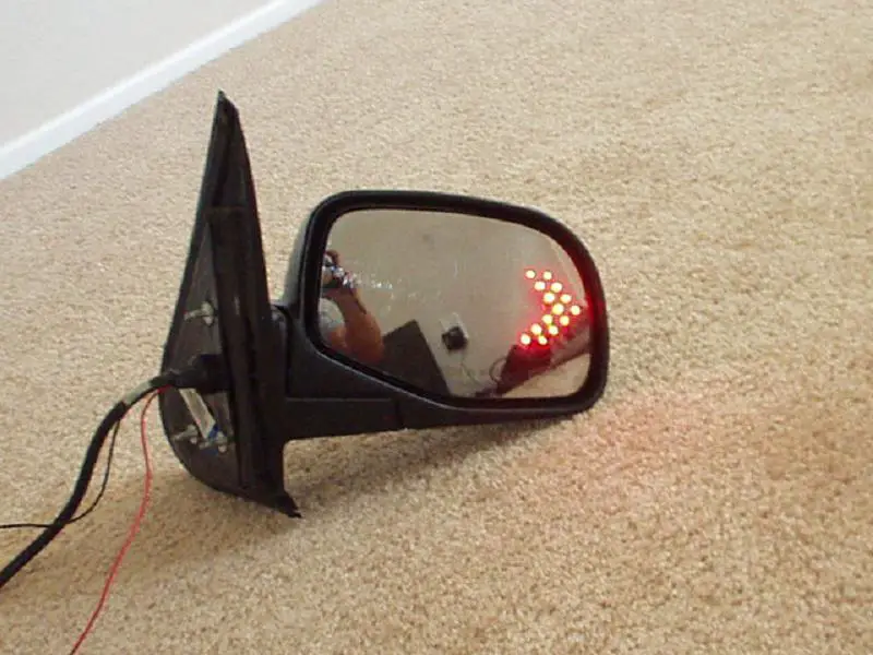

I found these LED's made by Shark Racing and was wondering what you guys think. From their YouTube video they look very easy to intall. I think the only difficulty would be the actual wiring. Here's the link.

All you have to do is seperate the glass from the plastic cover on the back. The hardest part is running the wiring and finding the proper connections to the turn signals. I am going to order the LED's hope to get aroundd to it within the nex two weeks when I have some free time.
Seems like you'd just need to get it out of the door, run through firewall or however to engin and splice it in with the turn signals, or hopefully there's a less complicated way
I've really wanted to do this for a long time, I ordered them up so when they come I'll post up a review.
I dont always do things the best/easiest way but, snaking the wire from the mirror theough the door to the interior was a real PIA. Can be done but its a *****.
You can hook the wires to the wires for the rear blinkers in the door sill channel. Although I just ran them to the front blinkers thru the firewall.

Here is the finished product installed...
scrogathon, please note that the wiring in Bob's post many diiffer from your 97. Ford changed alot of the wiring colors from model year 98 to 2001. Model years 95-97 are the same. Did you have any problems with this vendor? How long did it take you to get them from time of order until they arrived at your door, and how did you recieve them... FedEx, USPS, UPS?
I didnt have any problems with them, the package arrived with just a postage paid sticker and my address so Im not to sure what method it was sent but it took around two weeks to arrive, was packaged well and came in an anti static bag.
I chose the amber color to match my rear signals.
