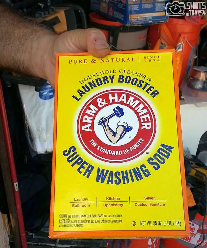

The secret ingredient (Do Not use Baking Soda)
..The active ingredient is Sodium Carbonate.
