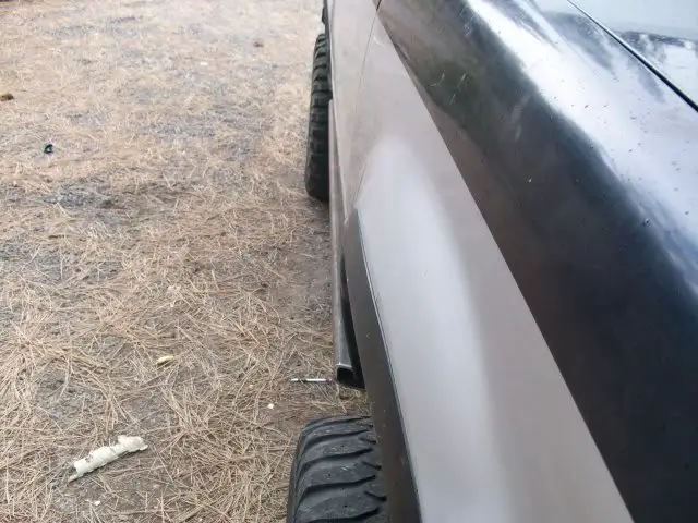

I've been quite busy lately armoring my truck up. So without further ado... Here are the beginning of my sliders.
Mock up with fenders hanging still.
Passenger side on and ready to be end capped, grinded.
Passenger rear mount, Not the prettiest weld but talk about penetration... there are burn marks on the inside of the frame...
Looking down the side, gonna be useful for door protection, and steps...
Floppy Fender fix, welded in a 1 1/2"x1" T bracket to the body with a nut welded to it.
These hold me (140lbs) and my father in law (260lbs) standing on it and also jumping on it.
