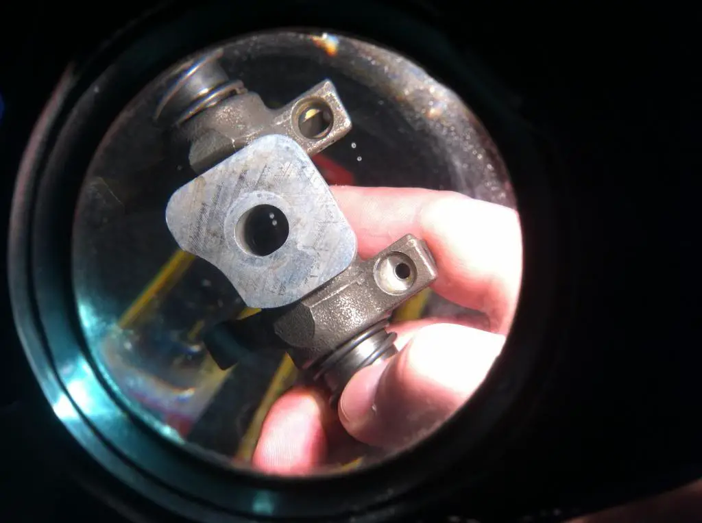

Here is the sound mine was making you can hear it in the video. The 4L OHV has rollers on the lifters, but as you can see in these pics my pushrods and rocker arms were worn out causing the pushrods to have more play and that tapping noise. This probably happened when the oil pressure changed when my head cracked and let coolant into the oil. I hope it is not the problem you are having.
those dont look that worn at all.need to show the other side where it hits the valve, thats where most wear happens
If you look at the arrors in this picture you will notice that the holes on the rocker arms are larger on one than the other. It is because friction has cause the pushrod to widen the hole in the rocker arm and started to push the rod through the rocker arm. This makes the rods loose and gives it the ticking noise that you can hear in the original video that I posted.
In the first arrow you have a rocker failure that is uncommon but is a problem for delta rockers also.its rear and typically doesnt happen on stock rockers....yes wear occurs in the pocket and to the tips of the rods but as long as the ID of the cup is smaller than the OD of the rod it can not ""push through""the other side is where most wear occurs, the pad and valve tip wears fast and add that with the cup and pushrod wear is when it adds up.but normally its the pad and valve tip that wears first..
Notice in these pictures of the pad wear.also the second picture is a picture of two BRAND new rockers just different companies. .the holes are different, the one with the larger hole is the better rocker made by sealed power..trust me I know the insides of the OHV better than I know myself.
This is what happens like in your case when the cup is casted to deep or is drilled to deep (in delta case).the pushrods can wear and push through but only if there was a issue with the rocker to begine with.this was a new rocker, the ones with the smaller holes in the picture above

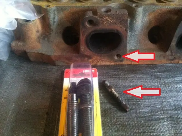

Also, have you ever had problems ordering the right size manifold studs? Mine were M8x1.25 but all the parts stores are saying my Xplorer uses m10s... Ford wants 13 bux a stud:eek: and as nice as the Ford ones are I can't pay 150 bux for a handful of studs even if I had the money.

by "studs" I meant the double sided bolts that attach the cylinder heads to the exhaust manifold.
It is pretty obvious that the ones that every auto parts store say go on my explorer dont fit
