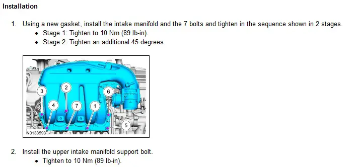

Did you re-install the intake manifold using the following sequence?

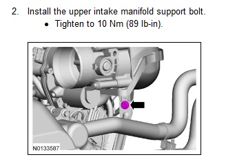

There´s also a bolt underneath that maybe you forgot to torque it. I believe it´s this bolt:

Did you re-install the intake manifold using the following sequence? View attachment 327892
Thank you for your input, I will need to try this. I have one of those digital torque gauges that fits between the ratchet and socket but it was dead even after changing the coin battery so I just went with ye olde "tight+1/4 turn" when putting the air plenum back on(with a new gasket) and the new plugs. I will get a torque wrench and see if correct tightening helps.

Got the new ForScan ODB-II dongle but it didn't throw any error codes. Got a cheapo $15 torque wrench and torqued the upper intake manifold plenum down. First bolt, snapped it loose. Got a new, less cheapo torque wrench for $25 with a good Amazon rating. Removed upper intake manifold plenum. Thankfully it was the bolt that sheared so the threads on the captive nut were fine. Called all over town on a Saturday afternoon to find a Ford parts shop with the bolt in stock. Between all the calling and part numbers, I called four different dealerships, each one saying they didn't have it and giving me a different "correct" part number to call the next dealership with. One dealership said the next dealership had it in stock, but called ahead and got it verified that while the inventory system says it was there it was in fact not, lol. Finally, the last dealership said the part number I *really* needed was 5F2Z-9Y450-A. It came in a pack of 4 but they removed two and sold it to me for $2.50 apiece(I wanted a spare bolt just in case).
Removing the sheared bolt was surprisingly easy, went after it with a tissue and screwdriver against a shard of metal sticking up. Removing the upper half of the bolt from the plenum was just a matter of a knock with a mallet. It has a captive sleeve that pops out along with the bolt.
With my new torque wrench and replacement bolt, I popped the replacement bolt into the plenum and torqued it down in rotating sequence as mentioned above(first resistance, then down to 10 Nm (89 lb-in), then another 45-degree tightening). For good measure, also sprayed down the MASS air sensor with some MASS cleaner, let dry and re-installed.
Fired up the engine and the slow, oscillating hum is gone.
