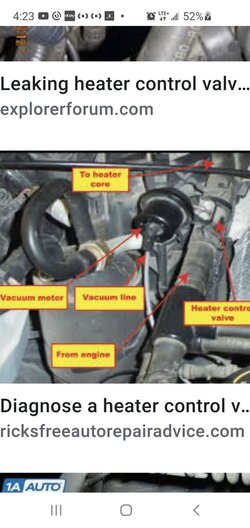

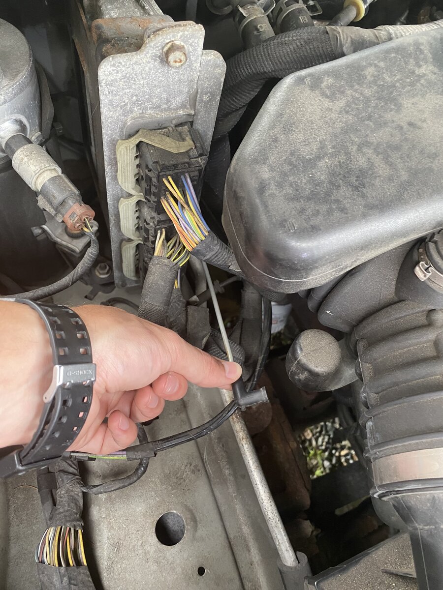

Realize this is an old thread but I think I have the same exact problem now. I found the grey line just dangling. Where is this supposed to connect?
