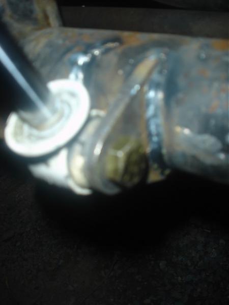

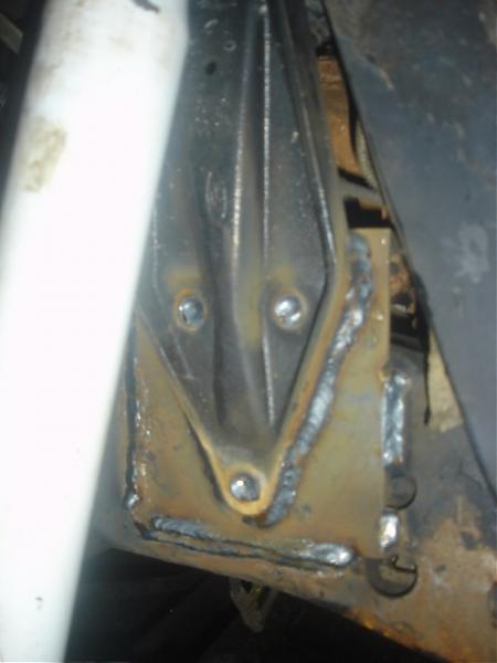

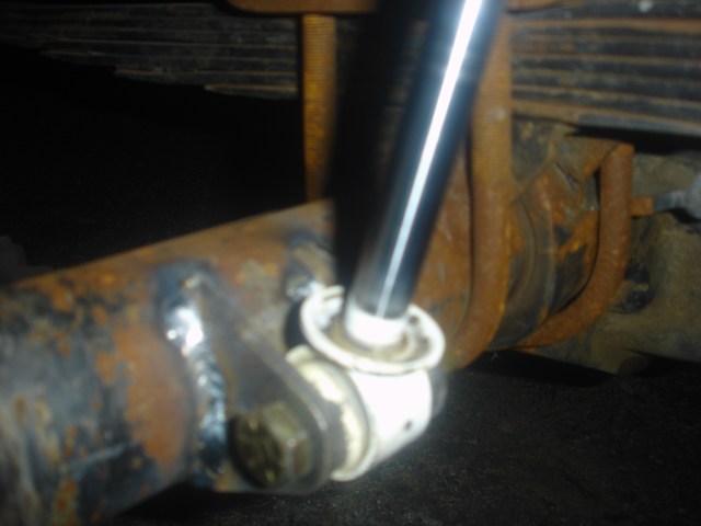

Work will soon continue, bulletproof shock towers, c4/d20 which im picking up sunday, and a sawzall once I get the stones to do it. :D
Plus all kinds of little goodies, and going over rookies welds with the tig torch.
