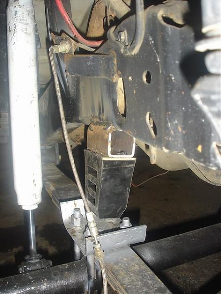

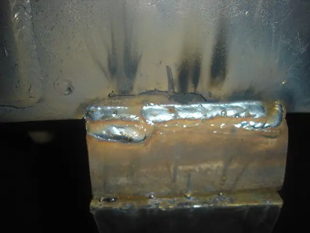

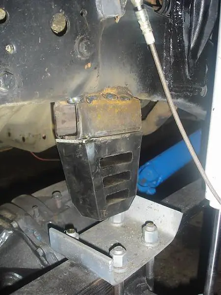

Bump stops are in as well
Excuse the welds, I had quite a gap to fill.

Good googaly moogaly... those bumpstops really ARE huge! Are you going to have any uptravel at all with those? :p: :D

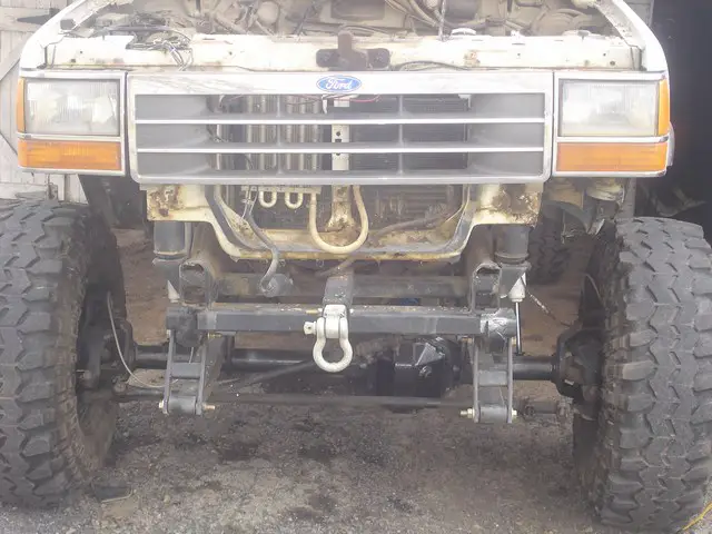

I would brace that front x-member with some flat steel triangles like this |\___/| otherwise it looks pretty good. Are you going to get highsteer at some point? Any plans for a front bumper?
what front x member? The shackle hanger isnt going anywhere... trust me.
highsteer and bumper and both in the plans, if only I was rich. Ill be starting to make a bumper soon.
Spas... the bumpstops acually work perfect on the pass side, the drivers side needs the bottom lope trimmed off.
