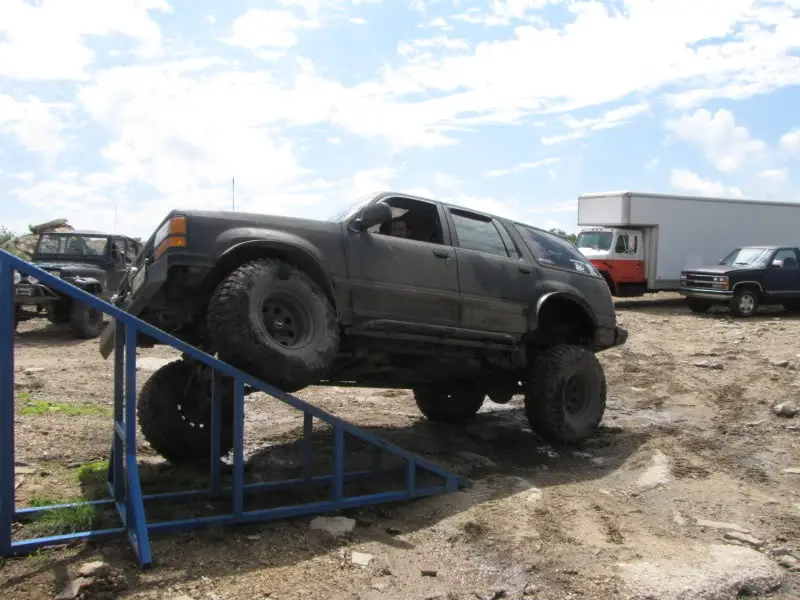

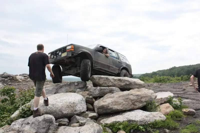

This registry is to consolidate everything to one post for quick reference. The build thread is still located at SNJ's BUILD THREAD wich will be updated as we go along as always because this truck will never be done, and is where i would like to contain all discussion of the rig
3rd Place SUV Class 2012 and 2013 Carlisle All Ford Nationals
1991 Ford Explorer XLT
Engine
• 1994 4.0L
• Custom 3” snorkel w/ Arb Head
• Dynomax SuperTurbo Cat Back
• Custom Upper Intake Manifold Spacer (1/28/10)
• 94 front accessory drive belt
Transmission
• 94 A4LD
• Dual Tranny Coolers (2 stock coolers run in series)
• Derale 10" fan on first cooler w/ adj. t-stat (4-13)
T-Case
• Borg Warner 1354 manual conversion
• custom shift boot bezel
Front Axle
• Dana 35 TTB
• 4.88 gears
• C-Clip eliminator
• Open Diff
• Warn PREMIUM (after i blew a regular one) Manual Hubs (4/12)
Front Susp
• James Duff 5.5” stage 1.5 kit
• SkyJacker 138 Springs (Added 12/11/10)
• SuperRunner Steering
Rear Axle
• Ford 8.8
• 4.88 Gears
• Ausie Locker
• Solid diff cover
Rear Susp
• SOA w/ Superlift Brackets
• Custom F-150/Explorer hybrid Leaf pack (4/13)
• Rancho 2” over Shocks
• Stock Shackles (again)
Brakes
• Stock Front
• 98 Rear Discs
Driveshafts
• Rebuilt stock front and rear
• 5/8 Billet Depot Mustang 8.8 Spacer on T-case end of rear driveshaft. (Added 12/11/10)
Tires and wheels
• 35x12.5x15 BFG Mud Terrain KM2
• 6oz Equal in tires
• 15x10 Pro Comp Rock Crawler Series 98 Black Steel Wheels
• some roughtly 35" round rolly thingy for a spare
Exterior
• Nato 3 color woodland camouflage
• Ranger Grill
• 3” Pacer Flexy Flares
• Front Fender Trim
• Lighted license plate mount on rear hatch
Armor
• Custom Front Bumper (thx explornj)
• Custom Rear Bumper (thx spas)
• Trail Gear 67” sliders
Interior
• Herculined floor
• 94 gauge cluster
• 94 Limited power front seats
• Camo Seat covers
• Bike water bottle holders on dash
• Relocated computer to glove box
• JVC headunit
• Second gen premium speakers
• First gen JBL Sub
• Ipod mount
• Overhead console w/temp+compass
• Inclinometer on dash
• Fire extinguisher on trans hump
Lighting
• 9007 headlight conversion (added 11/13/10)
• Illuminated front reflectors
• 5 ½ inch off-road lights on bumper
Communications
• Cobra 18 WX ST II Cb
• 3' Wilson fiberglass antenna w/ spring mount on r/f fender
• Motorola 2ways as primary communications
Misc
• All breathers (both axles, trans, t-case) extended to under left side of hood+ caped w/filters
• Power steering cooler (no clue what its from, found it in the junk yard and liked it)
• Front tow hooks on underside of frame rails
• Rear hooks that are almost inaccessible any time ive ever needed them, but I swear they're up there on the side of the frame somewhere….
• A/C Delete
