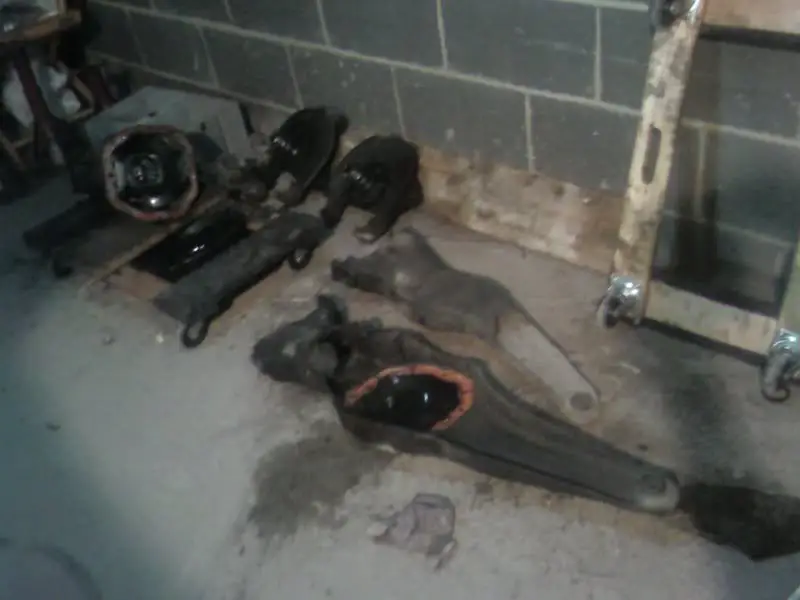

i had done this:
wich is for this:
i got this from spas:
then these showed up:
and then today i did this:
my old man came down and hleped me set the gears up. he hasnt done a set of gears since like 87, and i did a mock teardown and install of a 9" once. between the 2 of us despite the lack of math skills between us we got it all shimed up and im happy with the patern. i know he reads this stuff so im gonna drop him a shout out here cus i woukldnt have gotten it dialed in without him.

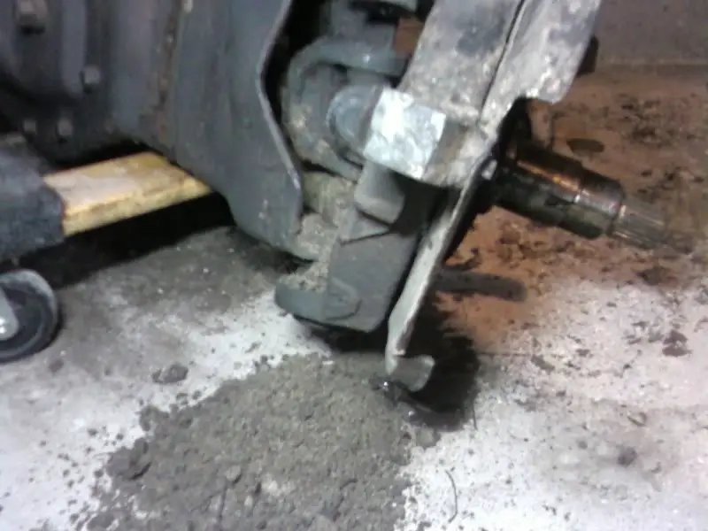

fn d35s bein a capital B-to-the-itch to get to come apart
