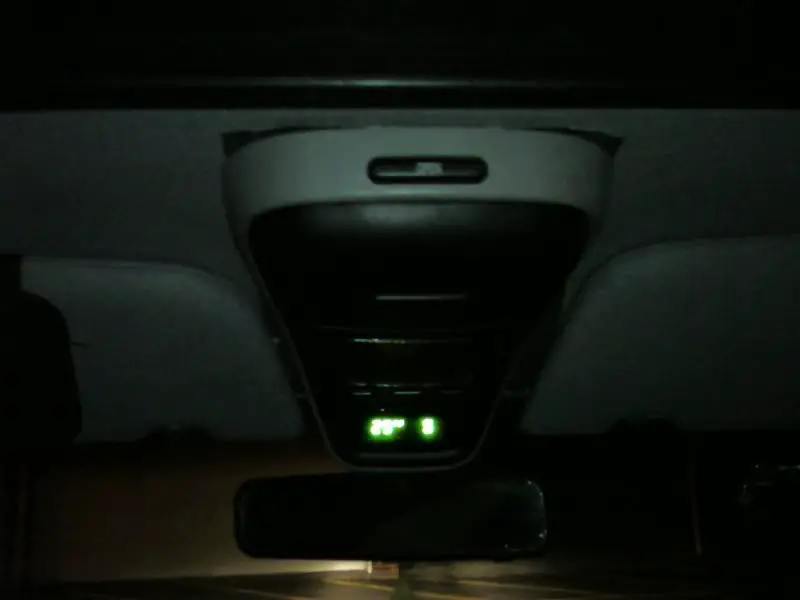

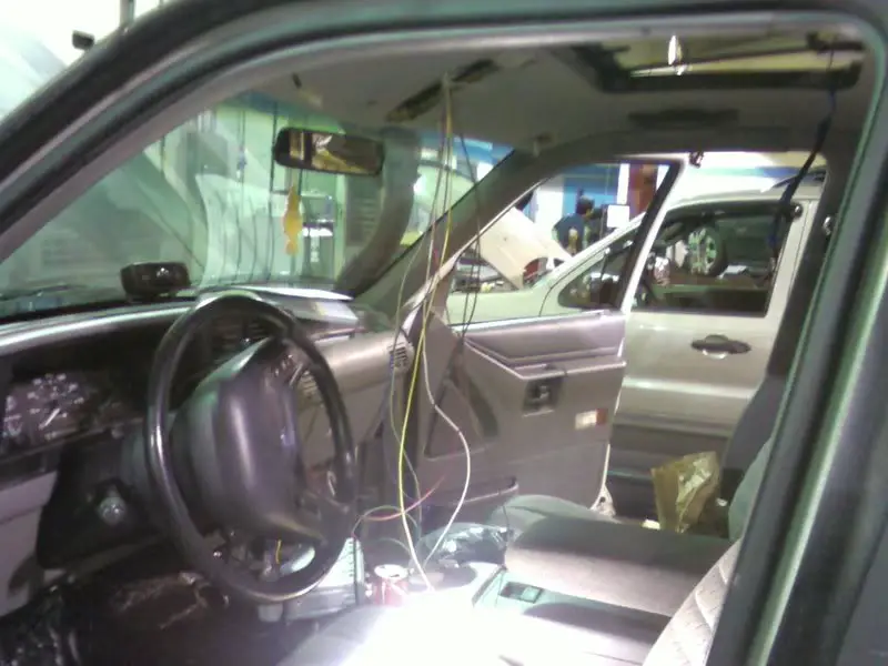

Well aside form the fact that everything on the console side of the conector is wired in black that wasnt anywhere near as bad as people say it is. took a lil over 4 hours to get everything run and all zip tied up pretty like, but i got everything in properly. i did skip on the dimmer though as i never dim the lights from full bright anyway.
was one hell of a tangle of wires comin through that hole though
oh and that stuff stickin out from the corners is ductape. this area of the headliner was already in bad shape and i dint help it much, so i trimed the hole out in it.

HAHAHAHA! (probably still won't help him stay out of cornfields though) :D Looks good, Jay. So is the temp sensor built into the unit or is it external? I never figured that part out...
now i have 2 compasses in the damn thing and i still dont know where the hell i am... ever
temp sensor is external, the concole holds the computer and everything in it, but a 2 wire sensor needs to be run outside the vehicle, in my case to just outbord of the inside of the grill on the left hand side.

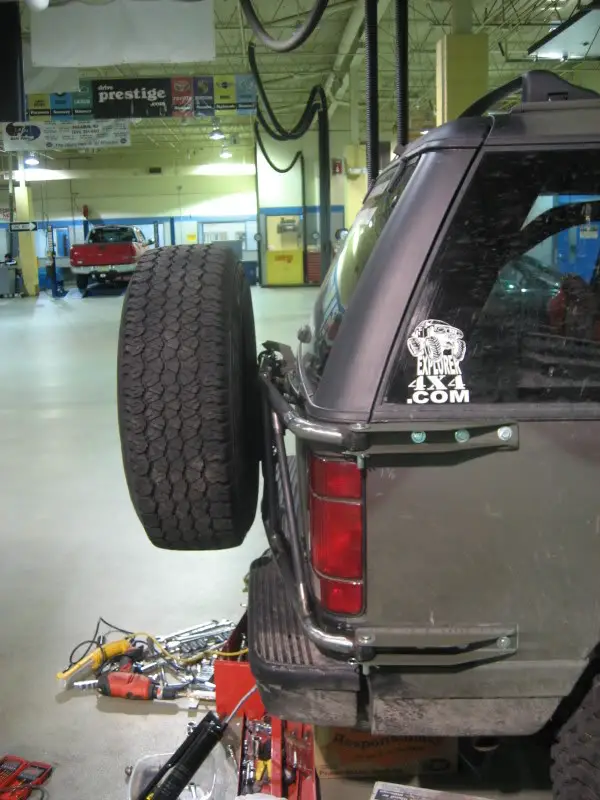

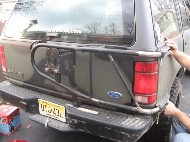

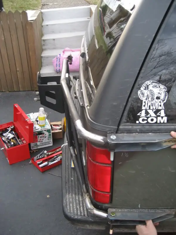

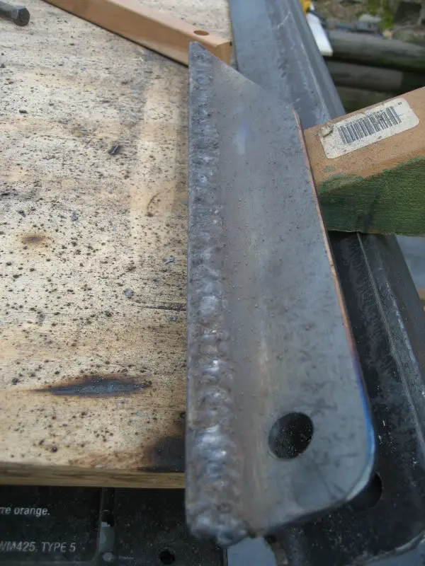

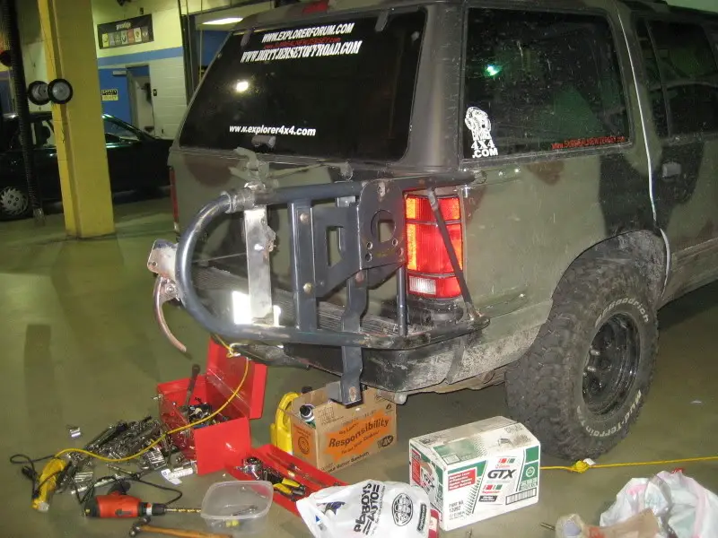

It took a bit of bending, and cutting and welding but i finally got this thing so that itll sit about where i want it to. Didnt have enough time to finish it up today, but most of the hard stuff is done
oh and did i mention SNJ can weld? :D
Turned out great NJ -- fits the paint scheme ;)
thats awesome ... great idea! Looks great!.. is it pretty sturdy?
Heh, thx iz

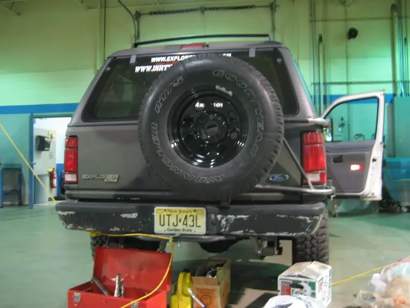

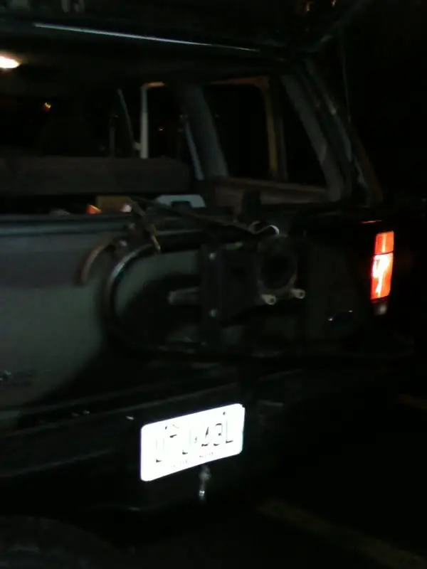

actually it is, i had myself and a buddy of mine hanging off of it both open and closed last night with the tire on it, and there was a minimal amount of deflection. Between the 2 of us weve got to be breaking the 400 pound mark. All of the brackets have sandwich plates on the inside of the sheet metal, wich definitely helps. I was a little woried all through out the build process because of how manu people have said its too much weight for the truck, but it seems to be takin it like a champ
theres atleast eaqual size or larger mounts on the inside as well. unfortuneately the top one was a litle tricky to get a plate in as the d pillar is in the way, so it has one mount infront of the pillar and one inside the pillar.
the top mount has almost no deflection, and the bottom just has a hinto of it from the lower pivot binding just a touch.
the tail gate latch deflects a little as the carier goes in and out of its grove, but dosnt once its latched in, so i think its gonna be ok
