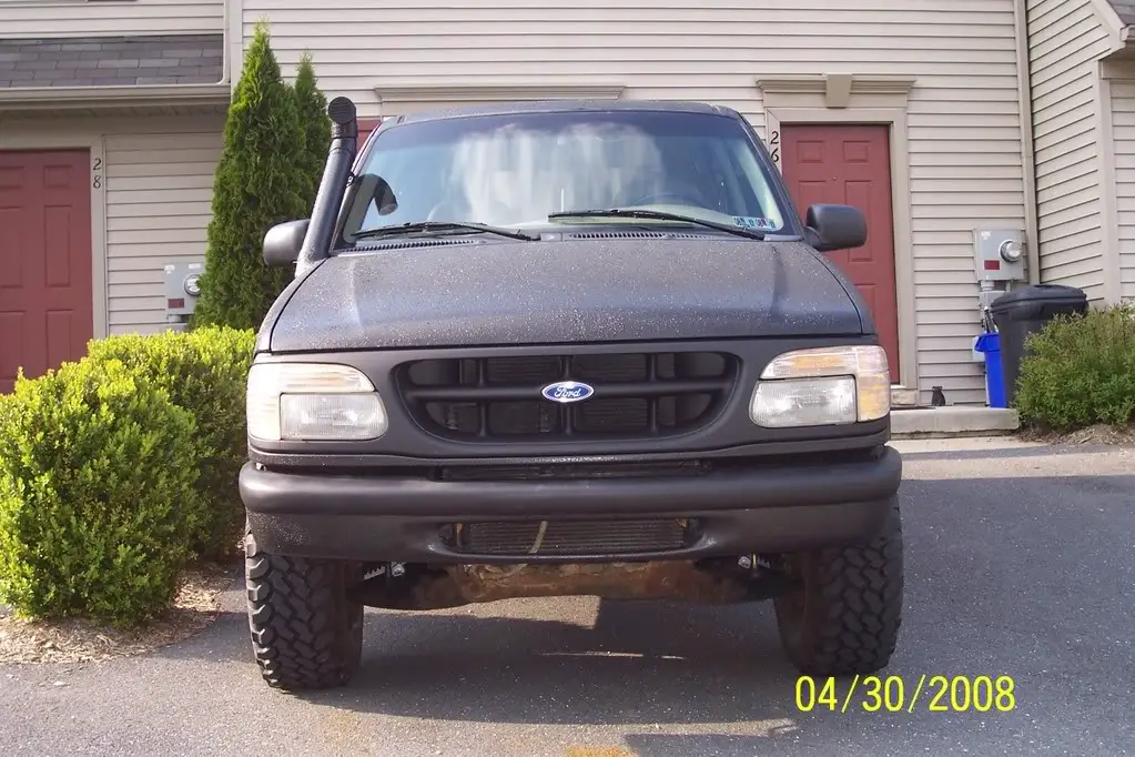

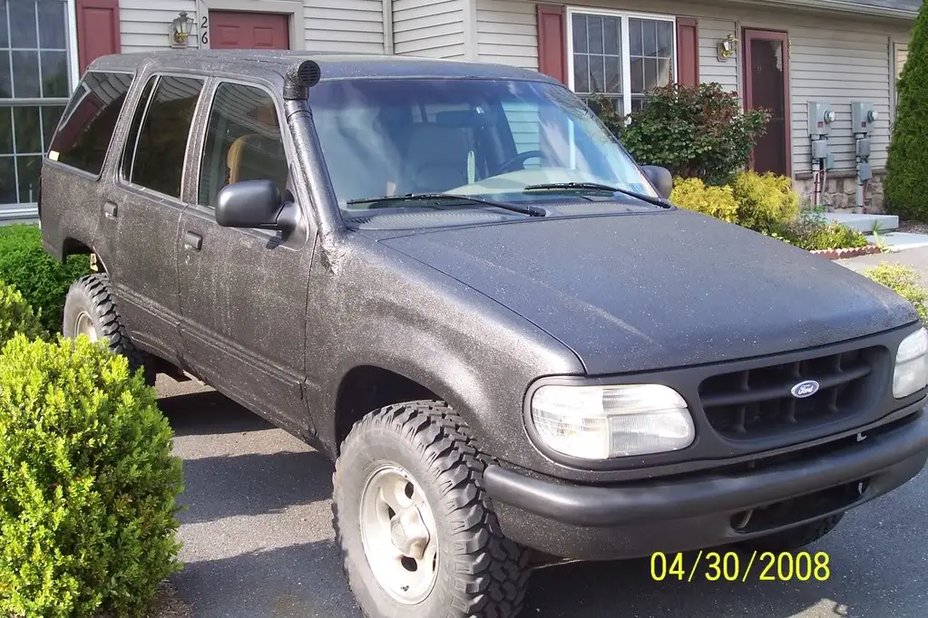

here is my top 3 inch top to bottom
it is not arb but it grows on you after awile and the hole project cost about 40 dollars:D

97Ford how does that snorkel top design do in terms of keeping water out? I think it looks pretty damn good for a $40 dollar build.

keeps out water very well I also have it triple filtered
