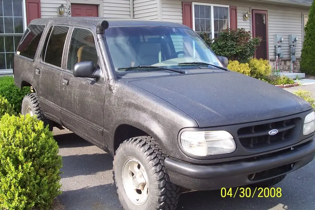

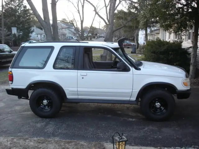

I custom made mine with pvc piping and bent it to flow with the a-pillar
make your own easy cost about 40 dollars at lowes worst part is getting the fender lined up going back on
