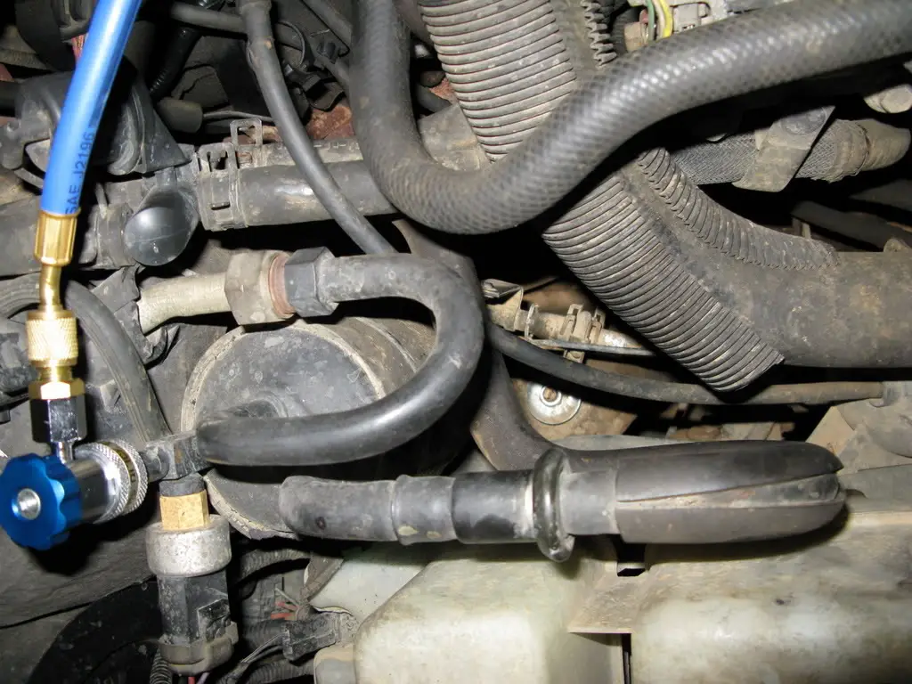

In between chasin problems on the gf's car I have been workin on the A/C system. But I've ran into a issue. I cant get the Nut off the accumulator.
The nut in the left side of this pic.
Not my pic borrowed from KPT
First I didn't have a wrench big enough so I got a 2$ 1'' wrench and ground it to 1-1/8". I can't get that darn thing to budge. I had the gf hold the pliers on the accumulator side while I pulled with all my might on it. It just won't budge I've soaked it in PB blaster for a day or 2 and nothing.
I've got to get this off as my dad is houndin me to get the AC fixed since he decided to pay for the parts and the recharge. So unless someone has a trick to get it off I'll be callin local shops to see what they'll charge to take the accumulator off. I just hate takin my truck to a shop though.
You are talking about the evaporator to drier connection yes? The black part is the drier, and its "nut" on the end shouldn't turn, that should be one piece.
The larger aluminum nut of the condenser will turn, that's what you want to loosen. Hold the black "nut" still while pushing on the other tool towards the driver's side. It's a right hand thread.

Ya I knew which one to turn...I just can't get it to turn.
Started a Thread on it.
Cool, just making sure. The evaporator side, the pipe etc is fragile, so don't pull in a way which twists or bends the aluminum piping.
Ideally you want the two wrenches on each nut in such a way that they are close together. If you can put them on so that you can almost put your hands around both at the same time, squeezing the handles together, that will protect the lines the most. If you can use the wrenches that way, it also gives you the strength of both of your hands in the same place. You might have to buy a whole wrench set to get the right two sizes.

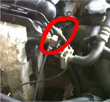

And now the really puzzling/maybe simple one. Now my gauge use to ride right on the line for cold and I figured it was just the sensor but with the new sensor it rides a bit below the N in Normal. Now I know 180 isn't stock thermostat temp(think stock is 195) so my question is... would 15degrees make it ride at that spot or do I have another issue to track down??

The 180 should make it show a little lower on the gauge, near the "NO" area is good. The only thing to wonder about is heat in the Winter. I've had a 180 in two of my vehicles for ages, plenty of heat. I'm going to a 160 in my next engines, but you have to reprogram the PCM to still go into closed loop, at a lower temp.

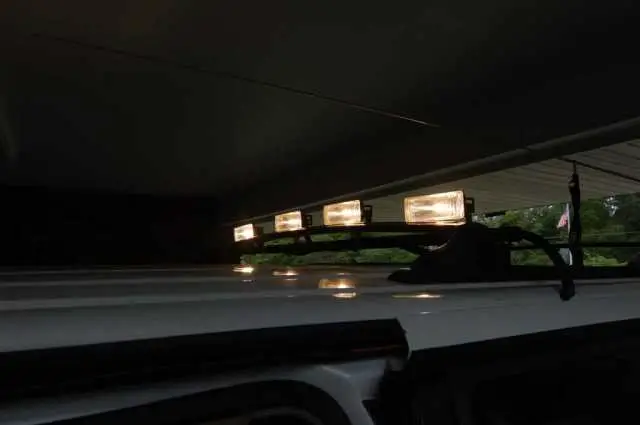

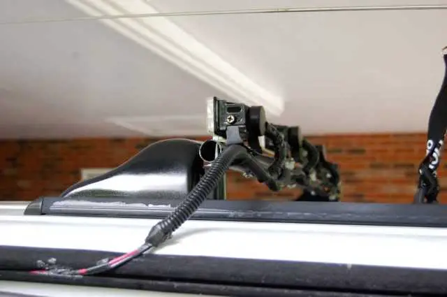

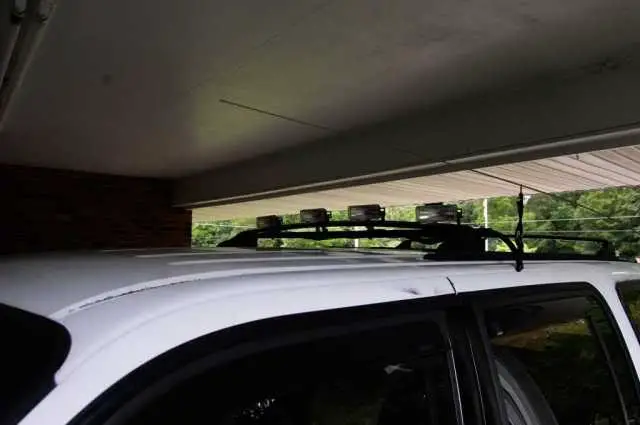

Been workin on a project for the Explorer for a while. Bout a month back my Girlfriend picked me up 2 sets of driving lights from Wally World. So I decided I'd make a $10 light bar and mount them on the roof.
And here is what it looks like...
I got some nylon caps to fill the ends they were just being painted when I took the pics. Painted them orange for a pop of color.
Pretty good light output for 10$ lights.
Routed the wires through the felt at top of door frame then through fender to under hood.

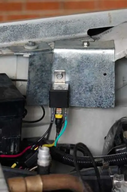

Fabbed a Relay board to hold the relay plus future ones.
And wraped all wires in split loom for a stock look (need a little more to finish it)

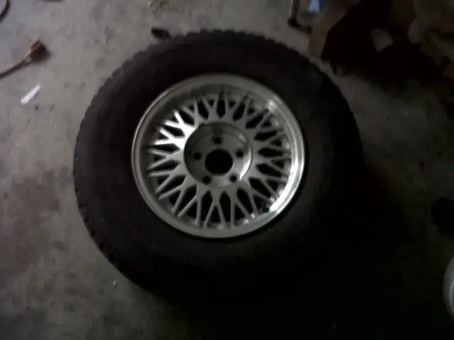

Picked this up a couple days ago for $20. Tire's no good but doesn't matter cause I'm gonna get my spare 31" thats in the shed mounted on it for now and hopefully by end of summer a matching 31" so I have 5 tires to rotate through so they will last longer.
