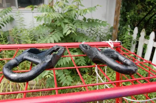

Tow Hooks
Today I cleaned up the rear tow hook and layed some rust stoppin paint as well as some under coating on it and the front tow hooks.
Only pic I have(just in rust stoppin paint then)

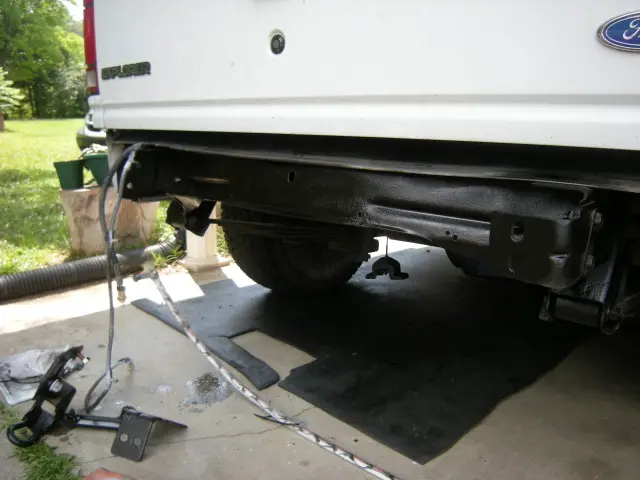

I also cleaned off the rear inder carrage a little and laid down some rust stopping pain and some undercoating.
Rust proofing paint only.
For the next couple days I'll be ridin around with a rear that looks like this.

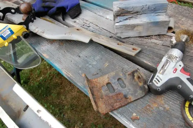

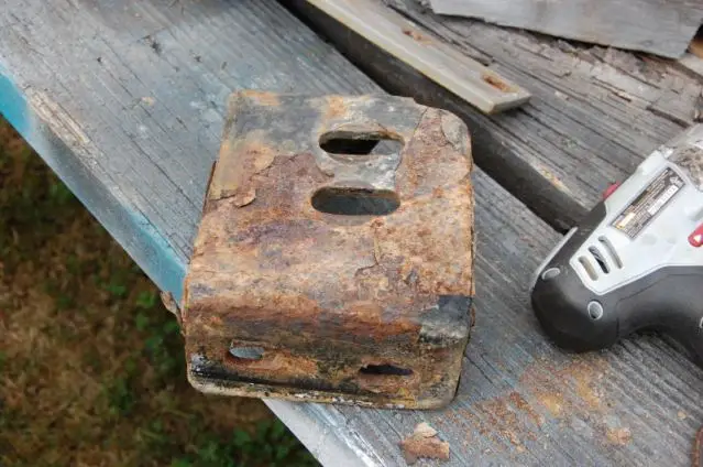

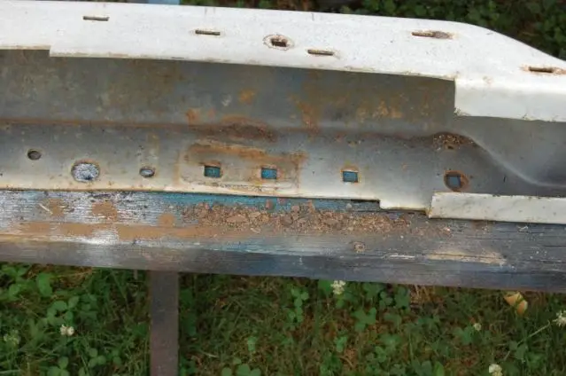

Well I cleaned up the bumper brackets today since the only ones I could find new were at LMC Truck and they wanted 44$ a side.
Here's a couple before pics to show all the rust that was on them.
Here's one all cleaned up and painted with rust control paint.
Both sides are done now and coated with rubber under coat.
While I had the grinder out I cleaned up the step ball plate and through rust proofing paint on it too.

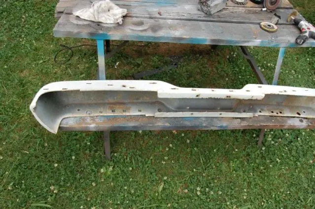

Here's a couple shots of the bumper all toe apart.
All the dirt on the wood came from where the brackets were after I took a wire wheel on the drill to it.
The inside of the bumper is going to get the same treatment as the brackets. The outside will also get all the surface rust taken off and rust proofing paint on the top and most of the bottom.

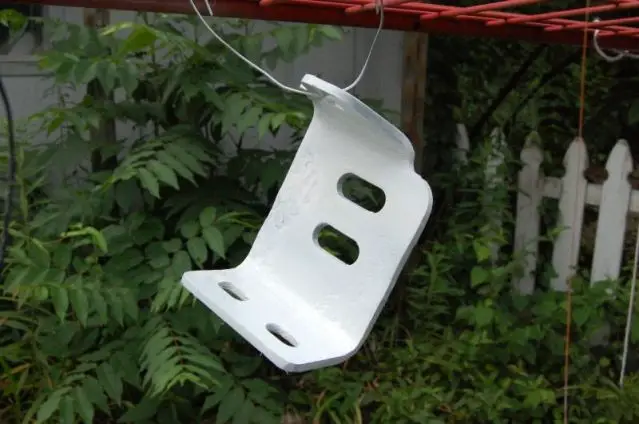

Well the bumper is all cleanned of rust and sprayed on the inside with rust prevention paint and 2 layers of under coating.
I picked up some cans of Duplicolor Oxford White pain yesterday and prepped the bumper for paint before I left for work this morn. I was plannin on painting it now but at almost the exact time I was gettin up to go outside and pain the sky's opened up and let out a massive downpour. So that's on hold till tomorrow. I'm about to head to Tractor Supply to get some new bolts so I don't have to spend hours cleaning the old ones.

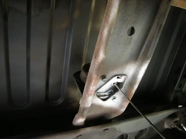

Almost ready to put the bumper back together and on the truck I'm just waiting on all the paint to finish drying so I can assemble and mount it.

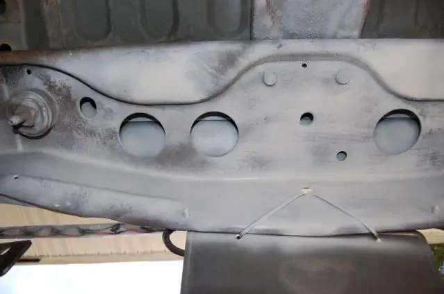

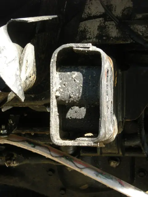

Here's the rear cross-member coated with some undercoating after I removed the rust.

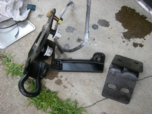

Tow hook and bracket ready to go on.
Just a note for anyone who might try this in the future. You need to remove the bolts from the bracket and put them in the tow hook holes so that it can be bolted up with the tow hook then bracket then frame rail. The bolts are press fitted in the bumper bracket so it'll take a hammer to remove them then you can press them back in as you tighten the nuts own on the frame rail. (I'll take pics since I'm sure this is just gibberish to everyone but me.)

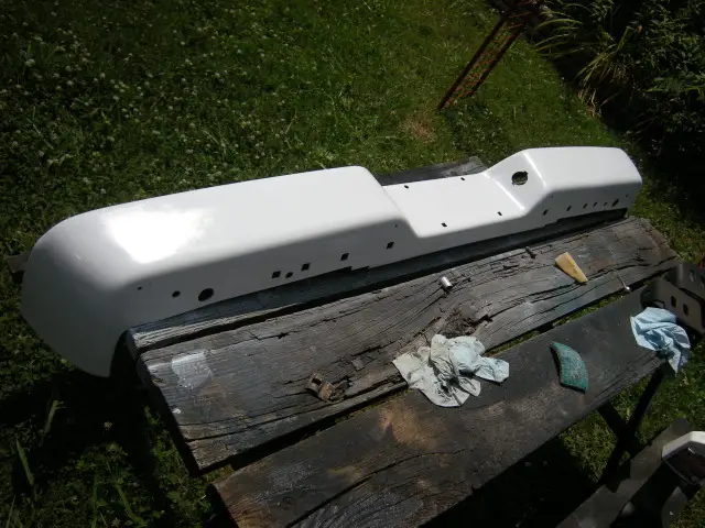

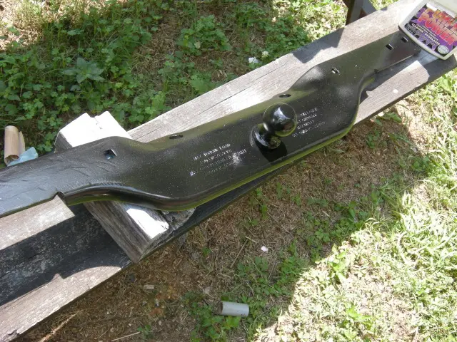

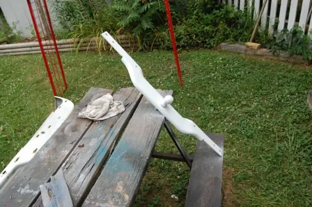

Here's the bumper all painted and cleared.

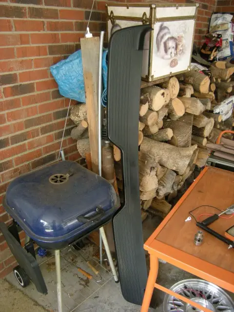

And I'm not sure if I mentioned before but I'm changing the gray pieces to black so here's the step ball part and the top step all painted up.

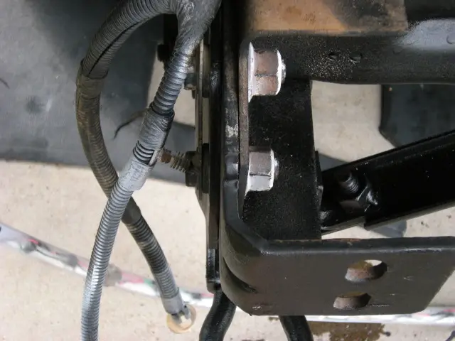

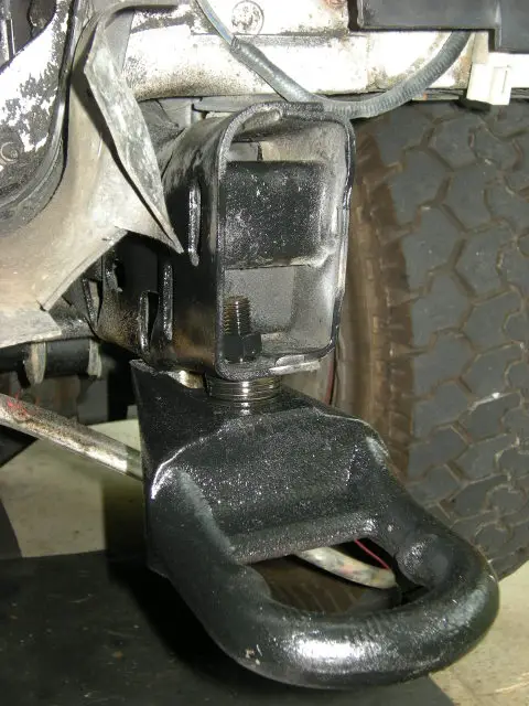

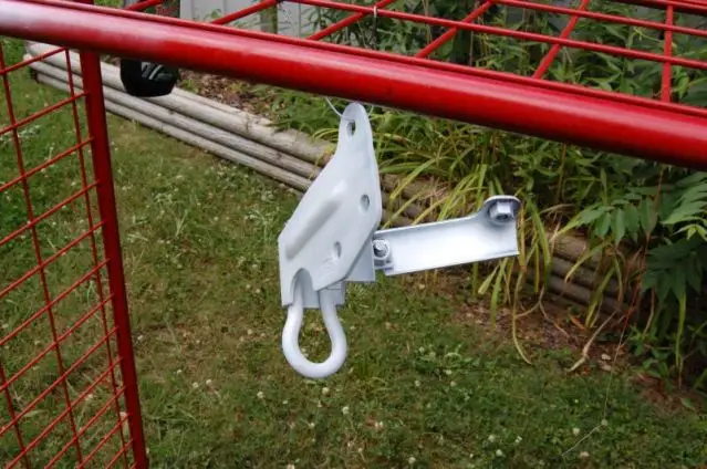

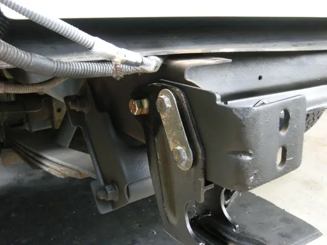

Here's a couple pics of how the rear toe hook mounts.
Above shot.
Shot from the pass side.
I don;t have a drill bit large enough to make a hole for the support arm bolt so I just drilled a 3/8 inch hole (largest bit I have) and put a grade 8 bolt nut and lock washer through it. I think it should be plenty strong enough.
Driver side shot.
The 3 hole was already on the frame rail so all that was needed was a 1/2 inch grade 8 bolt, nut and washer.
It is solid as a rock and I'm very happy with it.

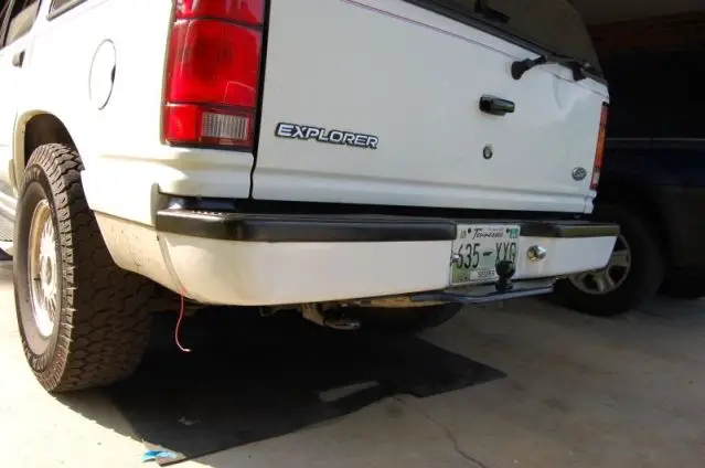

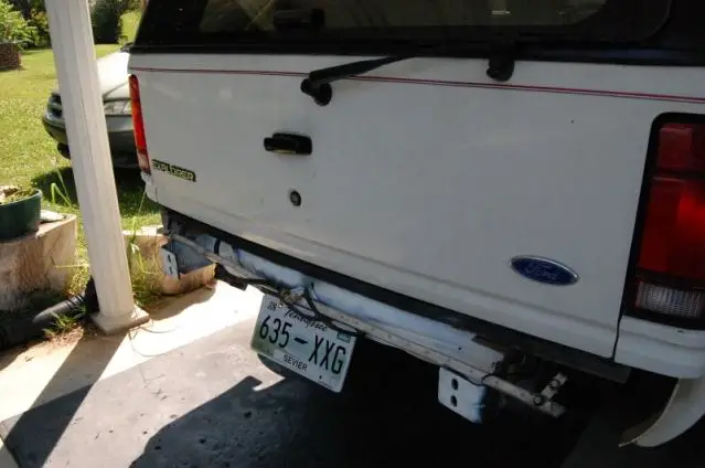

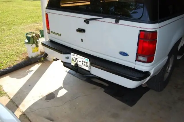

Been a little behind on updating this. I got the rear bumper installed on Sunday. It's not perfectly centered, it's off to the driver side just a touch, but it good enough for me.
Here's a few completed pics.
Ignore the hanging wire it's for my under body light's. I had to remove the rear light as it interferes with the tow hook. I'll get it back on there one of these days though.

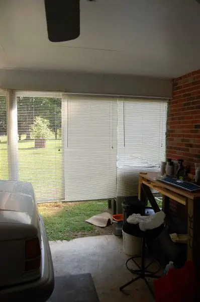

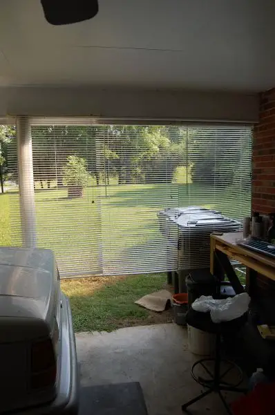

Oh ya one more thing mom was changing some blinds out in the house and had 3 perfectly good ones so I decide to put them to use. I installed them outside on the carport to keep the sun out bit still allow light in.
It makes it much cooler I just have to add some weight to the bottom of the blinds so they don't blow so much in the wind.

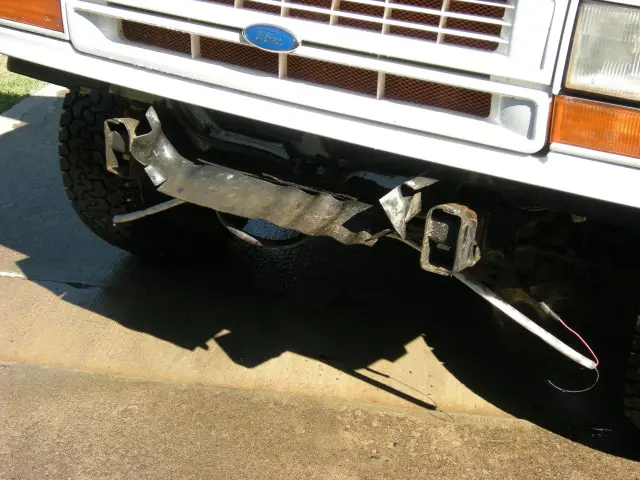

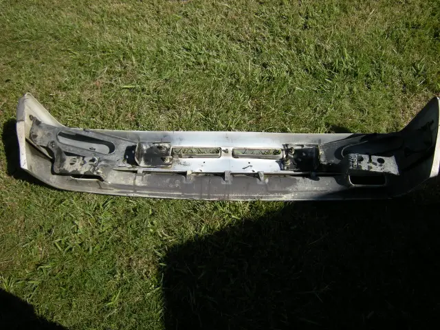

Well I got the front bumper off. Took all of about 15min much faster than the rear.
Not much rust on it so I'm just gonna scuff and paint it.
Couple shots of it.

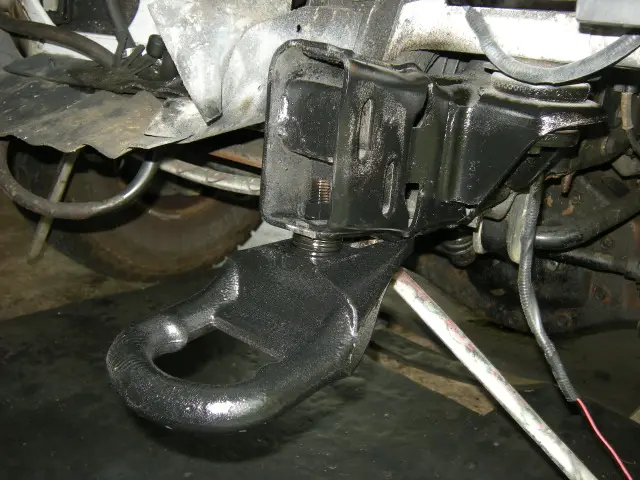

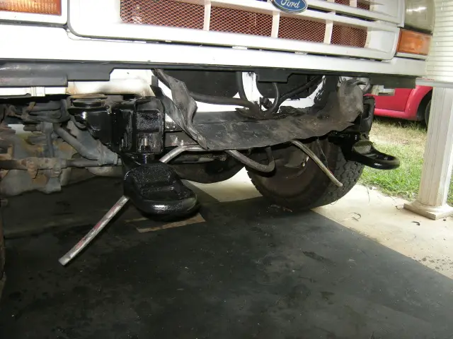

And once I got the bumper off Ford made the decision easy for me on how to bolt the tow hooks on.
Didn't expect it to have those bolt sleeves in it so I'll be using grade8 hardware and drilling 2 new holes. Everything has been washed and the frame has been de-greased so tomorrow I plan on starting rust removal and painting.
Well I got one of the hooks mounted and the frame rails cleaned up and painted besides that it's been ridiculously hot here (103 Today and yesterday) so not much work has been gettin done. To add to that I recieved a new distraction that has had my attention for a while. My uncle finally brought my the Remington Nylon 66 .22 Rifle he had been holding for my day.
It was given to my dad by his father who died when he was 6. I've been researching it and learnin about it as I know little about guns. SO far I've found out it was made before 1968 and I've learned to disassemble it to clean it. I've only shot it once since we live in the city limits. I" plan to go to a range next week sometime.
I've also got a 410 shotgun that my dad's uncle has been keeping that he's gonna get next time he goes to Virginia.
Alright I suffered through the heat and now both the tow hooks are mounted.
Drillin half inch holes throught the double walled frame rails was no fun. For the back holes I had to lay under the car and have razor sharp shards of metal flung on me. But it'll be worth it the first time I get stuck and use them.

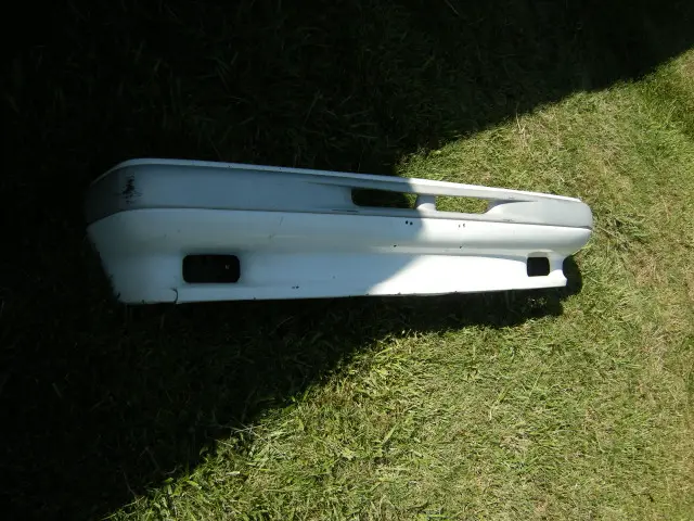

Bumper's all marked for cutting so tomorrow I plan to cut the holes and sand down the bumper and get it ready for paint.
