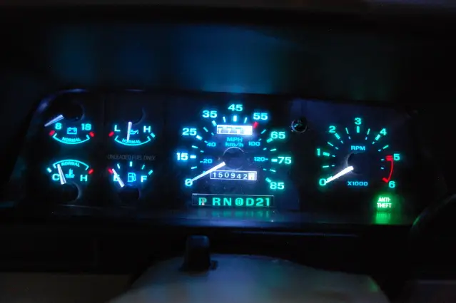

Well I've been doing a little work on her I received my SMD LED's a few days ago and yesterday I put them in the gauge cluster. It's a lot brighter and made the gauges a blue color which matches most of my other lights. I couldn't figure out how to disconnect the speedo cable from the cluster so I just disconnected it from the T-case and feed the slack through tell I could get to the bulbs.

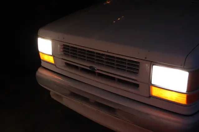

I also got some headlight bulbs in the mail they are very white but put out horrible light. I will keep them as spares and run them when cruising during the rod runs around here.

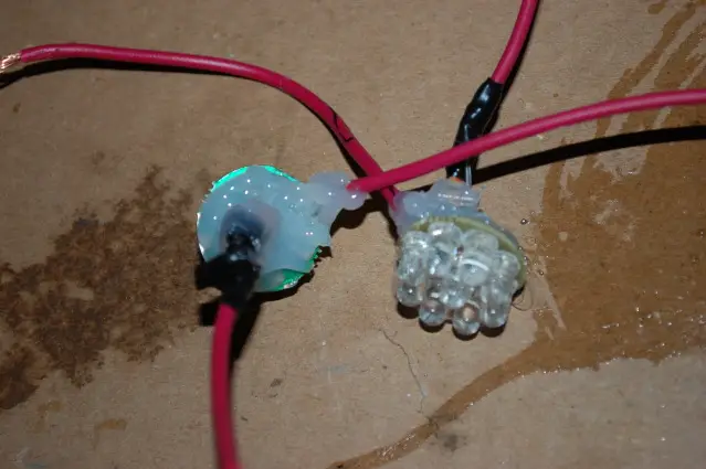

I am also in the process of converting the interior to LED's also. So far I have turned 2 9 LED flashlights into a hatch light.
Started with 2 of these.
Soldered on 33-Ohm Resistors and + and - wires. Then insulated everything with hot glue.
Then I ground down 10 of the tips and hooked up to 9V battery to test.
And this is what I have.
Just need to get some clear fingernail polish to refinish the tips and then wire them in. I'll post pics once there done.
EDIT: THIS DID NOT WORK DO NOT FOLLOW I WILL FIND A BETTER WAY AND POST IT.

For headlight bulbs, I've rarely had much success with the "hyper-white" or "blue bulb" varieties. The light they put out, though very "hot" as measured by a ligt meter is not adequate in candle power for vehicle lighting. Best I've found without going to HID (which have their own problems for vehicles due to the long warm up times) are Sylvania Ultra-Silvarstars. They are great lights, but pricey.
