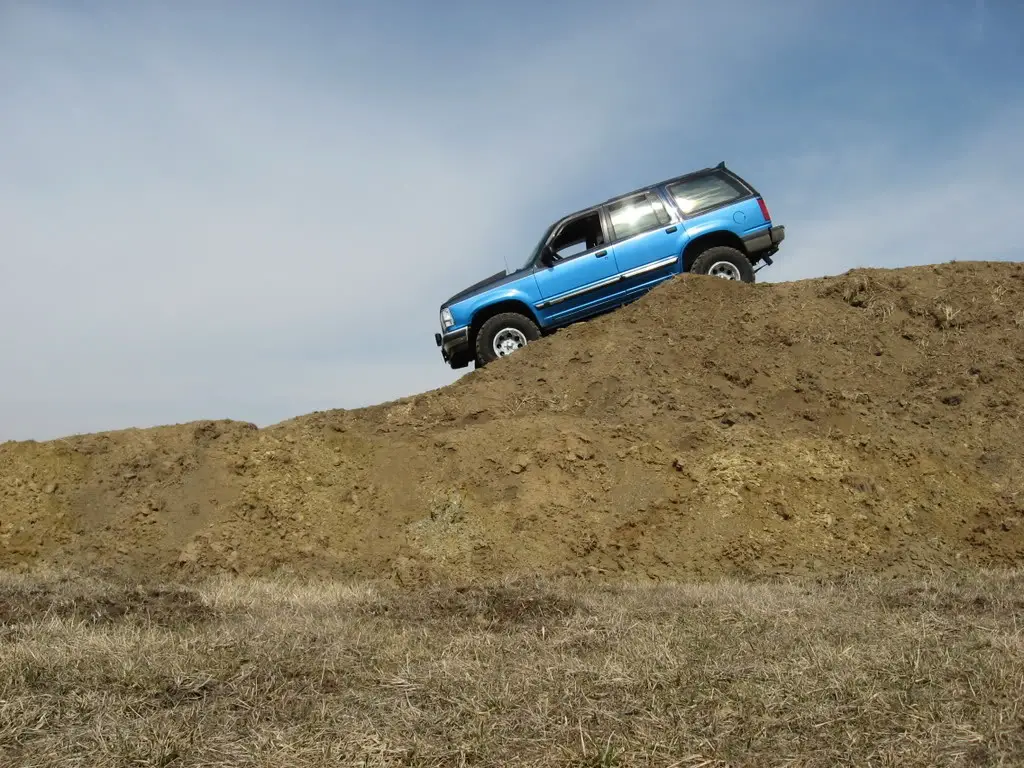

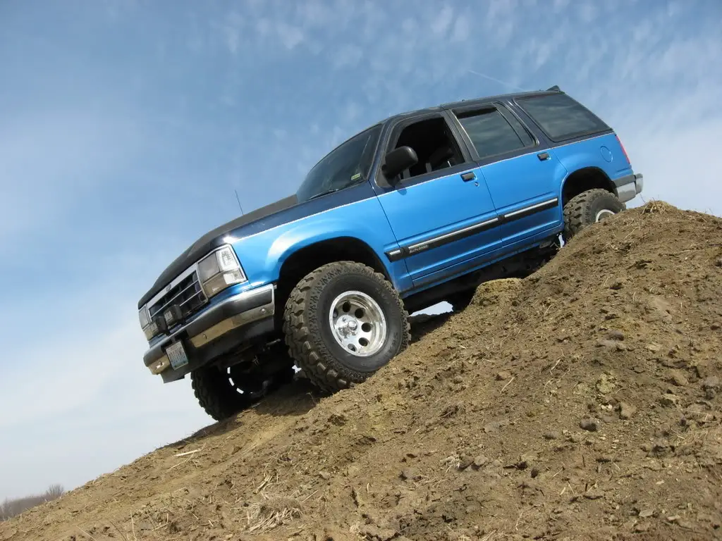

but it was fun ! :thumbsup: :D ... any way, whats the best way to change them...
pic of fun...:p:
not to be a dick but looks like u climbed a dirt hill....i think my 2wd dodge could make it up there.

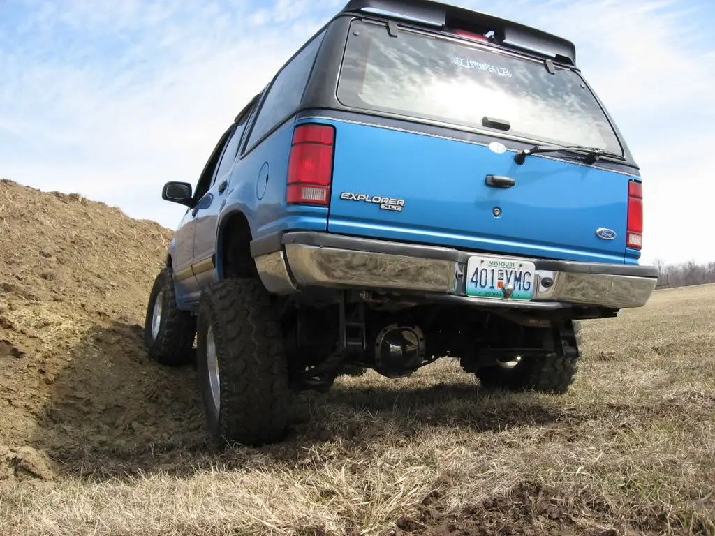

hes only 2wd im bettin it was the one on the rear diff.
yes it is the back one...

its steeper than it looks, and when i got to the top at about 15 mph the front wheels came off the ground ! lol. and holding it there for the pics didnt do it any good eather..but ya id say they was on there way out anyways...
