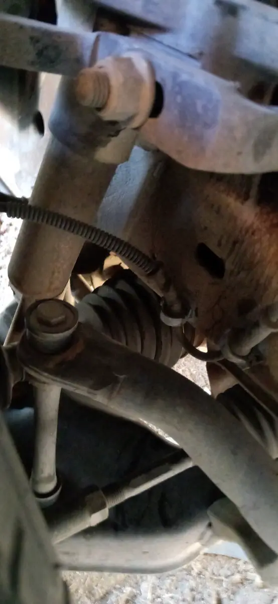

Being a CA desert truck, it probably looks showroom new on the bottom. The only issues with these trucks are rust related. I would love a pic of the shackles!

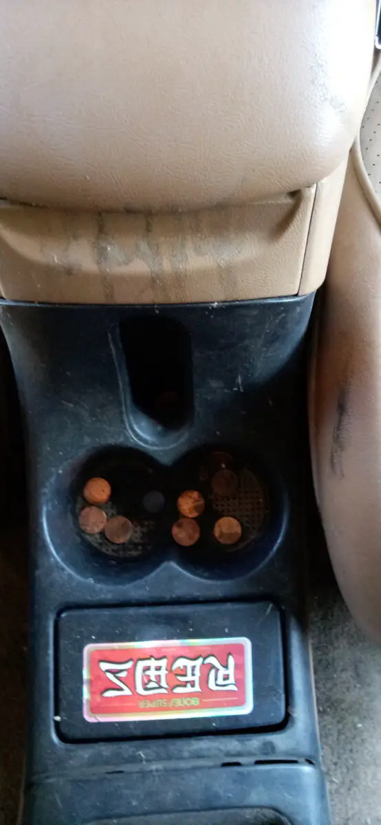

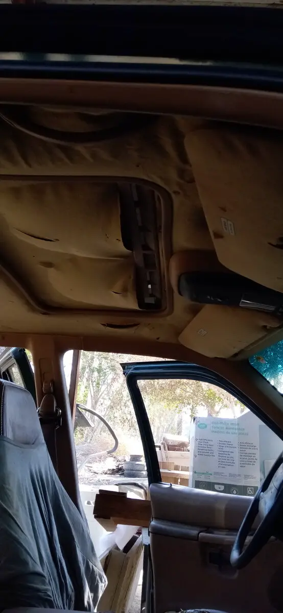

Delete/ edit the "triples" of pics from your last post.... I'm dizzy now :)

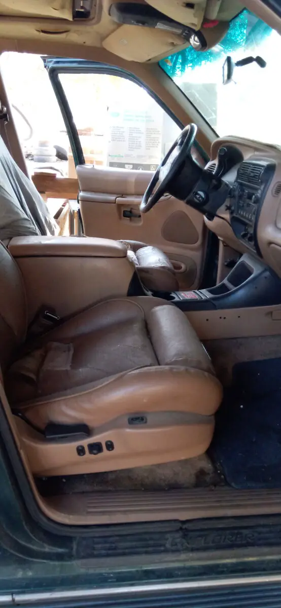

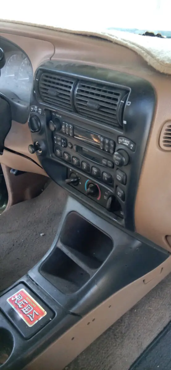

It's an off roader...who cares about interior.... get seat covers and you can get new center console faux leather replacement cover for $11 on Ebay...will look new again. > Vinyl Skin Console Armrest Cover for 95-01 Ford Explorer Beige | eBay
AND YOU HAVE A MOON ROOF! SCORE......that thing has potential written all over it....

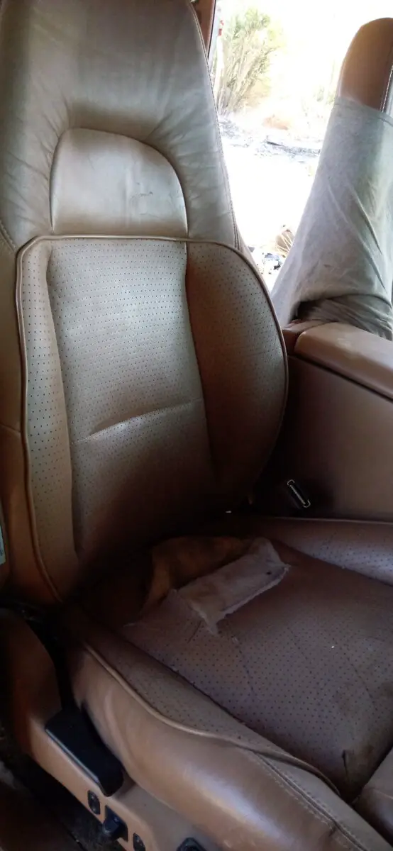

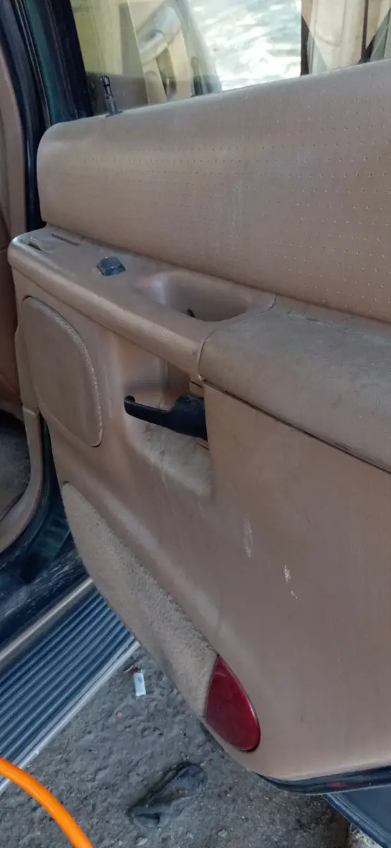

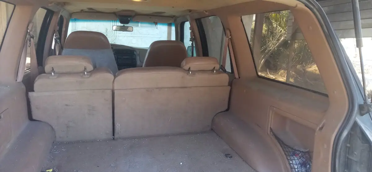

Needs some TLC. Probably could get interior stuff cheap in a pick and pull. You don't know how fortunate you are not to have to deal with rust and rot. Nothing some diluted super clean and detailer can't take care of in there!

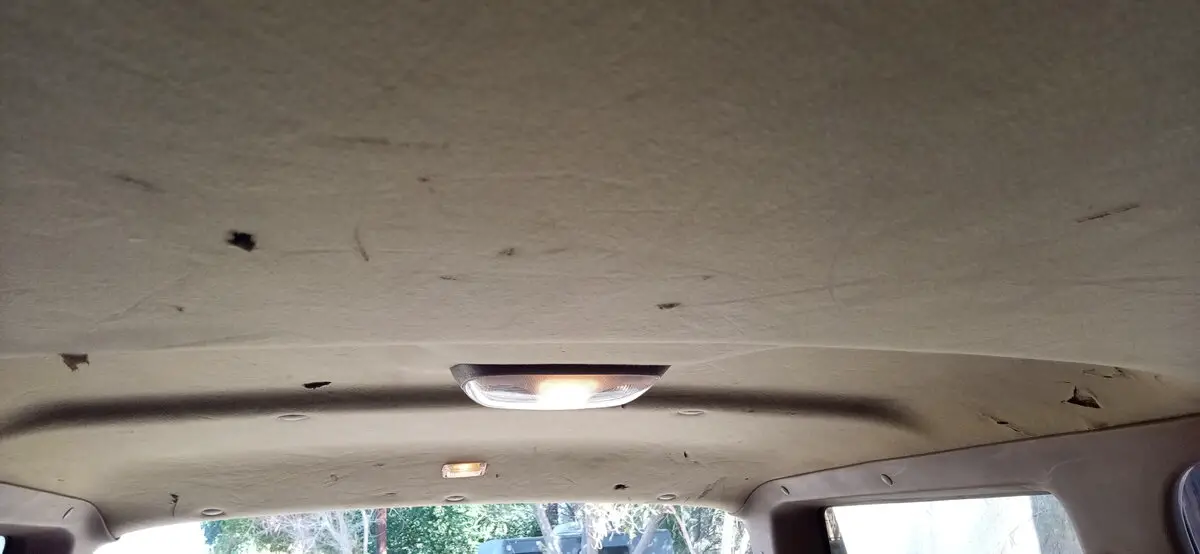

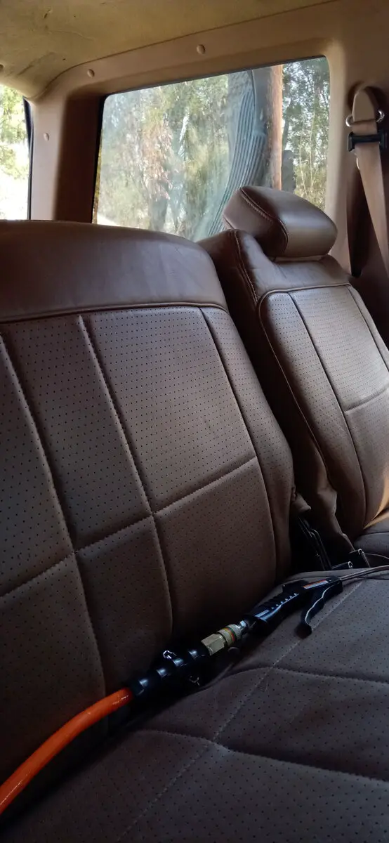

Yeah, I got something that fit, stapled it in you wouldn't know it was every replaced. I've never seen seats so bad though. That is probably from the dry desert heat. You have to condition leather there. May be a case for cheap seat covers.

Yeah interior is a bit rough, but really only needs a couple good used front seats, a headliner, a good cleaning, and few other small bits and pieces. Looks all original underneath in a good way. Not sure about the transmission light, I am not an expert especially on automatics.
