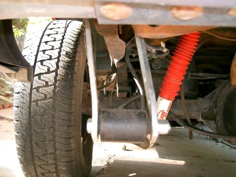

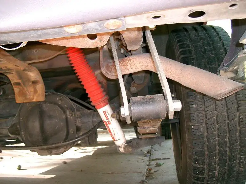

410- I went under the truck briefly and found this....both of the shackles are bent to the right, am i screwed? or can i just replace the shackles again for an easy fix? here are the pics...
yeah those shackles definatly dont look right,
if you can, put the frame on stands, thne put the axle on a jack. remove the shackles and lower the axle housing on the jack... then take a pic so maybe we can tell if the axle is bent real bad or not... Cuz from those pics the axle housing looks alright. those shackles on the otherhand look like they need some replacement haha
ouch. See how valauble a visual inspection is!
I would replace the shackles, they are not too expensive.
However this would not cause the wheel itself to wobble, just cause the axle to be located wrong.
It is highly likely you bent the leaf springs as well, the axleshaft, or the housing itself.
You could get all these parts from a donor all at once :)
go measure your tire to fender clearance, your axle is not centered under your truck anymore.
Also those look like some cheap ass shackles, not surprised they bent, but this may be a good thing, meaning you bent the cheap shackles and saved everything else.
A wobbly wheel however is most likely a bent shaft, or housing. Do you see any gear lube leaking out from behind the suspect wheel? A out of round axle shaft will usually create a leak at the wheel bearing seal....
Ive never seen shackles like that, with just the two sides (no bar going across to the other side)... Hope it is pretty cheap to repair. As 410 said theres lots of donors that can help you out:D

Indeed it looks like the shackles are toast. I'd recommend the warrior shackles.... those look too flimsy for my liking.
Again, the axle shaft is probably toast. The procedure above is all it takes (in addition to removing the brake caliper and rotor). Any halfway proficient shade-tree mechanic should be able to handle it, no problem.
